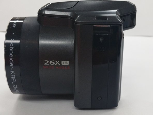

    • Open the battery cover and remove the AA batteries from the camera if any are inserted.

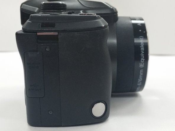

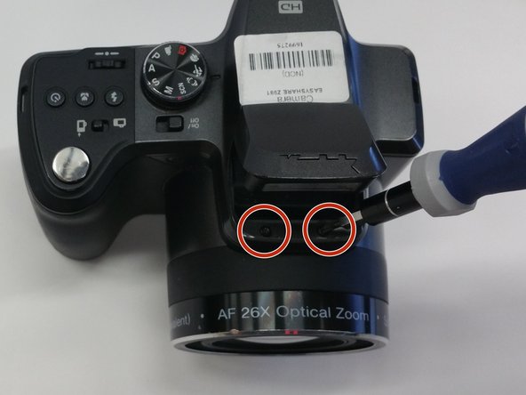

    • Remove all screws on the outside of the camera with a 00 Phillips-Head screwdriver
    • Eight (8) 3mm screws on the lower portion of the camera
    • Four (4) screws on the bottom of the camera
    • Four (4) screws inside the battery cover
  3. Kodak Easyshare Z981 Top Shutter Button Replacement: crwdns2935265:03crwdnd2935265:01crwdnd2935265:03crwdne2935265:0 Kodak Easyshare Z981 Top Shutter Button Replacement: crwdns2935265:03crwdnd2935265:02crwdnd2935265:03crwdne2935265:0 Kodak Easyshare Z981 Top Shutter Button Replacement: crwdns2935265:03crwdnd2935265:03crwdnd2935265:03crwdne2935265:0
    • Detach the bottom part of the camera by removing four (4) 3mm screws
    • Two (2) screws are located in the left side of the device
    • Two (2) screws are locatecd in the right side of the device

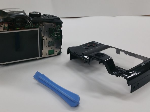

  4. Kodak Easyshare Z981 Top Shutter Button Replacement: crwdns2935265:04crwdnd2935265:01crwdnd2935265:02crwdne2935265:0 Kodak Easyshare Z981 Top Shutter Button Replacement: crwdns2935265:04crwdnd2935265:02crwdnd2935265:02crwdne2935265:0
    • Use the Plastic Opening Tool to put light pressure and remove the back cover of the camera
    • Be gentle when removing the back cover

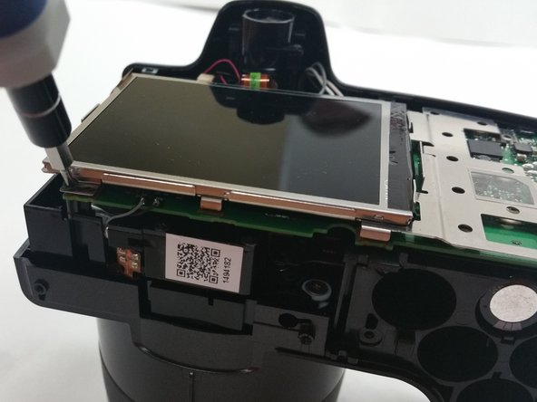

    • Unscrew the four (4) 3mm screws to remove the screen from the circuit board
    • Use Tweezers to delicately detach the ribbon cable
    • Carefully remove the screen brace from the circuit board

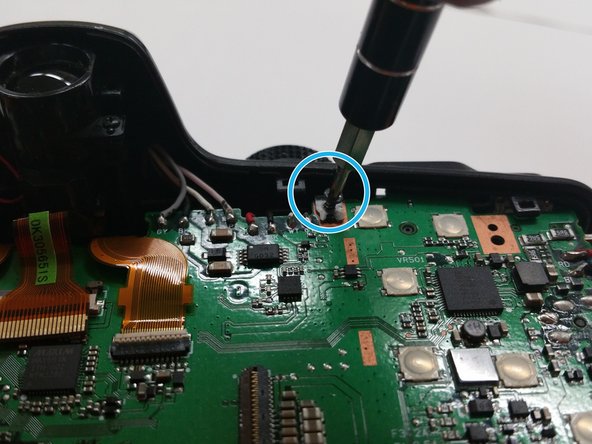

  6. Kodak Easyshare Z981 Top Shutter Button Replacement: crwdns2935265:06crwdnd2935265:01crwdnd2935265:03crwdne2935265:0 Kodak Easyshare Z981 Top Shutter Button Replacement: crwdns2935265:06crwdnd2935265:02crwdnd2935265:03crwdne2935265:0 Kodak Easyshare Z981 Top Shutter Button Replacement: crwdns2935265:06crwdnd2935265:03crwdnd2935265:03crwdne2935265:0
    • Remove the two (2) 3mm screws from inside flash compartment
    • Remove one (1) 3mm screw from the circuit board

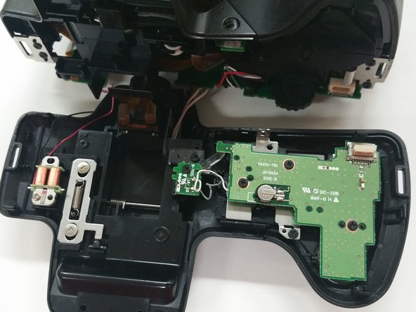

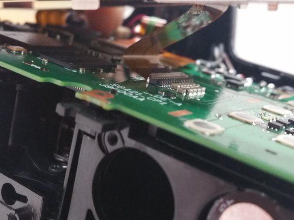

  7. Kodak Easyshare Z981 Top Shutter Button Replacement: crwdns2935265:07crwdnd2935265:01crwdnd2935265:02crwdne2935265:0 Kodak Easyshare Z981 Top Shutter Button Replacement: crwdns2935265:07crwdnd2935265:02crwdnd2935265:02crwdne2935265:0
    • Use the Tweezers to detach the ribbon cable connecter from the circuit board
    • Use the Plastic Opening Tool to gently apply pressure on the top of the camera and remove the upper portion

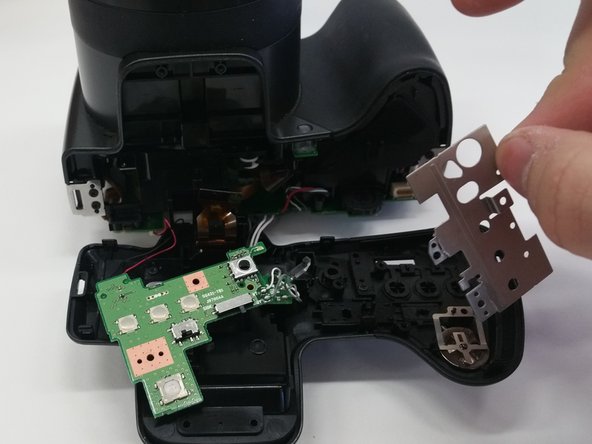

  8. Kodak Easyshare Z981 Top Shutter Button Replacement: crwdns2935265:08crwdnd2935265:01crwdnd2935265:03crwdne2935265:0 Kodak Easyshare Z981 Top Shutter Button Replacement: crwdns2935265:08crwdnd2935265:02crwdnd2935265:03crwdne2935265:0 Kodak Easyshare Z981 Top Shutter Button Replacement: crwdns2935265:08crwdnd2935265:03crwdnd2935265:03crwdne2935265:0

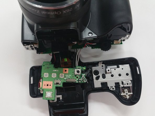

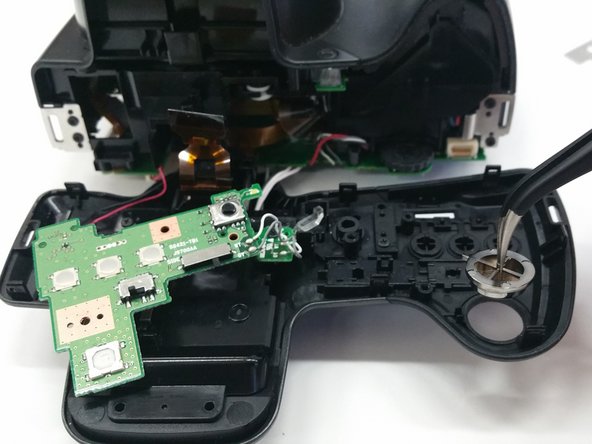

    • Remove the four (4) 3mm screws from the circuit board directly underneath the shutter button and gently move the circuit board aside
    • Lift up the metal clamp
    • Use caution when removing the circuit board to avoid tearing the wires connected

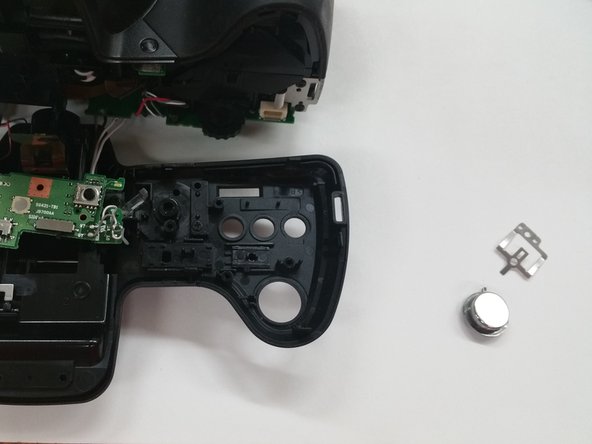

  9. Kodak Easyshare Z981 Top Shutter Button Replacement: crwdns2935265:09crwdnd2935265:01crwdnd2935265:03crwdne2935265:0 Kodak Easyshare Z981 Top Shutter Button Replacement: crwdns2935265:09crwdnd2935265:02crwdnd2935265:03crwdne2935265:0 Kodak Easyshare Z981 Top Shutter Button Replacement: crwdns2935265:09crwdnd2935265:03crwdnd2935265:03crwdne2935265:0
    • Pull the small brace on top of the shutter button
    • Using the Tweezers, gently remove the shutter button
