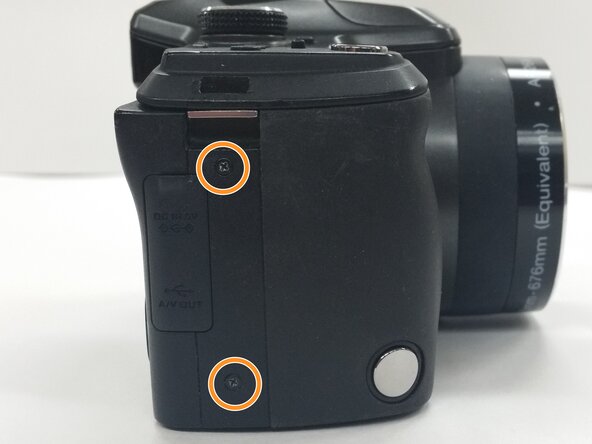

    • Use a 00 Phillips-Head screwdriver to remove screws:
    • Remove the 3 mm screws from the camera
    • Four (4) screws are in the bottom of the device
    • Four (4) screws are inside the battery cover
  3. Kodak Easyshare Z981 LCD Screen Replacement: crwdns2935265:03crwdnd2935265:01crwdnd2935265:01crwdne2935265:0
    • Start from a corner and gently remove the cover.
    • The cover will easily lift off, so not much pressure is required.
    • Make sure to gently remove the bottom cover in order to avoid breaking the plastic.

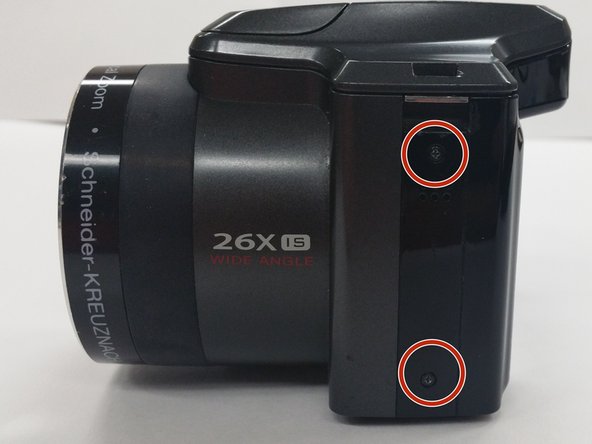

    • Use a Phillips #00 Screwdriver to remove the 4 mm screws from each side of the back cover of the camera.
    • Two (2) screws are located in the left side of the device
    • Two (2) screws are locatecd in the right side of the device

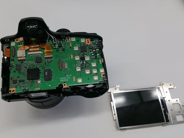

  5. Kodak Easyshare Z981 LCD Screen Replacement: crwdns2935265:05crwdnd2935265:01crwdnd2935265:02crwdne2935265:0 Kodak Easyshare Z981 LCD Screen Replacement: crwdns2935265:05crwdnd2935265:02crwdnd2935265:02crwdne2935265:0

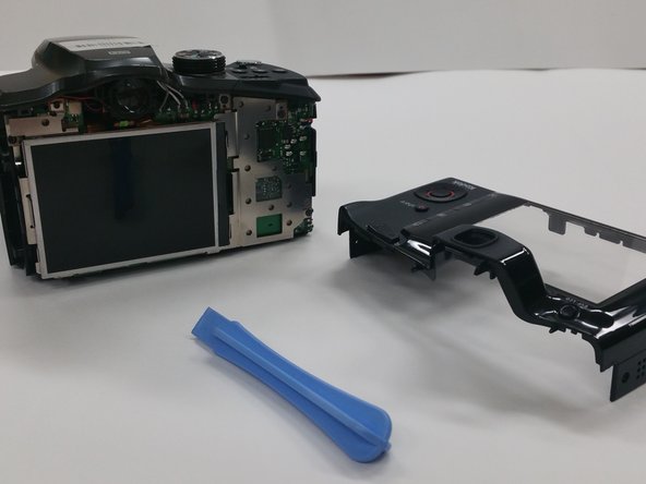

    • Insert the Plastic Opening Tool in to the crevices of back cover and gently apply pressure
    • Be gentle while removing the cover, to avoid cracking the case
  6. Kodak Easyshare Z981 LCD Screen Replacement: crwdns2935265:06crwdnd2935265:01crwdnd2935265:02crwdne2935265:0 Kodak Easyshare Z981 LCD Screen Replacement: crwdns2935265:06crwdnd2935265:02crwdnd2935265:02crwdne2935265:0

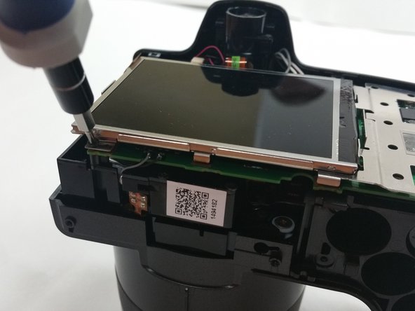

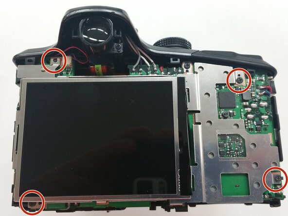

    • Once the back cover is removed locate the four 3mm screws holding the screen and the metal brace to the circuit board

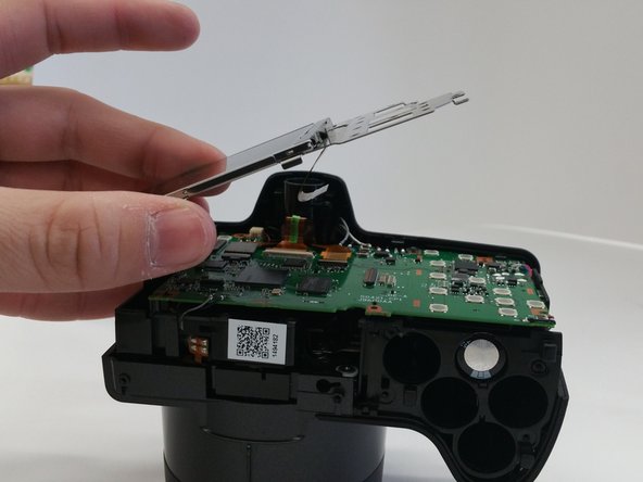

  7. Kodak Easyshare Z981 LCD Screen Replacement: crwdns2935265:07crwdnd2935265:01crwdnd2935265:03crwdne2935265:0 Kodak Easyshare Z981 LCD Screen Replacement: crwdns2935265:07crwdnd2935265:02crwdnd2935265:03crwdne2935265:0 Kodak Easyshare Z981 LCD Screen Replacement: crwdns2935265:07crwdnd2935265:03crwdnd2935265:03crwdne2935265:0

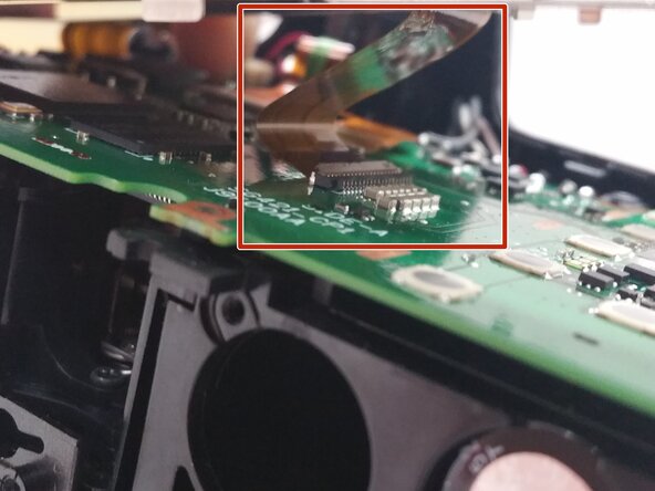

    • Gently lift up the metal brace and use a pair if tweezers to disconnect the ribbon cable connecter
    • Use Tweezers to disconnect the ribbon cable connector.
    • Once disconnected remove the screen brace from the circuit board
    • Use extreme caution when removing the LCD brace pulling the brace may tear the cable
