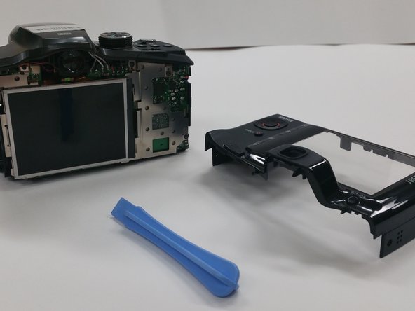

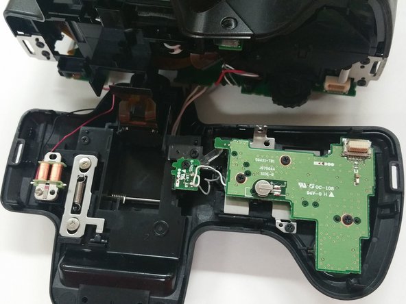

    • Use a Plastic Opening Tool to remove the back of the camera
  5. Kodak Easyshare Z981 Flash Button Replacement: crwdns2935265:05crwdnd2935265:01crwdnd2935265:03crwdne2935265:0 Kodak Easyshare Z981 Flash Button Replacement: crwdns2935265:05crwdnd2935265:02crwdnd2935265:03crwdne2935265:0 Kodak Easyshare Z981 Flash Button Replacement: crwdns2935265:05crwdnd2935265:03crwdnd2935265:03crwdne2935265:0

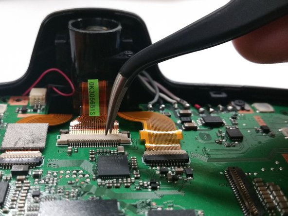

    • Remove the four (4) 3mm screws attaching the LCD screen to the circuit board.
    • Use Tweezers to carefully detach the ribbon cable
    • Use extreme caution on this step, as the ribbon cable is very fragile and can rip very easily.

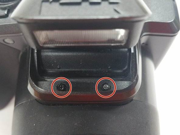

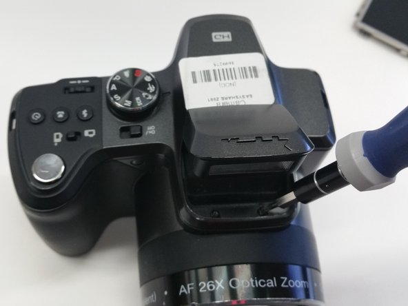

    • Open the flash compartment and remove two (2) 3mm screws.

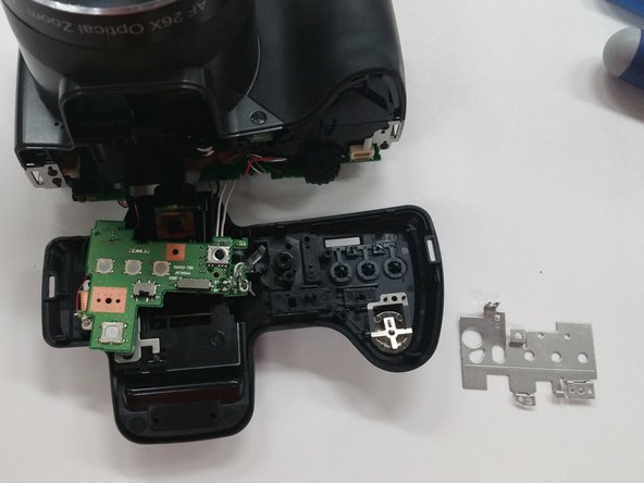

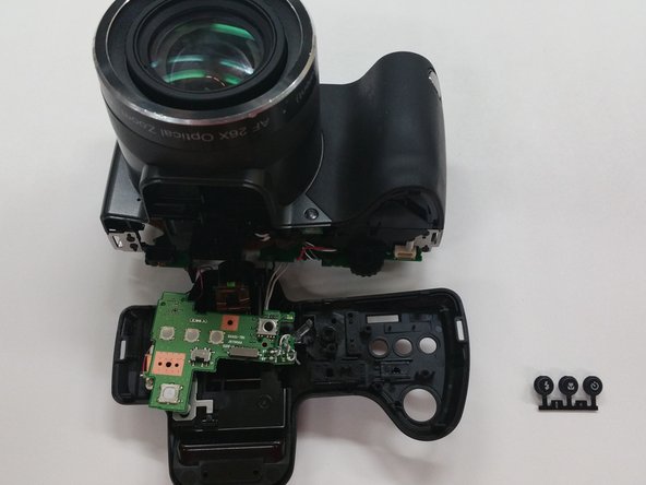

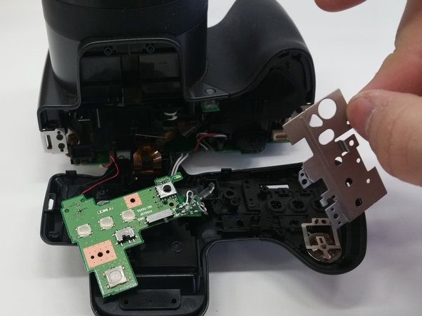

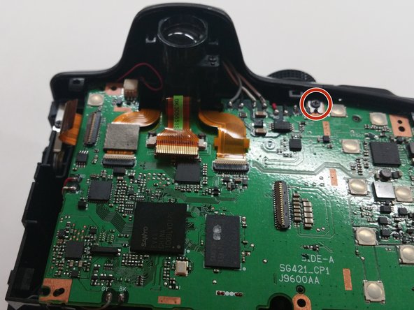

    • Remove four (4) 3mm screws from the circuit board underneath the button set.
    • Gently move the circuit board aside.
    • Gently move aside the metal sheet.
  9. Kodak Easyshare Z981 Flash Button Replacement: crwdns2935265:09crwdnd2935265:01crwdnd2935265:02crwdne2935265:0 Kodak Easyshare Z981 Flash Button Replacement: crwdns2935265:09crwdnd2935265:02crwdnd2935265:02crwdne2935265:0
    • Use Tweezers to carefully remove the flash button.
    • The button should simply pop out when light pressure is applied.
