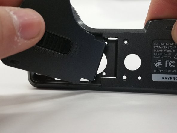

    • Open the battery cover and remove the AA batteries from the camera if any are inserted.
  2. Kodak Easyshare Z981 Bottom Panel Replacement: crwdns2935265:02crwdnd2935265:01crwdnd2935265:03crwdne2935265:0 Kodak Easyshare Z981 Bottom Panel Replacement: crwdns2935265:02crwdnd2935265:02crwdnd2935265:03crwdne2935265:0 Kodak Easyshare Z981 Bottom Panel Replacement: crwdns2935265:02crwdnd2935265:03crwdnd2935265:03crwdne2935265:0
    Phillips #00 Screwdriver
    $5.49
    • Use a 00 Phillips-Head screwdriver
    • Remove the 3 mm screws from the camera.
    • Four (4) screws are in the bottom of the device
    • Four (4) screws are inside the battery cover
  3. Kodak Easyshare Z981 Bottom Panel Replacement: crwdns2935265:03crwdnd2935265:01crwdnd2935265:01crwdne2935265:0
    • Start from a corner and gently remove the bottom cover.
    • The cover will easily lift off, so not much pressure is required.
    • Be gentle while removing the cover, to avoid breaking the plastic
  4. Kodak Easyshare Z981 Bottom Panel Replacement: crwdns2935265:04crwdnd2935265:01crwdnd2935265:03crwdne2935265:0 Kodak Easyshare Z981 Bottom Panel Replacement: crwdns2935265:04crwdnd2935265:02crwdnd2935265:03crwdne2935265:0 Kodak Easyshare Z981 Bottom Panel Replacement: crwdns2935265:04crwdnd2935265:03crwdnd2935265:03crwdne2935265:0
    • Remove the bottom of the battery cover first, and then the top.
    • The hinge is simple, the screwdriver is no longer necessary.
