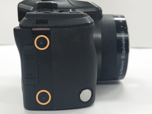

    • Use a Phillips #00 Screwdriver to remove the 4 mm screws from each side of the back cover of the camera.
    • Two (2) screws are located in the left side of the device
    • Two (2) screws are locatecd in the right side of the device

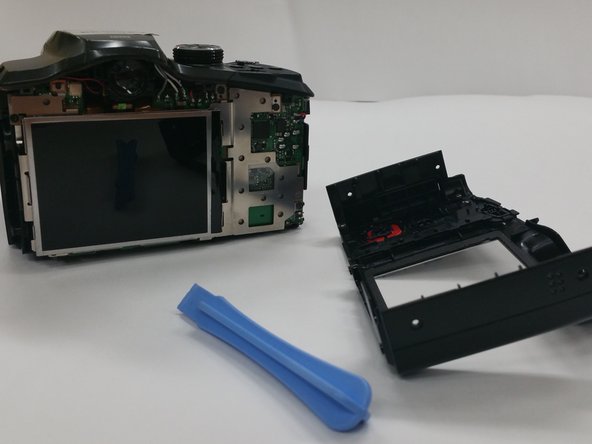

  4. Kodak Easyshare Z981 Back Cover Replacement: crwdns2935265:04crwdnd2935265:01crwdnd2935265:02crwdne2935265:0 Kodak Easyshare Z981 Back Cover Replacement: crwdns2935265:04crwdnd2935265:02crwdnd2935265:02crwdne2935265:0
    • Use a Plastic Opening Tool to remove the back of the camera and pull gently on the cover to remove the cover
    • Start from one corner and apply light pressure with the tool.
