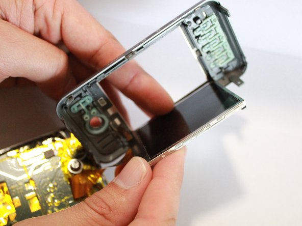

    • Remove the LCD display by unplugging the connector
    • Take apart the LCD display from the back case

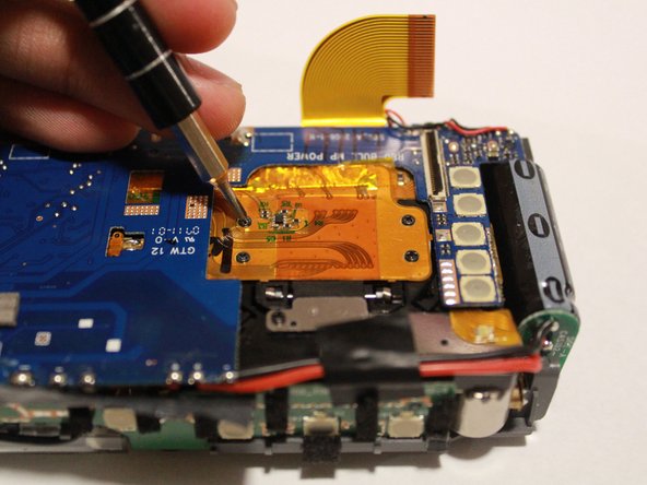

    • Peel off the yellow film.
    • Peel off the black tape holding the wires.

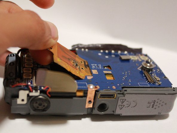

  10. Kodak Easyshare V1003 Lens  Replacement: crwdns2935265:010crwdnd2935265:01crwdnd2935265:01crwdne2935265:0
    • Unplug the connector by lifting the little lock holding it in place.

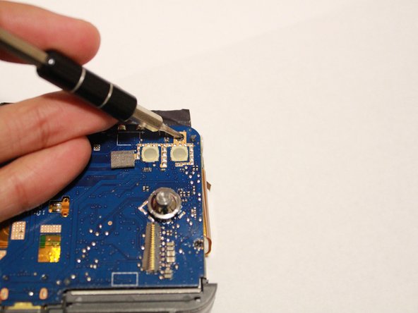

  11. Kodak Easyshare V1003 Lens  Replacement: crwdns2935265:011crwdnd2935265:01crwdnd2935265:02crwdne2935265:0 Kodak Easyshare V1003 Lens  Replacement: crwdns2935265:011crwdnd2935265:02crwdnd2935265:02crwdne2935265:0
    • Use a J00 screwdriver to remove two screws located on the far right, near to the main button.
  12. Kodak Easyshare V1003 Lens  Replacement: crwdns2935265:012crwdnd2935265:01crwdnd2935265:03crwdne2935265:0 Kodak Easyshare V1003 Lens  Replacement: crwdns2935265:012crwdnd2935265:02crwdnd2935265:03crwdne2935265:0 Kodak Easyshare V1003 Lens  Replacement: crwdns2935265:012crwdnd2935265:03crwdnd2935265:03crwdne2935265:0
    • Use a J00 screwdriver to remove 6 screws located at the center of the back panel.
    • Gently pull out the lens using you finger tips or pincers.
