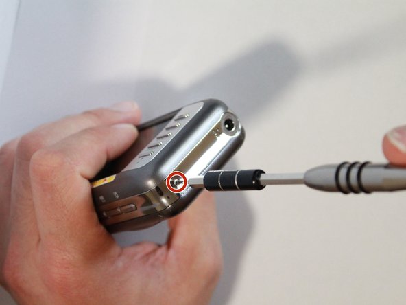

  6. Kodak Easyshare V1003  LCD Display Replacement, Buttons: crwdns2935265:06crwdnd2935265:01crwdnd2935265:03crwdne2935265:0 Kodak Easyshare V1003  LCD Display Replacement, Buttons: crwdns2935265:06crwdnd2935265:02crwdnd2935265:03crwdne2935265:0 Kodak Easyshare V1003  LCD Display Replacement, Buttons: crwdns2935265:06crwdnd2935265:03crwdnd2935265:03crwdne2935265:0
    • Use a J00 screwdriver to remove the five exterior screws.

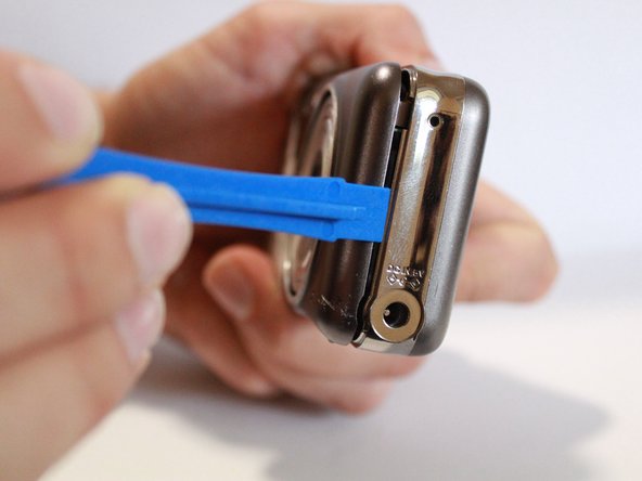

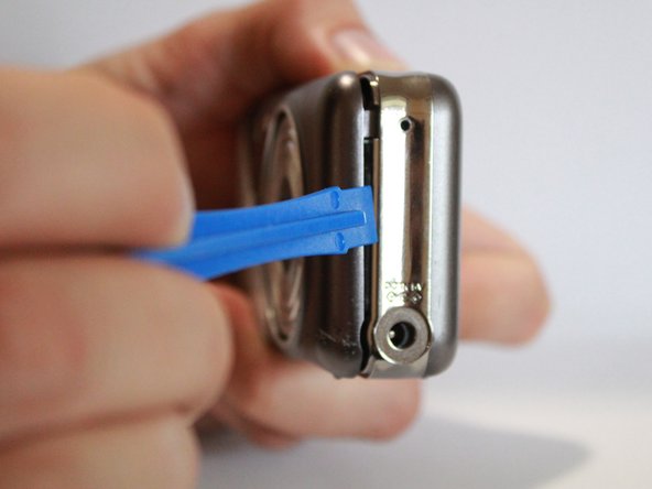

    • Use a plastic opening tool to pry off the back casing.
  8. Kodak Easyshare V1003  LCD Display Replacement: crwdns2935265:08crwdnd2935265:01crwdnd2935265:03crwdne2935265:0 Kodak Easyshare V1003  LCD Display Replacement: crwdns2935265:08crwdnd2935265:02crwdnd2935265:03crwdne2935265:0 Kodak Easyshare V1003  LCD Display Replacement: crwdns2935265:08crwdnd2935265:03crwdnd2935265:03crwdne2935265:0
    • Completely remove the back casing from the device.
    • Using a plastic tool to remove the bottom.
