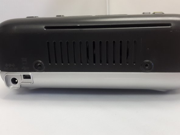

  3. Kodak Easyshare Printer Dock (Series 3) Paper Jam Solution, Disconnecting the power adapter: crwdns2935265:03crwdnd2935265:01crwdnd2935265:02crwdne2935265:0 Kodak Easyshare Printer Dock (Series 3) Paper Jam Solution, Disconnecting the power adapter: crwdns2935265:03crwdnd2935265:02crwdnd2935265:02crwdne2935265:0
    • Disconnect the power adapter from the printer for 10 seconds, and then reconnect the cord.
    • On some models, you may have to press the power button in addition to plugging in the power adapter.
    • Wait for the printer to initialize in order for the jammed paper to exit from the back side.
    • Notice: Carefully remove the paper if it does not automatically eject.
