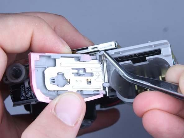

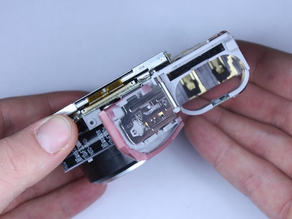

  12. Kodak Easyshare C813 Battery Door Replacement, Battery Door: crwdns2935265:012crwdnd2935265:01crwdnd2935265:02crwdne2935265:0 Kodak Easyshare C813 Battery Door Replacement, Battery Door: crwdns2935265:012crwdnd2935265:02crwdnd2935265:02crwdne2935265:0
    • Open the battery door by pulling in direction of arrow
  13. Kodak Easyshare C813 Battery Door Replacement: crwdns2935265:013crwdnd2935265:01crwdnd2935265:03crwdne2935265:0 Kodak Easyshare C813 Battery Door Replacement: crwdns2935265:013crwdnd2935265:02crwdnd2935265:03crwdne2935265:0 Kodak Easyshare C813 Battery Door Replacement: crwdns2935265:013crwdnd2935265:03crwdnd2935265:03crwdne2935265:0

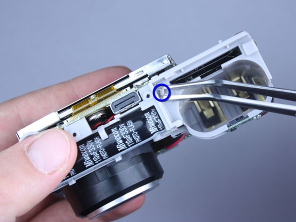

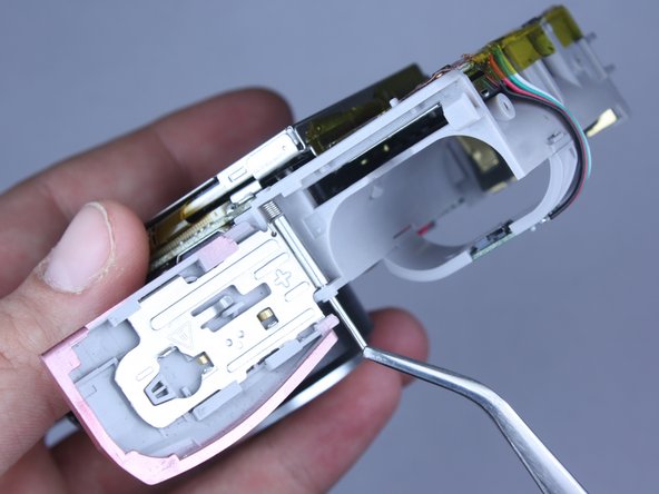

  14. Kodak Easyshare C813 Battery Door Replacement: crwdns2935265:014crwdnd2935265:01crwdnd2935265:03crwdne2935265:0 Kodak Easyshare C813 Battery Door Replacement: crwdns2935265:014crwdnd2935265:02crwdnd2935265:03crwdne2935265:0 Kodak Easyshare C813 Battery Door Replacement: crwdns2935265:014crwdnd2935265:03crwdnd2935265:03crwdne2935265:0
    • The spring is small and easy to lose
    • Carefully remove battery door and spring
    • Make spring is in correct orientation when putting back
    • The spring should hook onto a small hole in the door
