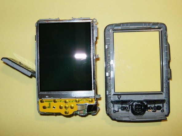

    • Start splitting the case from the battery holder. You can use an opening tool or just your fingernails.
  3. Kodak Easyshare C183 Lens Assembly Replacement: crwdns2935265:03crwdnd2935265:01crwdnd2935265:03crwdne2935265:0 Kodak Easyshare C183 Lens Assembly Replacement: crwdns2935265:03crwdnd2935265:02crwdnd2935265:03crwdne2935265:0 Kodak Easyshare C183 Lens Assembly Replacement: crwdns2935265:03crwdnd2935265:03crwdnd2935265:03crwdne2935265:0

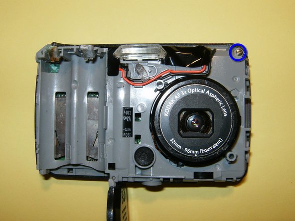

    • The camera's front half will come off first.
    • Remove the one screw on the top left of the camera. It this holds the back case on to the midframe.
    • Remove the back case.

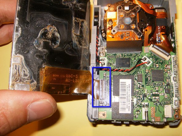

  4. Kodak Easyshare C183 Lens Assembly Replacement: crwdns2935265:04crwdnd2935265:01crwdnd2935265:03crwdne2935265:0 Kodak Easyshare C183 Lens Assembly Replacement: crwdns2935265:04crwdnd2935265:02crwdnd2935265:03crwdne2935265:0 Kodak Easyshare C183 Lens Assembly Replacement: crwdns2935265:04crwdnd2935265:03crwdnd2935265:03crwdne2935265:0
    • Gently move the LCD out of the holder. DO NOT TRY TO REMOVE THE LCD. Just fold it over.
    • Remove the one screw on the top corner of the holder.
    • Remove the ribbon cable from its connector. It is just pushed in. there are not clips to move. Gently pull it straight down.

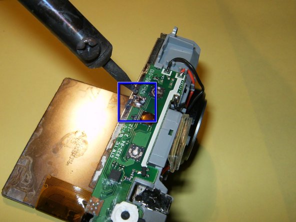

    • Remove the solder that connects the LCD holder to the top logic board.

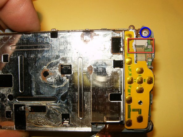

  5. Kodak Easyshare C183 Lens Assembly Replacement: crwdns2935265:05crwdnd2935265:01crwdnd2935265:03crwdne2935265:0 Kodak Easyshare C183 Lens Assembly Replacement: crwdns2935265:05crwdnd2935265:02crwdnd2935265:03crwdne2935265:0 Kodak Easyshare C183 Lens Assembly Replacement: crwdns2935265:05crwdnd2935265:03crwdnd2935265:03crwdne2935265:0
    • The LCD holding board and the switches are removed as one unit.
    • Open the clip on the LCD ribbon cable connector. Use your fingernails to gently pull it toward the top of the camera.
    • Remove the LCD.

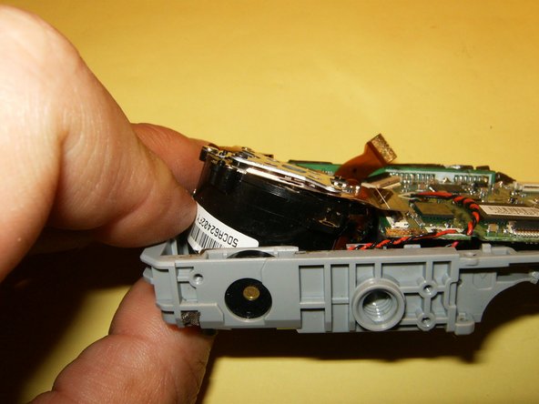

  6. Kodak Easyshare C183 Lens Assembly Replacement: crwdns2935265:06crwdnd2935265:01crwdnd2935265:03crwdne2935265:0 Kodak Easyshare C183 Lens Assembly Replacement: crwdns2935265:06crwdnd2935265:02crwdnd2935265:03crwdne2935265:0 Kodak Easyshare C183 Lens Assembly Replacement: crwdns2935265:06crwdnd2935265:03crwdnd2935265:03crwdne2935265:0
    • Open the connectors for the CCD and the lens. Both use a clip that hold the cable is places. Move those gently into the opposite direction of the cables. this will free the cable.
    • Remove the two screws that hold the lens in place.
    • With the screws and the cables removed, use your fingers and push the lens upward and angled out of the midframe.

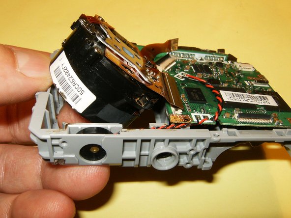

  7. Kodak Easyshare C183 Lens Assembly Replacement: crwdns2935265:07crwdnd2935265:01crwdnd2935265:01crwdne2935265:0
    • This is what your final result should look like. the lens is now free from the midframe and a new lens can be easily installed.
