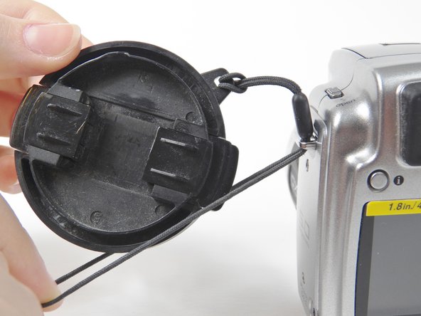

  3. Kodak EasyShare Z740 LCD Screen Replacement, Lens Cover: crwdns2935265:03crwdnd2935265:01crwdnd2935265:02crwdne2935265:0 Kodak EasyShare Z740 LCD Screen Replacement, Lens Cover: crwdns2935265:03crwdnd2935265:02crwdnd2935265:02crwdne2935265:0
    • Remove lens cover from the camera by squeezing the protruding button on each side of the cover and pulling.
  4. Kodak EasyShare Z740 LCD Screen Replacement: crwdns2935265:04crwdnd2935265:01crwdnd2935265:03crwdne2935265:0 Kodak EasyShare Z740 LCD Screen Replacement: crwdns2935265:04crwdnd2935265:02crwdnd2935265:03crwdne2935265:0 Kodak EasyShare Z740 LCD Screen Replacement: crwdns2935265:04crwdnd2935265:03crwdnd2935265:03crwdne2935265:0
    • Pull the lens cover string toward the ground so that the loop underneath the metal slab is on top of the cover string.
    • Push up so that the string starts to come out of the top of the loop.
    • Grab the string from above the loop and pull.

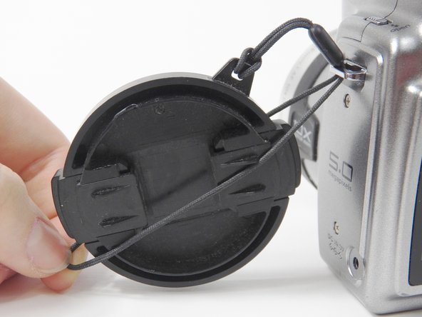

  5. Kodak EasyShare Z740 LCD Screen Replacement: crwdns2935265:05crwdnd2935265:01crwdnd2935265:02crwdne2935265:0 Kodak EasyShare Z740 LCD Screen Replacement: crwdns2935265:05crwdnd2935265:02crwdnd2935265:02crwdne2935265:0
    • Feed the string on top into the metal slab while pulling the loop toward you until the plastic piece stops you from pulling any further.
  6. Kodak EasyShare Z740 LCD Screen Replacement: crwdns2935265:06crwdnd2935265:01crwdnd2935265:03crwdne2935265:0 Kodak EasyShare Z740 LCD Screen Replacement: crwdns2935265:06crwdnd2935265:02crwdnd2935265:03crwdne2935265:0 Kodak EasyShare Z740 LCD Screen Replacement: crwdns2935265:06crwdnd2935265:03crwdnd2935265:03crwdne2935265:0
    • Separate the two pieces of the loop and pull the lens cover up in between them.
  7. Kodak EasyShare Z740 LCD Screen Replacement: crwdns2935265:07crwdnd2935265:01crwdnd2935265:03crwdne2935265:0 Kodak EasyShare Z740 LCD Screen Replacement: crwdns2935265:07crwdnd2935265:02crwdnd2935265:03crwdne2935265:0 Kodak EasyShare Z740 LCD Screen Replacement: crwdns2935265:07crwdnd2935265:03crwdnd2935265:03crwdne2935265:0
    • Pull the lens cover and the sting will come out of the metal slab.

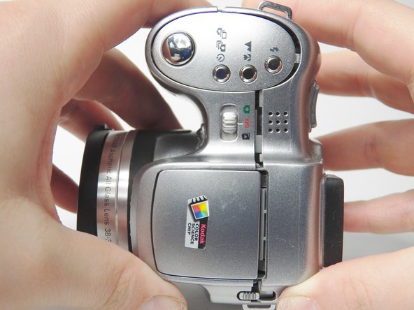

  8. Kodak EasyShare Z740 LCD Screen Replacement, Back Cover: crwdns2935265:08crwdnd2935265:01crwdnd2935265:03crwdne2935265:0 Kodak EasyShare Z740 LCD Screen Replacement, Back Cover: crwdns2935265:08crwdnd2935265:02crwdnd2935265:03crwdne2935265:0 Kodak EasyShare Z740 LCD Screen Replacement, Back Cover: crwdns2935265:08crwdnd2935265:03crwdnd2935265:03crwdne2935265:0
    • Place lens cover back on the lens to prevent scratches or debris but leave string detached.
    • Remove a total of six 3.968mm Phillips #00 screws. Two each from the left side, bottom, and right side.
  9. Kodak EasyShare Z740 LCD Screen Replacement: crwdns2935265:09crwdnd2935265:01crwdnd2935265:03crwdne2935265:0 Kodak EasyShare Z740 LCD Screen Replacement: crwdns2935265:09crwdnd2935265:02crwdnd2935265:03crwdne2935265:0 Kodak EasyShare Z740 LCD Screen Replacement: crwdns2935265:09crwdnd2935265:03crwdnd2935265:03crwdne2935265:0
    • Pull the back cover away from the front cover.
    • You may need to use a plastic opening tool as a wedge if it does not come apart by easily.

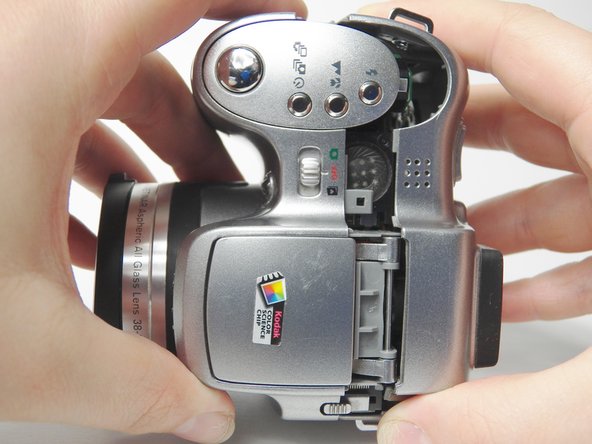

  10. Kodak EasyShare Z740 LCD Screen Replacement: crwdns2935265:010crwdnd2935265:01crwdnd2935265:01crwdne2935265:0
    • Separate the back cover from the front cover.

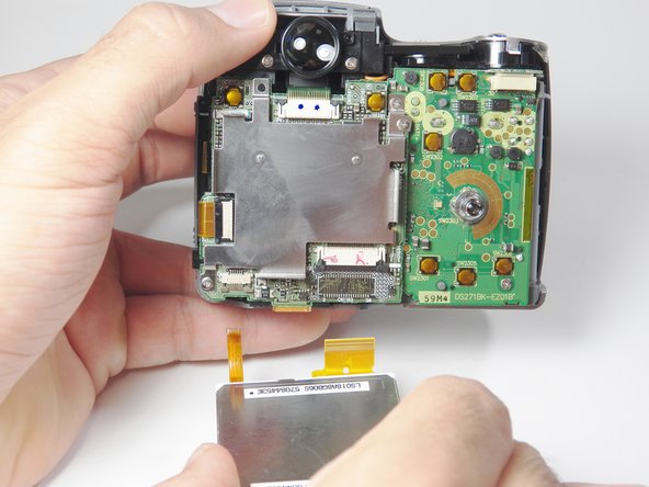

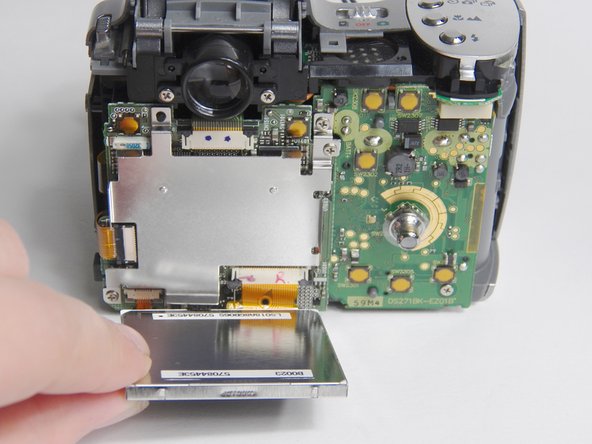

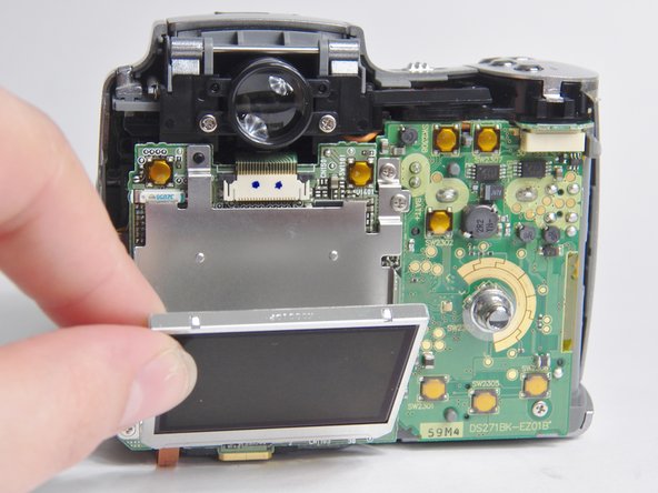

  11. Kodak EasyShare Z740 LCD Screen Replacement, LCD Screen: crwdns2935265:011crwdnd2935265:01crwdnd2935265:03crwdne2935265:0 Kodak EasyShare Z740 LCD Screen Replacement, LCD Screen: crwdns2935265:011crwdnd2935265:02crwdnd2935265:03crwdne2935265:0 Kodak EasyShare Z740 LCD Screen Replacement, LCD Screen: crwdns2935265:011crwdnd2935265:03crwdnd2935265:03crwdne2935265:0
    • Flip the LCD screen down.

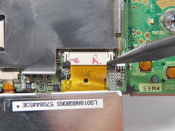

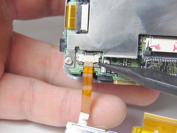

  12. Kodak EasyShare Z740 LCD Screen Replacement: crwdns2935265:012crwdnd2935265:01crwdnd2935265:03crwdne2935265:0 Kodak EasyShare Z740 LCD Screen Replacement: crwdns2935265:012crwdnd2935265:02crwdnd2935265:03crwdne2935265:0 Kodak EasyShare Z740 LCD Screen Replacement: crwdns2935265:012crwdnd2935265:03crwdnd2935265:03crwdne2935265:0
    • Locate the two sets of black tabs connecting the flat orange cables to the motherboard.
    • Slide the 2 sets of tabs down with a tool or your finger to release the cables.
  13. Kodak EasyShare Z740 LCD Screen Replacement: crwdns2935265:013crwdnd2935265:01crwdnd2935265:02crwdne2935265:0 Kodak EasyShare Z740 LCD Screen Replacement: crwdns2935265:013crwdnd2935265:02crwdnd2935265:02crwdne2935265:0
    • Gently pull the LCD screen down until the orange cables separate from the motherboard.

There isn’t a single image online of the back side of the DS271BK-EZ01B board. Could someone please show the correct way to remove it? I have corrosion on the battery contacts, which may be why I’m having trouble dismounting it. Even just one clear photo of this board’s back side would be incredibly helpful. Thank you!
