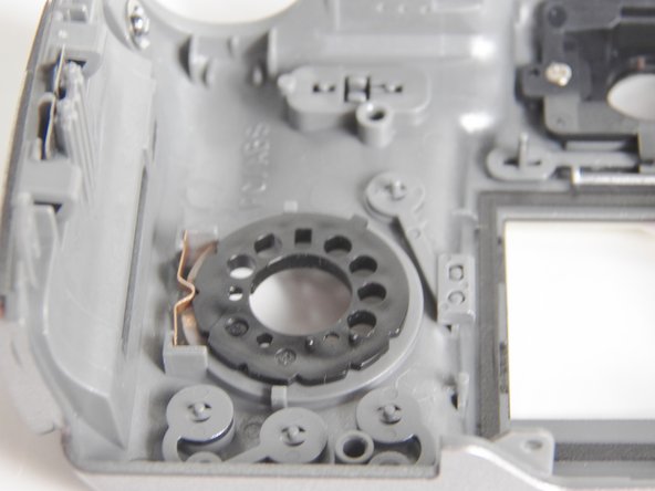

    1. Kodak EasyShare Z740 Button Replacement, Button Pad: crwdns2935265:014crwdnd2935265:01crwdnd2935265:03crwdne2935265:0 Kodak EasyShare Z740 Button Replacement, Button Pad: crwdns2935265:014crwdnd2935265:02crwdnd2935265:03crwdne2935265:0 Kodak EasyShare Z740 Button Replacement, Button Pad: crwdns2935265:014crwdnd2935265:03crwdnd2935265:03crwdne2935265:0
      • Remove two Phillips #00 screws from the inside of the button pad on the back cover.
    2. Kodak EasyShare Z740 Button Replacement: crwdns2935265:015crwdnd2935265:01crwdnd2935265:02crwdne2935265:0 Kodak EasyShare Z740 Button Replacement: crwdns2935265:015crwdnd2935265:02crwdnd2935265:02crwdne2935265:0
      • Remove the metal piece shown.
    3. Kodak EasyShare Z740 Button Replacement: crwdns2935265:016crwdnd2935265:01crwdnd2935265:02crwdne2935265:0 Kodak EasyShare Z740 Button Replacement: crwdns2935265:016crwdnd2935265:02crwdnd2935265:02crwdne2935265:0
      • Remove the black ring from the back and the white button pad will fall out from the front.
