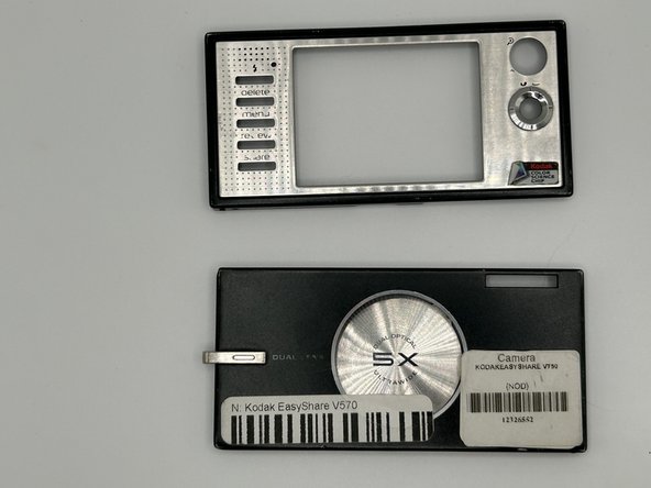

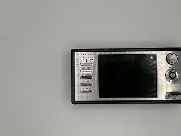

    • Here is the front, back, and right side of the camera.

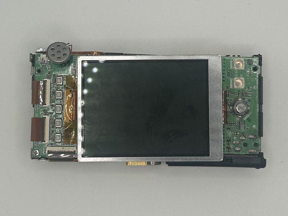

  4. Kodak EasyShare V570 Case Replacement: crwdns2935265:04crwdnd2935265:01crwdnd2935265:02crwdne2935265:0 Kodak EasyShare V570 Case Replacement: crwdns2935265:04crwdnd2935265:02crwdnd2935265:02crwdne2935265:0
    • Here is what the camera looks like with both of the covers taken off.
    • The T-W button is upside down.
    • To put the top and back camera covers back on, follow the steps but in reverse.
