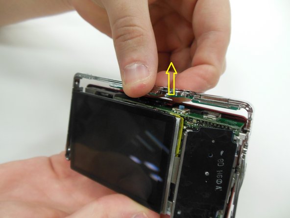

  7. Kodak EasyShare M381 Battery Latch Replacement: crwdns2935265:07crwdnd2935265:01crwdnd2935265:02crwdne2935265:0 Kodak EasyShare M381 Battery Latch Replacement: crwdns2935265:07crwdnd2935265:02crwdnd2935265:02crwdne2935265:0
    • Starting at one side, carefully work the chrome frame off of the camera itself.
    • Be careful not to disturb the shutter or flash buttons on top of the camera.

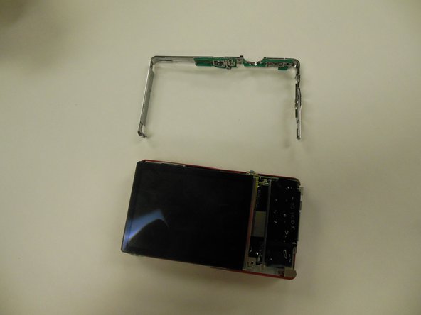

  11. Kodak EasyShare M381 Battery Latch Replacement, Battery Latch: crwdns2935265:011crwdnd2935265:01crwdnd2935265:03crwdne2935265:0 Kodak EasyShare M381 Battery Latch Replacement, Battery Latch: crwdns2935265:011crwdnd2935265:02crwdnd2935265:03crwdne2935265:0 Kodak EasyShare M381 Battery Latch Replacement, Battery Latch: crwdns2935265:011crwdnd2935265:03crwdnd2935265:03crwdne2935265:0
    • Locate and remove selector dial on the top of the camera.
    • This should free the chrome mid-frame that encompasses the camera. Carefully lift and remove it as well.

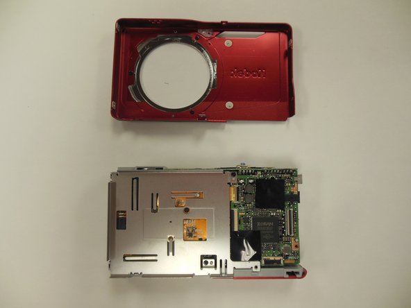

    • Carefully lift and remove front covered panel from the camera.
  13. Kodak EasyShare M381 Battery Latch Replacement: crwdns2935265:013crwdnd2935265:01crwdnd2935265:01crwdne2935265:0
    • Locate metal battery panel. Carefully lift and remove it as indicated.

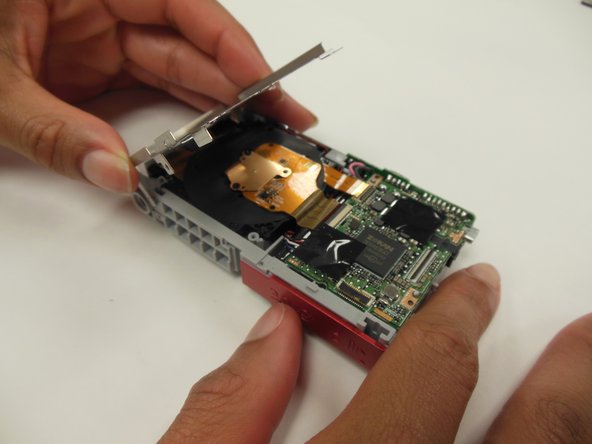

  14. Kodak EasyShare M381 Battery Latch Replacement: crwdns2935265:014crwdnd2935265:01crwdnd2935265:03crwdne2935265:0 Kodak EasyShare M381 Battery Latch Replacement: crwdns2935265:014crwdnd2935265:02crwdnd2935265:03crwdne2935265:0 Kodak EasyShare M381 Battery Latch Replacement: crwdns2935265:014crwdnd2935265:03crwdnd2935265:03crwdne2935265:0
    • Locate the four 3.25 mm screws holding the metal lens panel in place, and remove them.
    • You should then be able to lift and remove the metal paneling. This will now expose the pin holding the battery latch in place as indicated.

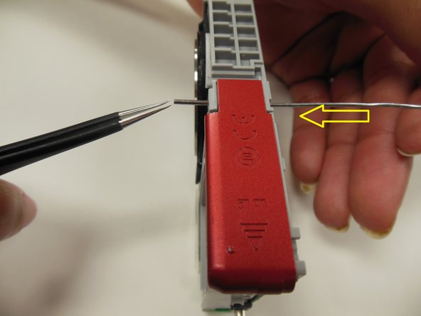

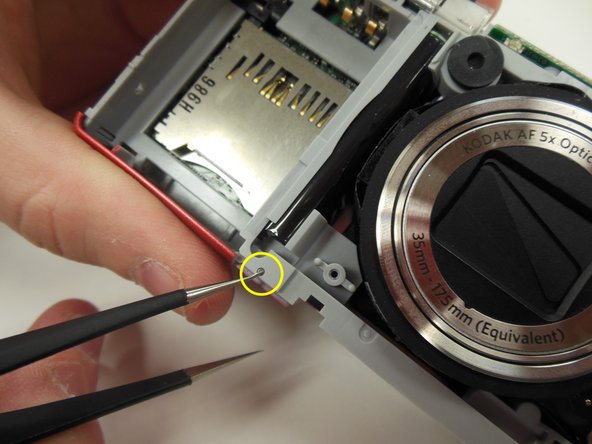

  15. Kodak EasyShare M381 Battery Latch Replacement: crwdns2935265:015crwdnd2935265:01crwdnd2935265:02crwdne2935265:0 Kodak EasyShare M381 Battery Latch Replacement: crwdns2935265:015crwdnd2935265:02crwdnd2935265:02crwdne2935265:0
    • Keeping the battery latch panel closed and in place, use a straightened paper clip (or similar tool) to push the pin out of the hole.
    • Use tweezers to securely remove pin.
    • Placing the pin on a magnet pad or piece of tape is recommended to prevent from losing it.
    • The spring is under tension. When performing this step, it may fly out if not done correctly. Take proper precautions to minimize injury and loss of parts.

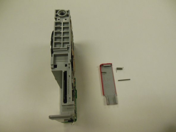

  16. Kodak EasyShare M381 Battery Latch Replacement: crwdns2935265:016crwdnd2935265:01crwdnd2935265:02crwdne2935265:0 Kodak EasyShare M381 Battery Latch Replacement: crwdns2935265:016crwdnd2935265:02crwdnd2935265:02crwdne2935265:0
    • The latch can now easily be pulled out of place and removed.
