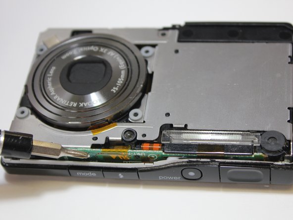

    • Remove screws along side.
    • Gently peel off side casing.

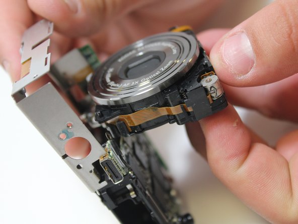

  6. Kodak EasyShare M2008 Lens Replacement, Lens: crwdns2935265:06crwdnd2935265:01crwdnd2935265:03crwdne2935265:0 Kodak EasyShare M2008 Lens Replacement, Lens: crwdns2935265:06crwdnd2935265:02crwdnd2935265:03crwdne2935265:0 Kodak EasyShare M2008 Lens Replacement, Lens: crwdns2935265:06crwdnd2935265:03crwdnd2935265:03crwdne2935265:0

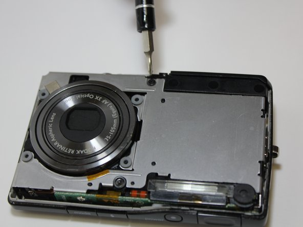

    • Remove screws from front silver panel.

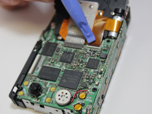

  7. Kodak EasyShare M2008 Lens Replacement: crwdns2935265:07crwdnd2935265:01crwdnd2935265:03crwdne2935265:0 Kodak EasyShare M2008 Lens Replacement: crwdns2935265:07crwdnd2935265:02crwdnd2935265:03crwdne2935265:0 Kodak EasyShare M2008 Lens Replacement: crwdns2935265:07crwdnd2935265:03crwdnd2935265:03crwdne2935265:0
    • Lift up ribbon cable fastener with blue plastic opening tool.
    • Gently pull out lens.
  8. Kodak EasyShare M2008 Lens Replacement: crwdns2935265:08crwdnd2935265:01crwdnd2935265:01crwdne2935265:0
    • To place new lens, peel off silver tape before inserting ribbon cable into proper slot.
