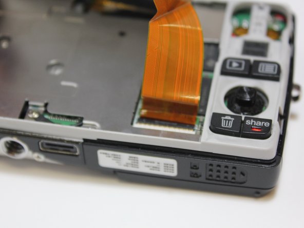

  6. Kodak EasyShare M2008 LCD Screen Replacement, LCD Screen: crwdns2935265:06crwdnd2935265:01crwdnd2935265:02crwdne2935265:0 Kodak EasyShare M2008 LCD Screen Replacement, LCD Screen: crwdns2935265:06crwdnd2935265:02crwdnd2935265:02crwdne2935265:0
    • Gently lift up the LCD screen after removing back casing.

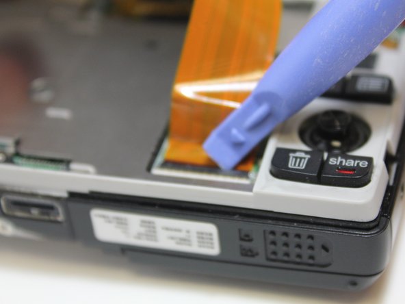

    • Find the point where the orange ribbon cable attaches to mother board.
  7. Kodak EasyShare M2008 LCD Screen Replacement: crwdns2935265:07crwdnd2935265:01crwdnd2935265:02crwdne2935265:0 Kodak EasyShare M2008 LCD Screen Replacement: crwdns2935265:07crwdnd2935265:02crwdnd2935265:02crwdne2935265:0
    • Use plastic opening tool to gently lift up on the ribbon cable fastener.
    • Note: It does not take much pressure to release fastener.
  8. Kodak EasyShare M2008 LCD Screen Replacement: crwdns2935265:08crwdnd2935265:01crwdnd2935265:01crwdne2935265:0
    • Lift LCD Screen off of device.
