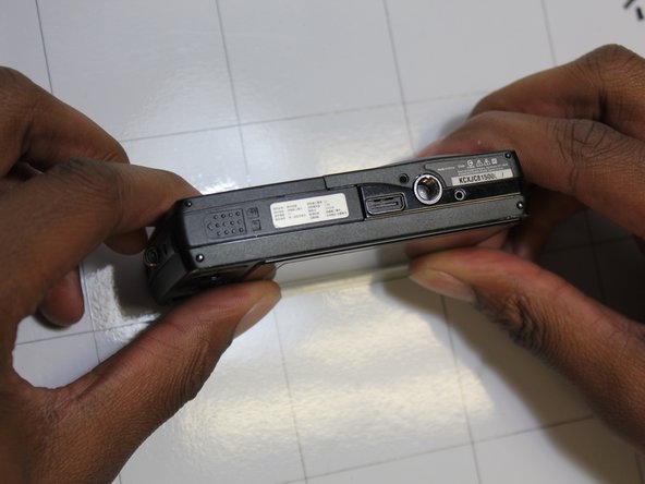

    • Place thumb firmly on batter cover.
    • Slide thumb right, the cover should follow and pop up.

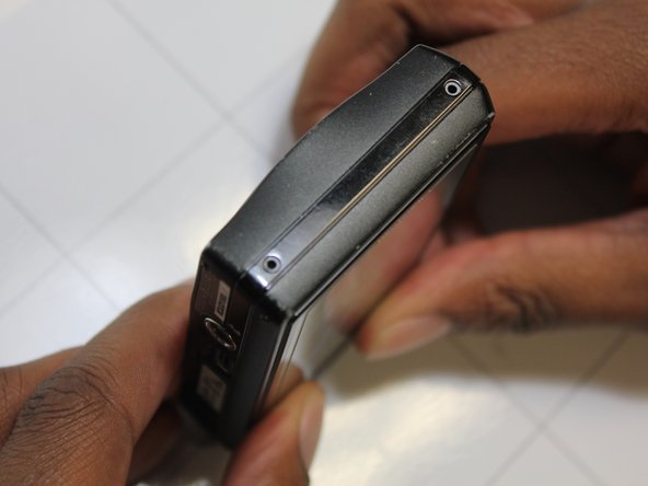

  3. Kodak EasyShare M2008 Battery Door Replacement, Device Casing: crwdns2935265:03crwdnd2935265:01crwdnd2935265:03crwdne2935265:0 Kodak EasyShare M2008 Battery Door Replacement, Device Casing: crwdns2935265:03crwdnd2935265:02crwdnd2935265:03crwdne2935265:0 Kodak EasyShare M2008 Battery Door Replacement, Device Casing: crwdns2935265:03crwdnd2935265:03crwdnd2935265:03crwdne2935265:0
    • Remove screws from along outer edge of casing.
    • There are 6 screws in total.
    • Righty tighty, lefty loosey!

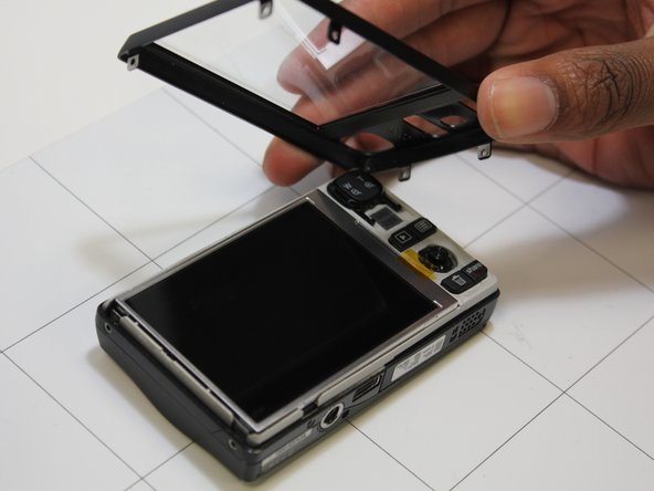

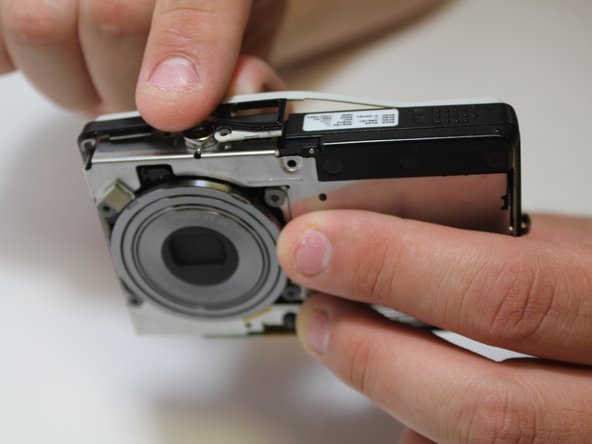

  4. Kodak EasyShare M2008 Battery Door Replacement: crwdns2935265:04crwdnd2935265:01crwdnd2935265:03crwdne2935265:0 Kodak EasyShare M2008 Battery Door Replacement: crwdns2935265:04crwdnd2935265:02crwdnd2935265:03crwdne2935265:0 Kodak EasyShare M2008 Battery Door Replacement: crwdns2935265:04crwdnd2935265:03crwdnd2935265:03crwdne2935265:0
    • Gently lift off front and back casing.

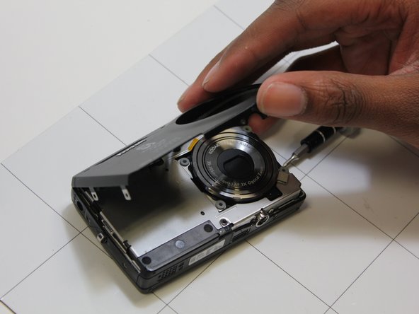

  5. Kodak EasyShare M2008 Battery Door Replacement: crwdns2935265:05crwdnd2935265:01crwdnd2935265:03crwdne2935265:0 Kodak EasyShare M2008 Battery Door Replacement: crwdns2935265:05crwdnd2935265:02crwdnd2935265:03crwdne2935265:0 Kodak EasyShare M2008 Battery Door Replacement: crwdns2935265:05crwdnd2935265:03crwdnd2935265:03crwdne2935265:0
    • Remove screws along side.
    • Gently peel off side casing.

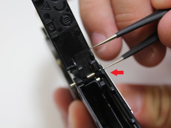

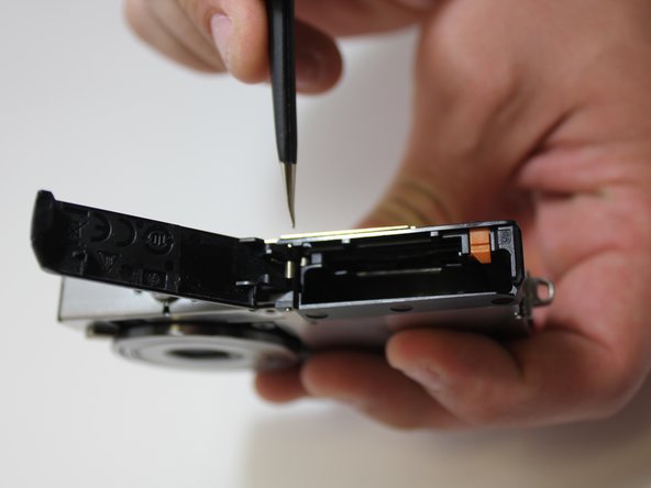

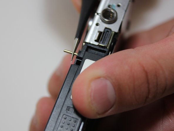

  6. Kodak EasyShare M2008 Battery Door Replacement, Battery Door: crwdns2935265:06crwdnd2935265:01crwdnd2935265:03crwdne2935265:0 Kodak EasyShare M2008 Battery Door Replacement, Battery Door: crwdns2935265:06crwdnd2935265:02crwdnd2935265:03crwdne2935265:0 Kodak EasyShare M2008 Battery Door Replacement, Battery Door: crwdns2935265:06crwdnd2935265:03crwdnd2935265:03crwdne2935265:0
    • Open the battery door.
    • Identify the retaining pin.
    • Push retaining pin out with small tweezers. Pushing the pin out halfway.

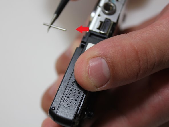

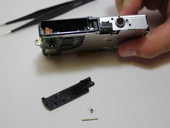

  7. Kodak EasyShare M2008 Battery Door Replacement: crwdns2935265:07crwdnd2935265:01crwdnd2935265:03crwdne2935265:0 Kodak EasyShare M2008 Battery Door Replacement: crwdns2935265:07crwdnd2935265:02crwdnd2935265:03crwdne2935265:0 Kodak EasyShare M2008 Battery Door Replacement: crwdns2935265:07crwdnd2935265:03crwdnd2935265:03crwdne2935265:0
    • Having the pin out halfway.
    • Shut the door to ensure that no loose parts get lost.
    • Next pull out the remaining length of the pin.

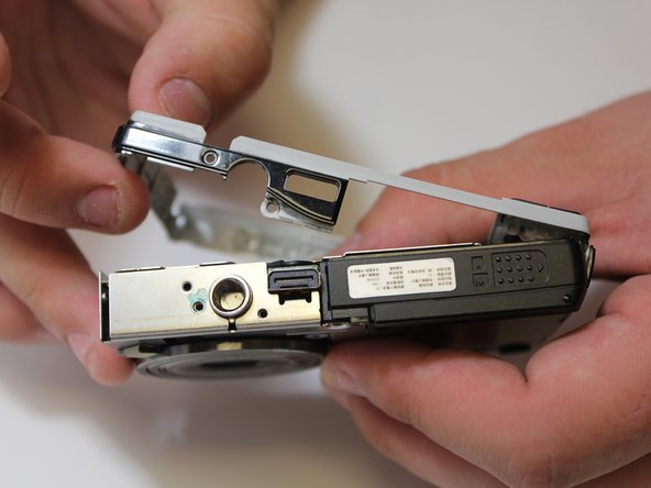

  8. Kodak EasyShare M2008 Battery Door Replacement: crwdns2935265:08crwdnd2935265:01crwdnd2935265:02crwdne2935265:0 Kodak EasyShare M2008 Battery Door Replacement: crwdns2935265:08crwdnd2935265:02crwdnd2935265:02crwdne2935265:0
    • Gently lift off door cover.
