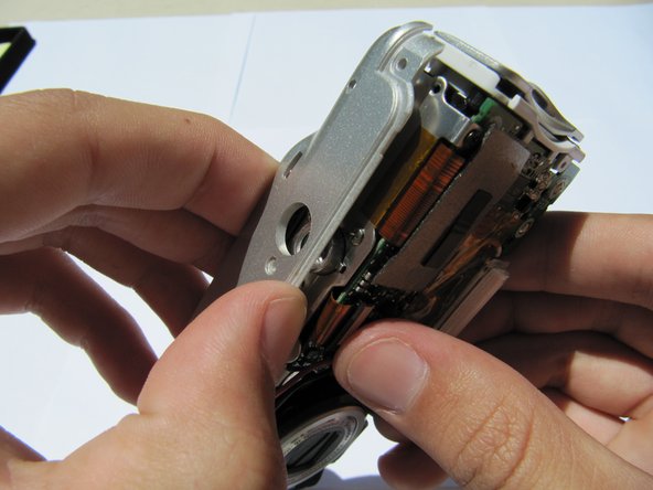

    • Carefully remove the rear camera casing.
    • Carefully remove the front camera casing.

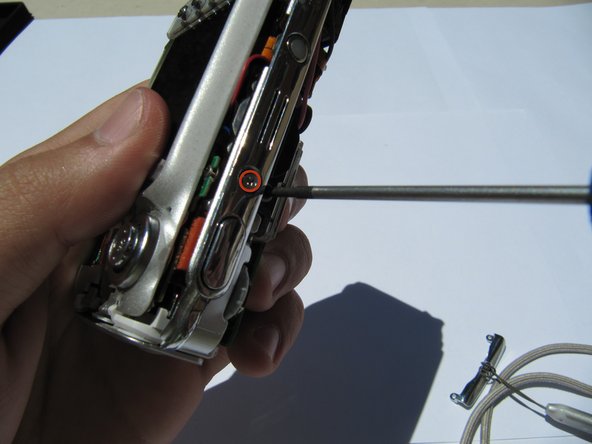

    • Remove the top panel screw (1x 4.37mm).

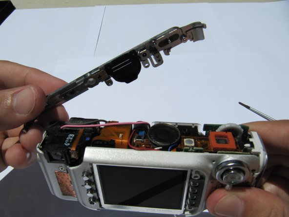

  7. Kodak EasyShare LS743 Microphone Replacement: crwdns2935265:07crwdnd2935265:01crwdnd2935265:02crwdne2935265:0 Kodak EasyShare LS743 Microphone Replacement: crwdns2935265:07crwdnd2935265:02crwdnd2935265:02crwdne2935265:0
    • Remove the top panel.

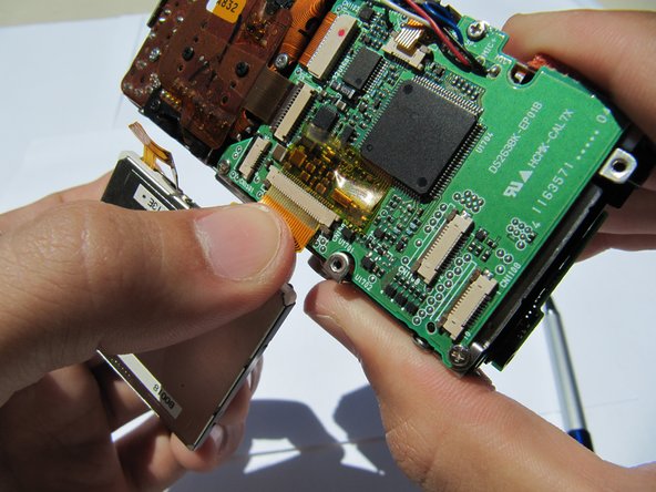

  11. Kodak EasyShare LS743 Microphone Replacement: crwdns2935265:011crwdnd2935265:01crwdnd2935265:02crwdne2935265:0 Kodak EasyShare LS743 Microphone Replacement: crwdns2935265:011crwdnd2935265:02crwdnd2935265:02crwdne2935265:0
    • Carefully separate and flip over the LCD panel to expose the central circuit board.

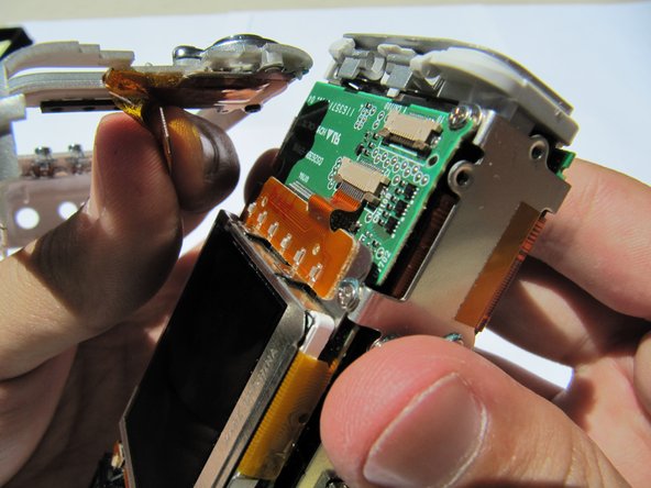

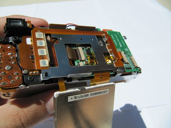

  13. Kodak EasyShare LS743 Microphone Replacement: crwdns2935265:013crwdnd2935265:01crwdnd2935265:02crwdne2935265:0 Kodak EasyShare LS743 Microphone Replacement: crwdns2935265:013crwdnd2935265:02crwdnd2935265:02crwdne2935265:0
    • Pull the second orange tab from the circuit board and remove the buttons.

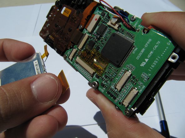

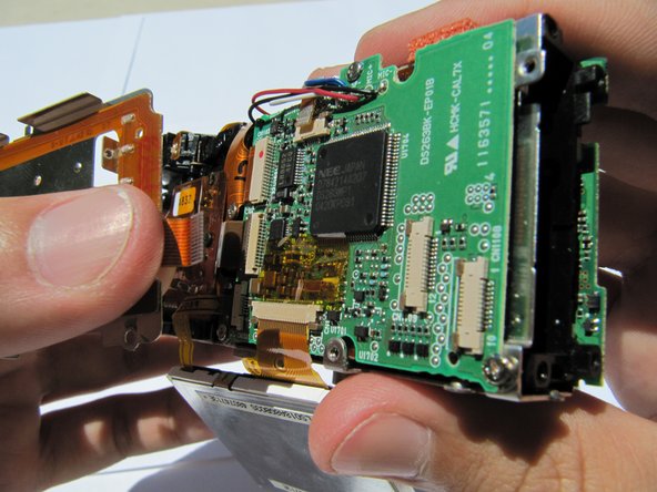

  14. Kodak EasyShare LS743 Microphone Replacement, Removing LCD: crwdns2935265:014crwdnd2935265:01crwdnd2935265:03crwdne2935265:0 Kodak EasyShare LS743 Microphone Replacement, Removing LCD: crwdns2935265:014crwdnd2935265:02crwdnd2935265:03crwdne2935265:0 Kodak EasyShare LS743 Microphone Replacement, Removing LCD: crwdns2935265:014crwdnd2935265:03crwdnd2935265:03crwdne2935265:0

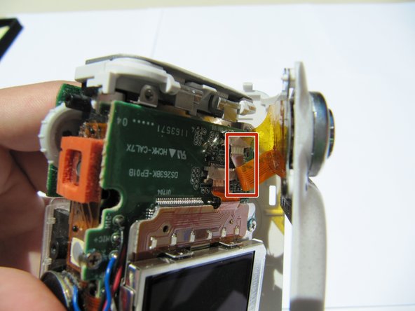

    • Flip up the LCD screen to reveal the two orange ribbon cables.
    • Disconnect the two ribbons cables from their sockets on the motherboard.

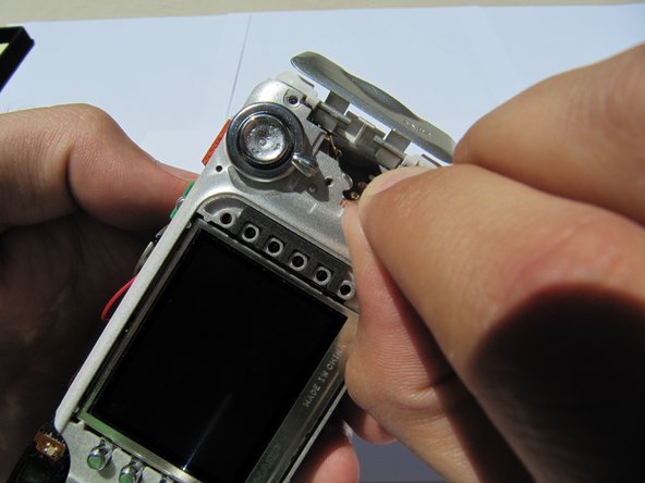

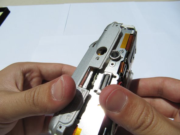

  15. Kodak EasyShare LS743 Microphone Replacement, Microphone: crwdns2935265:015crwdnd2935265:01crwdnd2935265:01crwdne2935265:0
    • Locate the microphone on top of the camera.
  16. Kodak EasyShare LS743 Microphone Replacement: crwdns2935265:016crwdnd2935265:01crwdnd2935265:01crwdne2935265:0
    • With an opening tool, pry the microphone away from the camera carefully.
  17. Kodak EasyShare LS743 Microphone Replacement: crwdns2935265:017crwdnd2935265:01crwdnd2935265:01crwdne2935265:0
    • Release the microphone from its pin and desolder.
