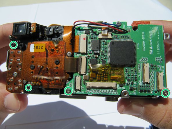

  15. Kodak EasyShare LS743 Lens Replacement, Capacitor: crwdns2935265:015crwdnd2935265:01crwdnd2935265:03crwdne2935265:0 Kodak EasyShare LS743 Lens Replacement, Capacitor: crwdns2935265:015crwdnd2935265:02crwdnd2935265:03crwdne2935265:0 Kodak EasyShare LS743 Lens Replacement, Capacitor: crwdns2935265:015crwdnd2935265:03crwdnd2935265:03crwdne2935265:0
    • The capacitor can store electricity even when the camera is off! Do not touch it until you have safely discharged it.
    • Connect the two capacitor wires briefly with a pair of metal tweezers to discharge the capacitor. You may see a small spark.
    • Remove eight screws using a Phillips #00 screwdriver.
    • Two (4.31 mm) screws are in the front of the camera.
    • Two (3.30 mm) screws are located in the bottom of the camera.
    • This causes the tripod mount on the bottom to become loose.
    • Four (3 x 3.33 mm and 1 x 4.34 mm) screws are in the back of the camera.

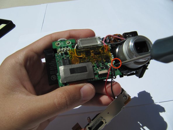

  18. Kodak EasyShare LS743 Lens Replacement: crwdns2935265:018crwdnd2935265:01crwdnd2935265:01crwdne2935265:0
    • Soldering irons pose a burn risk if handled improperly.
    • Desolder the red and black wire and remove them.

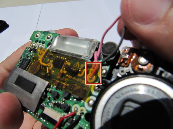

  19. Kodak EasyShare LS743 Lens Replacement: crwdns2935265:019crwdnd2935265:01crwdnd2935265:02crwdne2935265:0 Kodak EasyShare LS743 Lens Replacement: crwdns2935265:019crwdnd2935265:02crwdnd2935265:02crwdne2935265:0
    • Hold the camera firmly and gently remove the capacitor (attached by adhesive) by wiggling it loose.
    • Desolder the pink and black wire and remove both of them.

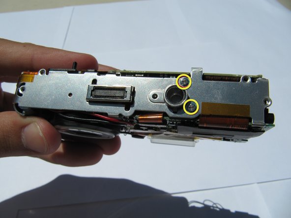

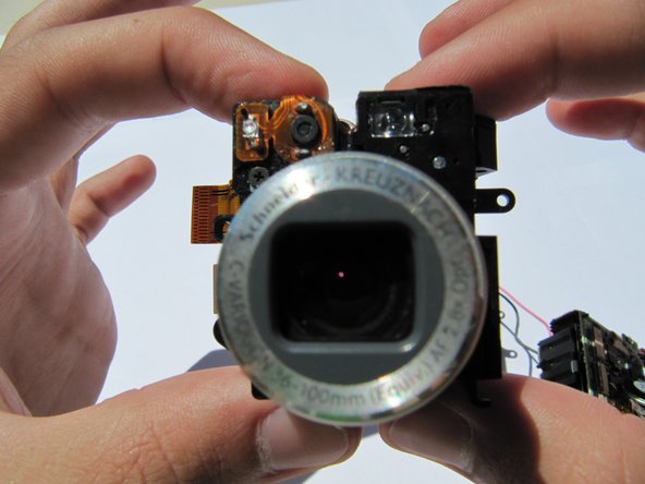

    • Remove the (1x4.27) screw from the front of the camera.
  21. Kodak EasyShare LS743 Lens Replacement: crwdns2935265:021crwdnd2935265:01crwdnd2935265:02crwdne2935265:0 Kodak EasyShare LS743 Lens Replacement: crwdns2935265:021crwdnd2935265:02crwdnd2935265:02crwdne2935265:0
    • Remove the orange tabs from the back of the camera to remove the lens.
