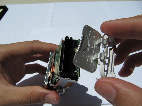

    • Using your fingernail, open the battery cover.
  2. Kodak EasyShare LS743 Battery Door Replacement: crwdns2935265:02crwdnd2935265:01crwdnd2935265:01crwdne2935265:0
    • Slide the orange latch sideways to eject the battery.
    • Remove the battery from the battery slot.
  3. Kodak EasyShare LS743 Battery Door Replacement, Kodak EasyShare LS743 Camera Case Disassembly: crwdns2935265:03crwdnd2935265:01crwdnd2935265:03crwdne2935265:0 Kodak EasyShare LS743 Battery Door Replacement, Kodak EasyShare LS743 Camera Case Disassembly: crwdns2935265:03crwdnd2935265:02crwdnd2935265:03crwdne2935265:0 Kodak EasyShare LS743 Battery Door Replacement, Kodak EasyShare LS743 Camera Case Disassembly: crwdns2935265:03crwdnd2935265:03crwdnd2935265:03crwdne2935265:0
    • Using a Phillips #00 screwdriver, remove two 5.39 mm screws next to the battery slot.
    • Remove the metal piece holding down the lanyard, then remove the lanyard.
  4. Kodak EasyShare LS743 Battery Door Replacement: crwdns2935265:04crwdnd2935265:01crwdnd2935265:03crwdne2935265:0 Kodak EasyShare LS743 Battery Door Replacement: crwdns2935265:04crwdnd2935265:02crwdnd2935265:03crwdne2935265:0 Kodak EasyShare LS743 Battery Door Replacement: crwdns2935265:04crwdnd2935265:03crwdnd2935265:03crwdne2935265:0
    • Using a Phillips #00 screwdriver, remove seven screws located on the outside case of the camera.
    • One 6.25 mm screw is located on the top right corner, right to the "OK" button.
    • Four 4.45 mm screws are on the bottom of the camera.
    • Two 2.95 mm screws are on the left side of the camera, above the USB port.
  5. Kodak EasyShare LS743 Battery Door Replacement: crwdns2935265:05crwdnd2935265:01crwdnd2935265:02crwdne2935265:0 Kodak EasyShare LS743 Battery Door Replacement: crwdns2935265:05crwdnd2935265:02crwdnd2935265:02crwdne2935265:0
    • Carefully remove the rear camera casing.
    • Carefully remove the front camera casing.
  6. Kodak EasyShare LS743 Battery Door Replacement, Battery Door: crwdns2935265:06crwdnd2935265:01crwdnd2935265:02crwdne2935265:0 Kodak EasyShare LS743 Battery Door Replacement, Battery Door: crwdns2935265:06crwdnd2935265:02crwdnd2935265:02crwdne2935265:0
    • Remove loose battery door.
