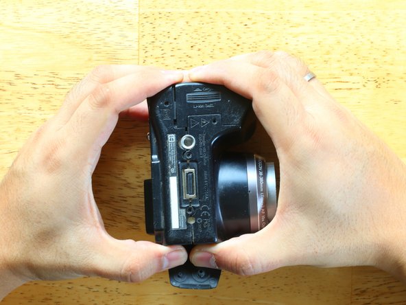

  2. Kodak EasyShare DX7590 Teardown, Body disassembly: crwdns2935265:02crwdnd2935265:01crwdnd2935265:03crwdne2935265:0 Kodak EasyShare DX7590 Teardown, Body disassembly: crwdns2935265:02crwdnd2935265:02crwdnd2935265:03crwdne2935265:0 Kodak EasyShare DX7590 Teardown, Body disassembly: crwdns2935265:02crwdnd2935265:03crwdnd2935265:03crwdne2935265:0
    • Unscrew the seven #00 Phillips body screws.
  3. Kodak EasyShare DX7590 Teardown: crwdns2935265:03crwdnd2935265:01crwdnd2935265:01crwdne2935265:0
    • Remove the rubbery port cover.
    • Gently tug on the cover. It is held on by two rubber tags which can be pushed into slots to be released.
  4. Kodak EasyShare DX7590 Teardown: crwdns2935265:04crwdnd2935265:01crwdnd2935265:03crwdne2935265:0 Kodak EasyShare DX7590 Teardown: crwdns2935265:04crwdnd2935265:02crwdnd2935265:03crwdne2935265:0 Kodak EasyShare DX7590 Teardown: crwdns2935265:04crwdnd2935265:03crwdnd2935265:03crwdne2935265:0
    • Firmly grip the camera body with both hands and wiggle. A seam should start appearing as shown.
    • Continue to work carefully around all four edges of the camera. There are no more screws holding the body together and the body does not use breakable tabs.
    • The two parts will still be connected via delicate cables. Do not pull the body completely apart.

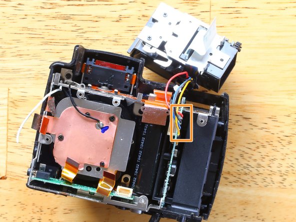

  5. Kodak EasyShare DX7590 Teardown, Cable release: crwdns2935265:05crwdnd2935265:01crwdnd2935265:03crwdne2935265:0 Kodak EasyShare DX7590 Teardown, Cable release: crwdns2935265:05crwdnd2935265:02crwdnd2935265:03crwdne2935265:0 Kodak EasyShare DX7590 Teardown, Cable release: crwdns2935265:05crwdnd2935265:03crwdnd2935265:03crwdne2935265:0
    • Gently push down on the two black cable release tabs. The flex-cable should be loose and detachable after that. Gently move the cable out of the socket.
    • Repeat the process for all the marked cables.
    • You can safely separate the front and back body halves after the cables are detached.

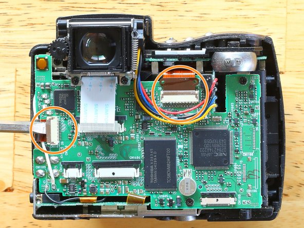

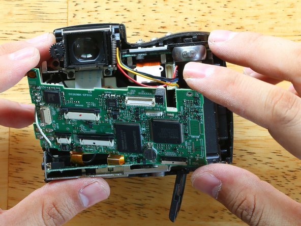

  6. Kodak EasyShare DX7590 Teardown, Main board review: crwdns2935265:06crwdnd2935265:01crwdnd2935265:01crwdne2935265:0
    • This is the main board. It handles tasks such as image processing, card reading/writing, and user input.
    • These 4 soldered points supply high voltage power from the power board to the flash unit.
    • This is the backup battery that is used to retain time and settings when the main power source is removed.
    • This is the remote flash trigger wire which connects to the remote flash port.
    • This flex-cable connects to the camera's electronic viewfinder (EVF).
    • This flex-cable connects to the camera's image sensor.
    • This flex-cable connects to the top button array as well as the light metering sensors.

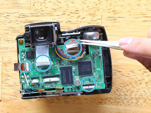

  7. Kodak EasyShare DX7590 Teardown, Main board removal: crwdns2935265:07crwdnd2935265:01crwdnd2935265:03crwdne2935265:0 Kodak EasyShare DX7590 Teardown, Main board removal: crwdns2935265:07crwdnd2935265:02crwdnd2935265:03crwdne2935265:0 Kodak EasyShare DX7590 Teardown, Main board removal: crwdns2935265:07crwdnd2935265:03crwdnd2935265:03crwdne2935265:0
    • Push both cable locks to release the back panel and EVF flex-cables.
    • Gently pry the tan bar up to release the sensor flex-cable. Repeat the procedure for the top panel flex-cable.
    • Gently move all cables out of their sockets.

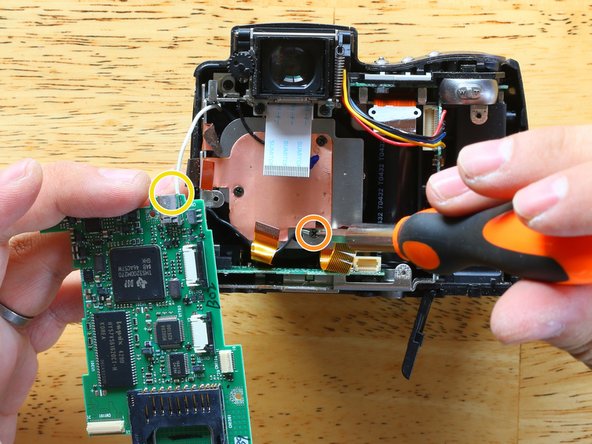

  8. Kodak EasyShare DX7590 Teardown: crwdns2935265:08crwdnd2935265:01crwdnd2935265:02crwdne2935265:0 Kodak EasyShare DX7590 Teardown: crwdns2935265:08crwdnd2935265:02crwdnd2935265:02crwdne2935265:0
    • Unscrew the three #00 Phillips holding the main board.
    • Lift the board gently away from the chassis.
    • Do not try to pull the board out! The board is still connected to the chassis with flex-cables as well as soldered wires.
  9. Kodak EasyShare DX7590 Teardown, Main board review II: crwdns2935265:09crwdnd2935265:01crwdnd2935265:01crwdne2935265:0
    • Let's take a moment to gaze at the back side of the main board:
    • SD card slot that is accessible externally.
    • Hynnix brand 32MB SDRAM.
    • Texas Instrument TMS320DM270 image processor. This is the brains of the camera.
    • Kodak proprietary USB connector.
    • Boy, the times sure have changed since this camera was top of the line...
  10. Kodak EasyShare DX7590 Teardown: crwdns2935265:010crwdnd2935265:01crwdnd2935265:02crwdne2935265:0 Kodak EasyShare DX7590 Teardown: crwdns2935265:010crwdnd2935265:02crwdnd2935265:02crwdne2935265:0
    • Push the locks up to release the lens servo motor cables. Gently remove the cables out of their sockets.
    • Unscrew the #00 Phillips holding a grounding wire against sensor shield.
    • At this point, you can choose to cut or de-solder the white wire from the board. It is the remote flash sync wire.
    • The main board is now completely detached from the chassis and can be safely removed.

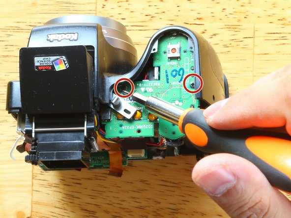

  11. Kodak EasyShare DX7590 Teardown, Upper panel disassembly: crwdns2935265:011crwdnd2935265:01crwdnd2935265:03crwdne2935265:0 Kodak EasyShare DX7590 Teardown, Upper panel disassembly: crwdns2935265:011crwdnd2935265:02crwdnd2935265:03crwdne2935265:0 Kodak EasyShare DX7590 Teardown, Upper panel disassembly: crwdns2935265:011crwdnd2935265:03crwdnd2935265:03crwdne2935265:0
    • Gently wiggle the top plastic plate off in the direction shown by the arrow.
    • Remove the exposed speaker and plastic buttons.
    • Slide a flat head/prybar underneath the silver latch and push up slightly to release the mechanical flash switch.

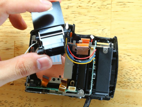

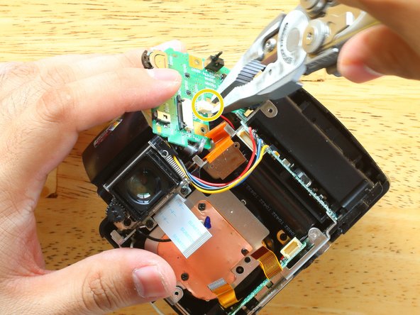

  12. Kodak EasyShare DX7590 Teardown: crwdns2935265:012crwdnd2935265:01crwdnd2935265:03crwdne2935265:0 Kodak EasyShare DX7590 Teardown: crwdns2935265:012crwdnd2935265:02crwdnd2935265:03crwdne2935265:0 Kodak EasyShare DX7590 Teardown: crwdns2935265:012crwdnd2935265:03crwdnd2935265:03crwdne2935265:0
    • Once the mechanical flash switch is loose, you can remove the top black plastic part.
    • Unscrew the two #00 Phillips that are securing the top board. The board should now be loose enough to flip but is still connected with wires.
    • Flip the board over. Look for a two-wire socket. Gently pull the plug out of the socket.
  13. Kodak EasyShare DX7590 Teardown: crwdns2935265:013crwdnd2935265:01crwdnd2935265:01crwdne2935265:0
    • Let's look at the top board. It doesn't contain anything too fancy:
    • Toggle switch, used for zooming in and out.
    • "Camera battery inserted" sensor switch.
    • Radial switch used for various menu options.
    • Main power button.
    • Tiny mysterious contact sensor (probably the "flash unit is up" sensor).

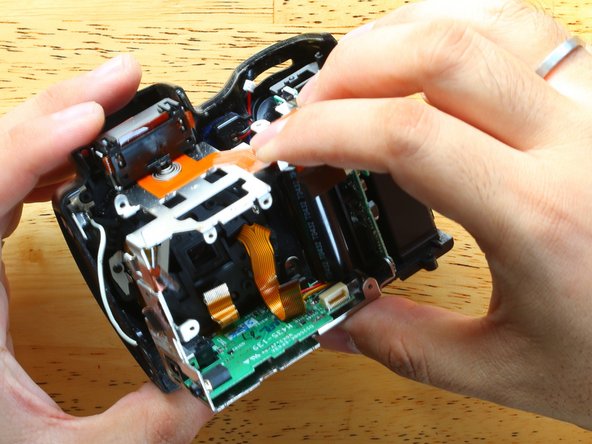

  14. Kodak EasyShare DX7590 Teardown, Electronic viewfinder (EVF) disassembly: crwdns2935265:014crwdnd2935265:01crwdnd2935265:03crwdne2935265:0 Kodak EasyShare DX7590 Teardown, Electronic viewfinder (EVF) disassembly: crwdns2935265:014crwdnd2935265:02crwdnd2935265:03crwdne2935265:0 Kodak EasyShare DX7590 Teardown, Electronic viewfinder (EVF) disassembly: crwdns2935265:014crwdnd2935265:03crwdnd2935265:03crwdne2935265:0
    • Unscrew the two #00 Phillips holding the EVF onto the chassis.
    • Swing the EVF module free from the chassis.
    • You can choose to cut or de-solder the four wires connecting the EVF module to the power board.
    • The EVF will be free once the four wires are disconnected.

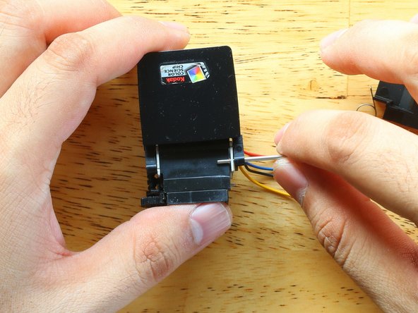

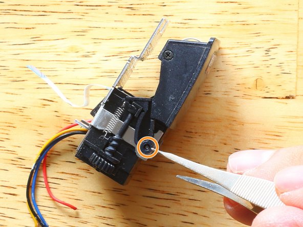

  15. Kodak EasyShare DX7590 Teardown: crwdns2935265:015crwdnd2935265:01crwdnd2935265:03crwdne2935265:0 Kodak EasyShare DX7590 Teardown: crwdns2935265:015crwdnd2935265:02crwdnd2935265:03crwdne2935265:0 Kodak EasyShare DX7590 Teardown: crwdns2935265:015crwdnd2935265:03crwdnd2935265:03crwdne2935265:0
    • Remove the three #00 Phillips and remove the metal plate.
    • Using a paper clip or tweezers, push the silver pin inwards.
    • Remove the pin to separate the flash from the EVF.

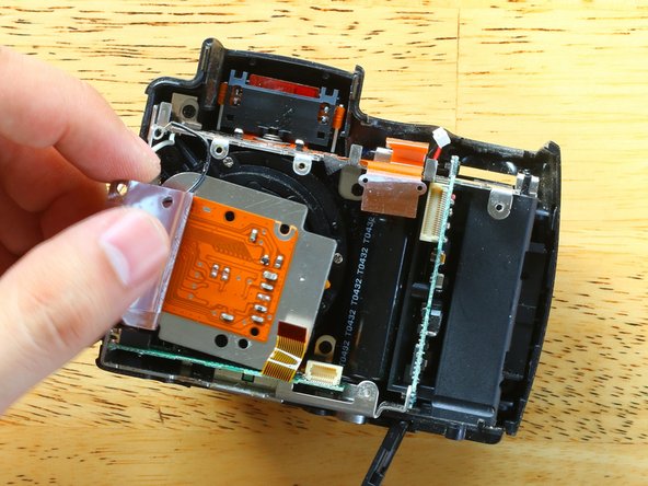

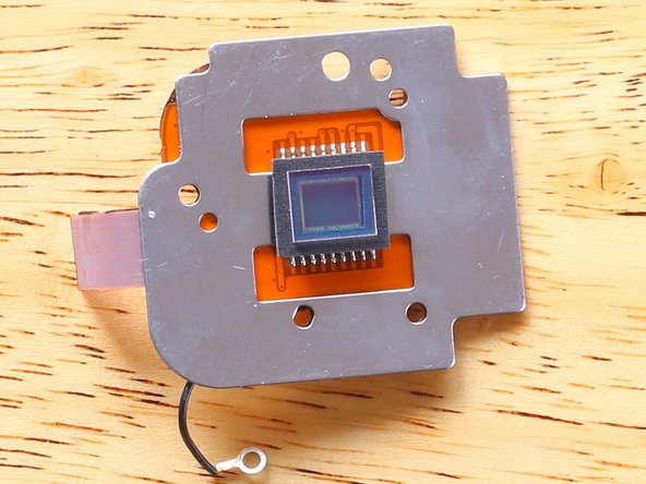

  17. Kodak EasyShare DX7590 Teardown, CCD image sensor disassembly: crwdns2935265:017crwdnd2935265:01crwdnd2935265:03crwdne2935265:0 Kodak EasyShare DX7590 Teardown, CCD image sensor disassembly: crwdns2935265:017crwdnd2935265:02crwdnd2935265:03crwdne2935265:0 Kodak EasyShare DX7590 Teardown, CCD image sensor disassembly: crwdns2935265:017crwdnd2935265:03crwdnd2935265:03crwdne2935265:0
    • Unscrew the two #00 Phillips holding the image sensor in place. You can now remove the sensor bracket.
    • You can peel the shield to see what's behind it- a circuit board that services the sensor.
    • This is the camera's eyeball (specifically the retina): a 1/2.5" sized CCD sensor with a 5 mega-pixel resolution. Light is focused onto this glassy plane of semiconductors, which convert the information into electrical signals.

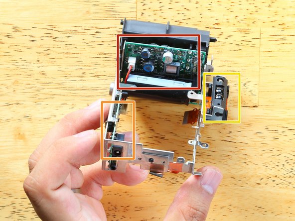

  18. Kodak EasyShare DX7590 Teardown, Power circuit disassembly: crwdns2935265:018crwdnd2935265:01crwdnd2935265:03crwdne2935265:0 Kodak EasyShare DX7590 Teardown, Power circuit disassembly: crwdns2935265:018crwdnd2935265:02crwdnd2935265:03crwdne2935265:0 Kodak EasyShare DX7590 Teardown, Power circuit disassembly: crwdns2935265:018crwdnd2935265:03crwdnd2935265:03crwdne2935265:0
    • Remove the three #00 Phillips holding the bracket to the plastic chassis.
    • Gently wiggle the bracket out of the chassis.
    • Here are a few things to note:
    • See the beefy capacitor? That, and the circuit it is connected to are used to generate high voltages necessary to discharge the flash bulb. Touching exposed contacts on that board can lead to electrical shock if the circuit has not been sufficiently de-energized.
    • This houses the light metering sensors as well as an auto-focus assist lamp.
    • This is also circuitry related to power regulation, possibly the portion which allows the camera to charge its battery on-board without the need for an external charger.

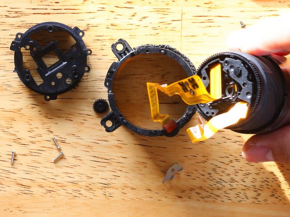

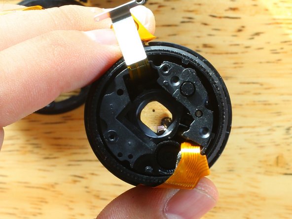

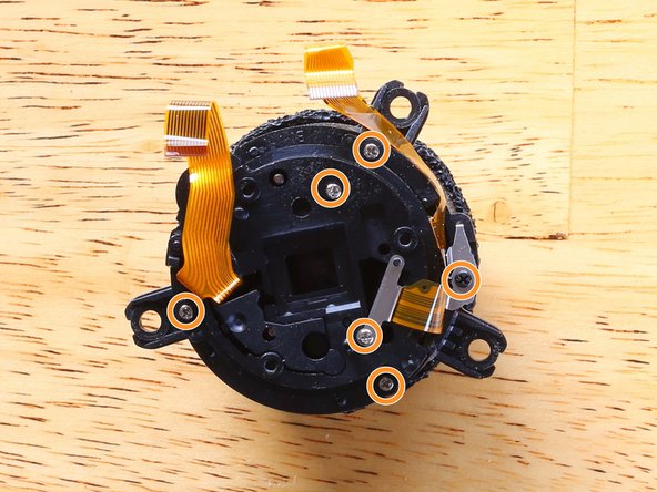

  19. Kodak EasyShare DX7590 Teardown, Lens assembly removal: crwdns2935265:019crwdnd2935265:01crwdnd2935265:03crwdne2935265:0 Kodak EasyShare DX7590 Teardown, Lens assembly removal: crwdns2935265:019crwdnd2935265:02crwdnd2935265:03crwdne2935265:0 Kodak EasyShare DX7590 Teardown, Lens assembly removal: crwdns2935265:019crwdnd2935265:03crwdnd2935265:03crwdne2935265:0
    • Unscrew the three #00 Phillips holding the lens assembly to the chassis. You can simply lift the lens assembly out once the screws are removed.
    • Remove the six #00 Phillips which hold the lens assembly together. Once that is done, you can remove the lens housing.
    • Here are some details on the lens:
    • It has a focal length of 6.32-63.2mm (38-380mm equivalent in 35mm size).
    • It has a f/2.8-3.7 aperture.
    • Its minimum focal distance is 23.6 inches.
