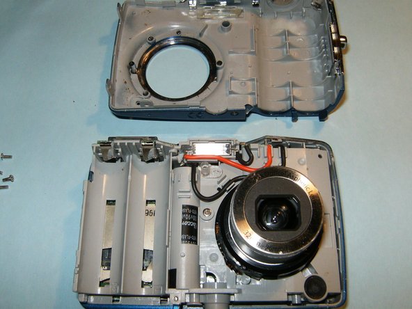

    • Remove the batteries and the memory card from the device.
    • Remove the two screws located at the bottom of the camera.
  2. Kodak EasyShare CD82 Lens Assembly Replacement: crwdns2935265:02crwdnd2935265:01crwdnd2935265:03crwdne2935265:0 Kodak EasyShare CD82 Lens Assembly Replacement: crwdns2935265:02crwdnd2935265:02crwdnd2935265:03crwdne2935265:0 Kodak EasyShare CD82 Lens Assembly Replacement: crwdns2935265:02crwdnd2935265:03crwdnd2935265:03crwdne2935265:0

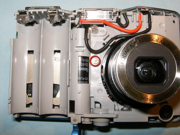

    • Remove the two screws on the side of the device, to left of the camera lens.
    • Remove the two screws on side of the device, to the right of the camera lens.
    • Pry the casing apart at the seems, starting at the battery compartment.

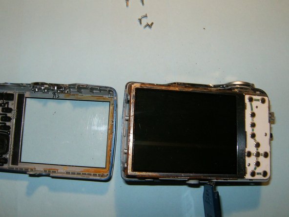

  3. Kodak EasyShare CD82 Lens Assembly Replacement: crwdns2935265:03crwdnd2935265:01crwdnd2935265:03crwdne2935265:0 Kodak EasyShare CD82 Lens Assembly Replacement: crwdns2935265:03crwdnd2935265:02crwdnd2935265:03crwdne2935265:0 Kodak EasyShare CD82 Lens Assembly Replacement: crwdns2935265:03crwdnd2935265:03crwdnd2935265:03crwdne2935265:0
    • Remove the front casing from the mid-frame, first.
    • Continue to remove the back casing from the mid-frame.
    • Do not remove the LCD screen from the device once it becomes visible.

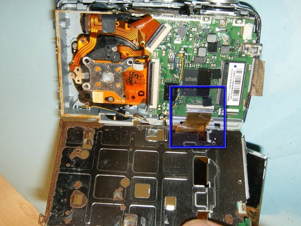

  4. Kodak EasyShare CD82 Lens Assembly Replacement: crwdns2935265:04crwdnd2935265:01crwdnd2935265:03crwdne2935265:0 Kodak EasyShare CD82 Lens Assembly Replacement: crwdns2935265:04crwdnd2935265:02crwdnd2935265:03crwdne2935265:0 Kodak EasyShare CD82 Lens Assembly Replacement: crwdns2935265:04crwdnd2935265:03crwdnd2935265:03crwdne2935265:0
    • Flip the LCD screen out of the holder from the top to reveal ribbon cable.
    • This camera had some obvious water damage..

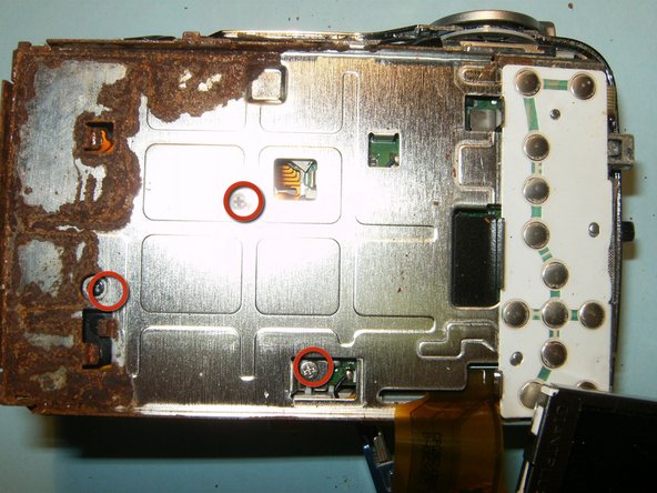

    • Remove the three screws from the LCD holder
    • Dislodge the LCD screen holder from the circuit board connector.
  5. Kodak EasyShare CD82 Lens Assembly Replacement: crwdns2935265:05crwdnd2935265:01crwdnd2935265:03crwdne2935265:0 Kodak EasyShare CD82 Lens Assembly Replacement: crwdns2935265:05crwdnd2935265:02crwdnd2935265:03crwdne2935265:0 Kodak EasyShare CD82 Lens Assembly Replacement: crwdns2935265:05crwdnd2935265:03crwdnd2935265:03crwdne2935265:0

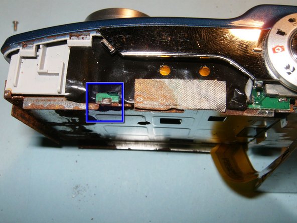

    • Disconnect the logic board from the frame on the right side of the device.
    • Remove the small ribbon cable, connecting the button board to the logic board, with small pair of tweezers or hemostat.
    • Remove the screw on the top right side of the device connecting the LCD screen holder to the midframe.
    • Move the black clip into the upward position to disconnect the cable.
    • You will now be able to remove the LCD screen and its holder from the device.

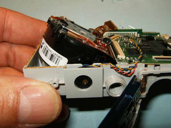

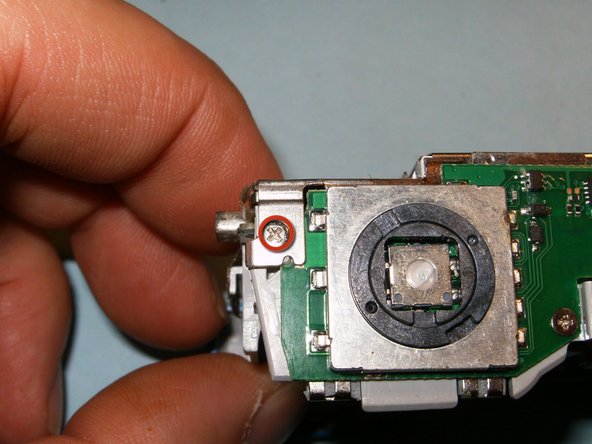

  6. Kodak EasyShare CD82 Lens Assembly Replacement: crwdns2935265:06crwdnd2935265:01crwdnd2935265:03crwdne2935265:0 Kodak EasyShare CD82 Lens Assembly Replacement: crwdns2935265:06crwdnd2935265:02crwdnd2935265:03crwdne2935265:0 Kodak EasyShare CD82 Lens Assembly Replacement: crwdns2935265:06crwdnd2935265:03crwdnd2935265:03crwdne2935265:0
    • Flip the black clips of the connectors into the opposite direction. Remove the lens and CCD cable.
    • Remove the two screws securing the lens to the midframe.
    • These are missing screws for the CCD sensor, lost in a previous dismantling.
    • Remove the single screw securing the lens to the mid-frame. The lens will now be loose.
    • Push the lens out of the frame in an angular direction, and remove.
