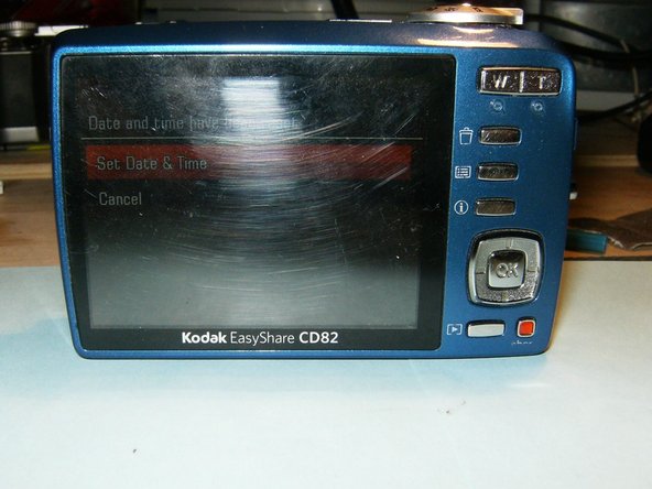

    • Remove the batteries and the memory card from the device.
    • Remove the 2 screws located at the bottom of the device.

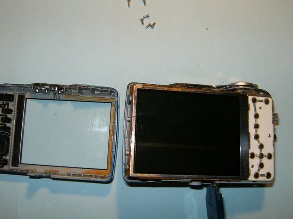

    • Remove the 2 screws on the side, to the left of the camera lens.
    • Remove the 2 screws on the side, to the right of the camera lens.
    • Pry the casing from the device starting at the battery compartment and following the seem around the camera.

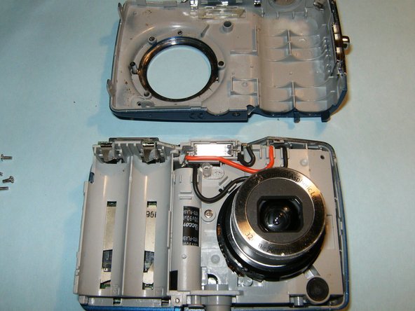

    • Remove the front panel from the device first, then remove the back panel.
    • Do not remove the LCD screen from the device once it becomes visible.

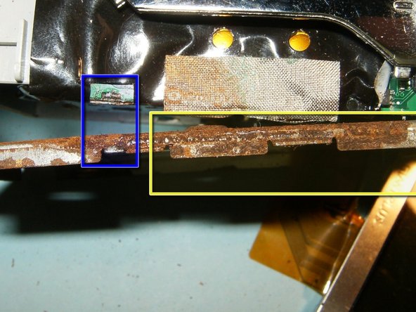

    • Flip the LCD screen away from the top of the device to reveal the ribbon cable.
    • This is water damage the has afflicted the camera.

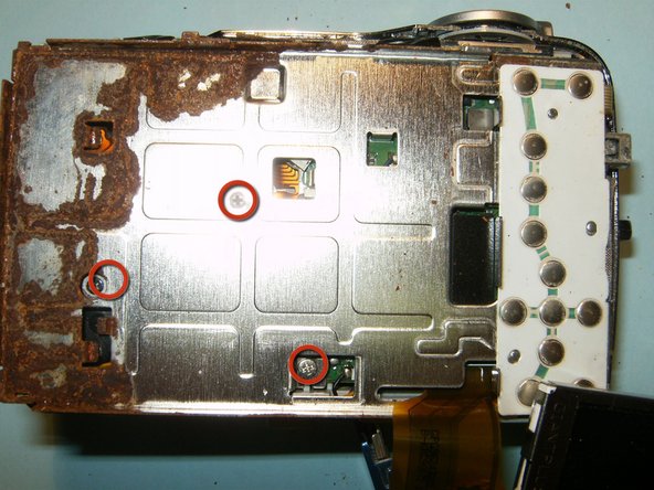

    • Disconnect the logic board from the right side of the frame.
    • Remove the small ribbon cable that is connecting the button panel to the logic board, using a small pair of tweezers or hemostat.

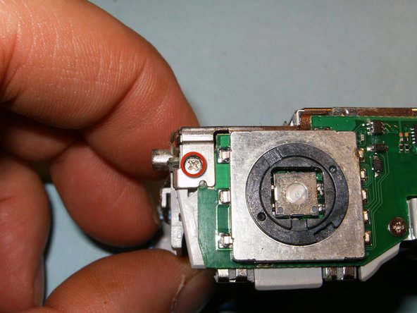

    • Remove the screw on the top right side of the device.
  6. Kodak EasyShare CD82 LCD Display Screen Replacement: crwdns2935265:06crwdnd2935265:01crwdnd2935265:02crwdne2935265:0 Kodak EasyShare CD82 LCD Display Screen Replacement: crwdns2935265:06crwdnd2935265:02crwdnd2935265:02crwdne2935265:0
    • Open the connector and move the black clip into the upward position, freeing the cable. Remove the LCD screen and the holder.
    • While the camera is disassembled, use isopropyl alcohol to remove rust and clean the device.
