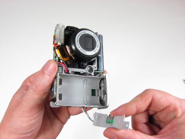

  4. Kodak EasyShare C913 Capacitor Replacement, Front Case: crwdns2935265:04crwdnd2935265:01crwdnd2935265:03crwdne2935265:0 Kodak EasyShare C913 Capacitor Replacement, Front Case: crwdns2935265:04crwdnd2935265:02crwdnd2935265:03crwdne2935265:0 Kodak EasyShare C913 Capacitor Replacement, Front Case: crwdns2935265:04crwdnd2935265:03crwdnd2935265:03crwdne2935265:0
    • Keep the battery door open
    • Firmly grasp the front casing and pull it away from the camera.

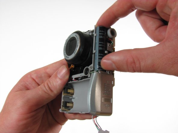

  5. Kodak EasyShare C913 Capacitor Replacement, Capacitor: crwdns2935265:05crwdnd2935265:01crwdnd2935265:02crwdne2935265:0 Kodak EasyShare C913 Capacitor Replacement, Capacitor: crwdns2935265:05crwdnd2935265:02crwdnd2935265:02crwdne2935265:0
    • Orient the camera with the lens facing you.
    • Use a Phillips #00 screwdriver to remove the one 2.2mm screw on the plastic bridge.
    • Lift the plastic bridge off and place it to the side.
  6. Kodak EasyShare C913 Capacitor Replacement: crwdns2935265:06crwdnd2935265:01crwdnd2935265:01crwdne2935265:0
    • Do not touch the capacitor contact points for any reason. This will result in a severe shock.

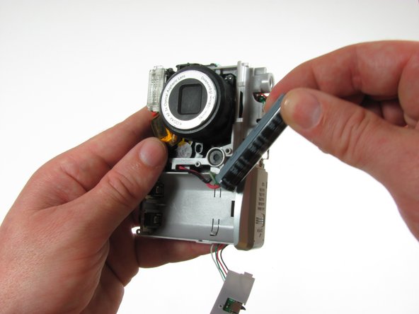

  7. Kodak EasyShare C913 Capacitor Replacement: crwdns2935265:07crwdnd2935265:01crwdnd2935265:03crwdne2935265:0 Kodak EasyShare C913 Capacitor Replacement: crwdns2935265:07crwdnd2935265:02crwdnd2935265:03crwdne2935265:0 Kodak EasyShare C913 Capacitor Replacement: crwdns2935265:07crwdnd2935265:03crwdnd2935265:03crwdne2935265:0
    • Grasp the capacitor, carefully remove it from its holder, and place it off to the side.
