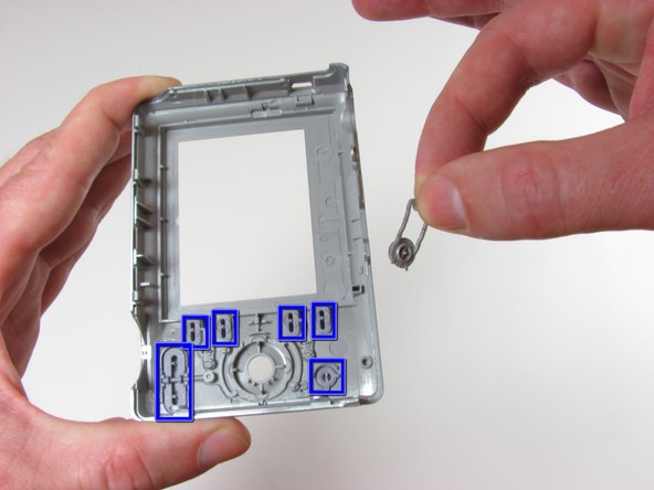

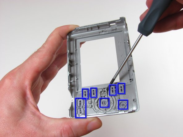

  4. Kodak EasyShare C913 Buttons Replacement, Buttons: crwdns2935265:04crwdnd2935265:01crwdnd2935265:03crwdne2935265:0 Kodak EasyShare C913 Buttons Replacement, Buttons: crwdns2935265:04crwdnd2935265:02crwdnd2935265:03crwdne2935265:0 Kodak EasyShare C913 Buttons Replacement, Buttons: crwdns2935265:04crwdnd2935265:03crwdnd2935265:03crwdne2935265:0
    • Use #00 screwdriver to pry off buttons.
