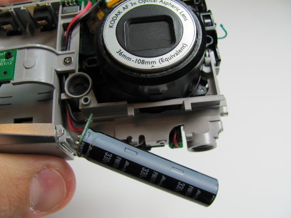

  5. Kodak EasyShare C713 Capacitor Replacement, Capacitor: crwdns2935265:05crwdnd2935265:01crwdnd2935265:02crwdne2935265:0 Kodak EasyShare C713 Capacitor Replacement, Capacitor: crwdns2935265:05crwdnd2935265:02crwdnd2935265:02crwdne2935265:0
    • To avoid an electric shock, do not to touch capacitor.
    • The capacitor is located underneath the lens.
    • It is held in place by 4 plastic snaps; it can be easily removed by pulling outward with your fingers.
  6. Kodak EasyShare C713 Capacitor Replacement: crwdns2935265:06crwdnd2935265:01crwdnd2935265:01crwdne2935265:0
    • Desolder points connecting capacitor to circuit board.
