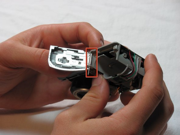

  5. Kodak EasyShare C713 Battery Door Replacement, Battery Door: crwdns2935265:05crwdnd2935265:01crwdnd2935265:02crwdne2935265:0 Kodak EasyShare C713 Battery Door Replacement, Battery Door: crwdns2935265:05crwdnd2935265:02crwdnd2935265:02crwdne2935265:0
    • Make sure the battery door is open.
    • Using a pair of tweezers, remove the metal rod at the junction of the battery door and the inner camera case.
    • This rod serves as the hinge for the door.
    • Make sure not to lose the battery door spring which may fall when the rod is removed.
