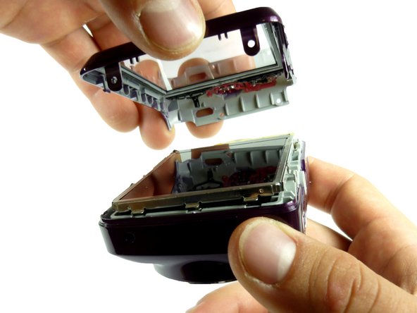

    • Once all the screws are out, remove the back panel.
    • The front panel does not need to be removed for replacing the LCD or the Lens.
    • To do this, start by removing the bottom of the panel.
  3. Kodak EasyShare C195 Lens Replacement: crwdns2935265:03crwdnd2935265:01crwdnd2935265:02crwdne2935265:0 Kodak EasyShare C195 Lens Replacement: crwdns2935265:03crwdnd2935265:02crwdnd2935265:02crwdne2935265:0
    • Once the bottom part is unhooked, unhook the top, and the whole panel should come off.
    • Be sure to gently pry the cover off.

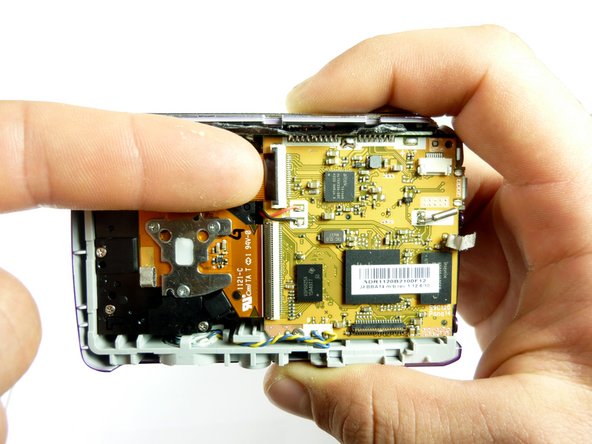

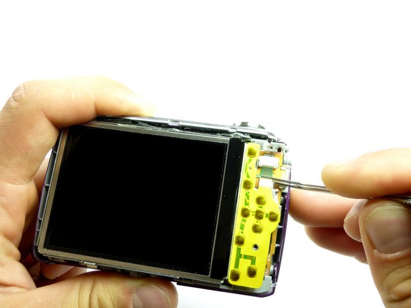

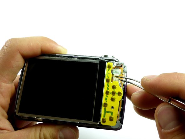

    • The next step is to remove the white ribbon on the upper right hand corner next to the LCD screen.
    • This can be done with or without tweezers.
    • The screen is still attached at the bottom, so do not take the screen off yet.

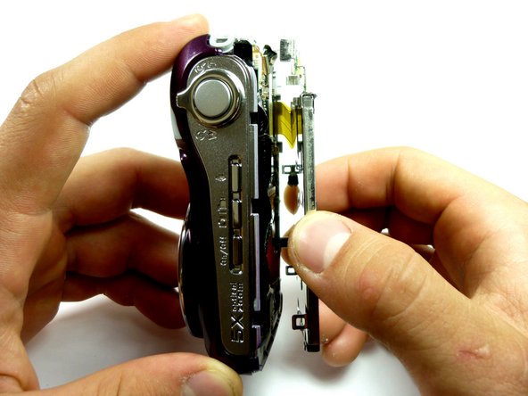

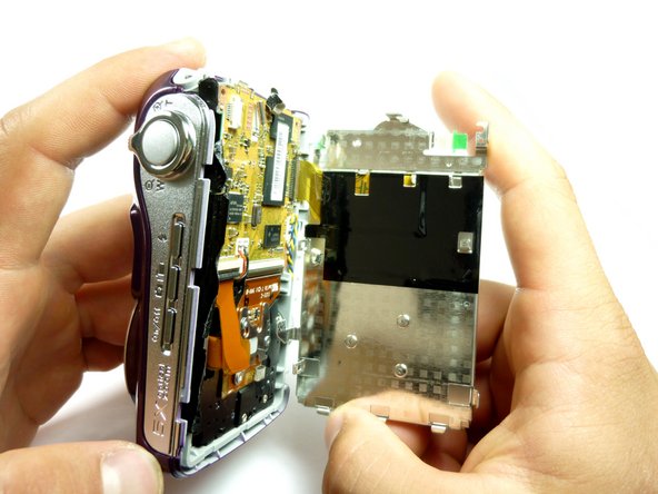

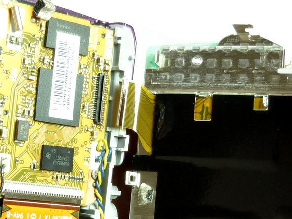

    • Carefully pry the top portion of the screen from the camera.
    • The screen is still attached to the camera via a yellow ribbon at the bottom of the camera.

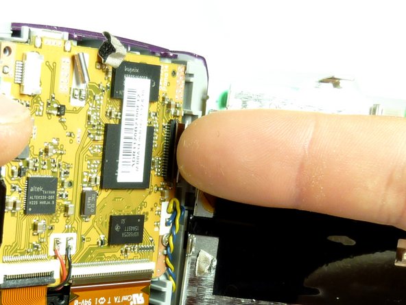

  7. Kodak EasyShare C195 Lens Replacement: crwdns2935265:07crwdnd2935265:01crwdnd2935265:03crwdne2935265:0 Kodak EasyShare C195 Lens Replacement: crwdns2935265:07crwdnd2935265:02crwdnd2935265:03crwdne2935265:0 Kodak EasyShare C195 Lens Replacement: crwdns2935265:07crwdnd2935265:03crwdnd2935265:03crwdne2935265:0

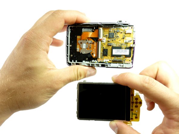

    • To remove the screen completely, push down on the rectangular tab indicated in the picture.
  8. Kodak EasyShare C195 Lens Replacement: crwdns2935265:08crwdnd2935265:01crwdnd2935265:02crwdne2935265:0 Kodak EasyShare C195 Lens Replacement: crwdns2935265:08crwdnd2935265:02crwdnd2935265:02crwdne2935265:0
    • The LCD screen is now completely removed from the rest of the camera.

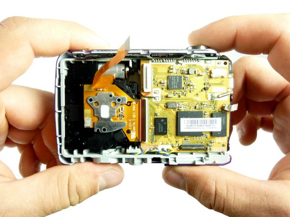

    • Now that the LCD screen as been completely removed, the internal lens can be removed.

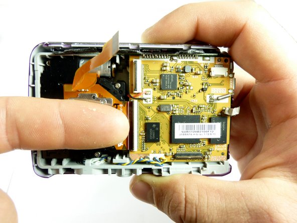

    • To do this, flip the two black tabs to the left of the yellow motherboard up.
  10. Kodak EasyShare C195 Lens Replacement: crwdns2935265:010crwdnd2935265:01crwdnd2935265:02crwdne2935265:0 Kodak EasyShare C195 Lens Replacement: crwdns2935265:010crwdnd2935265:02crwdnd2935265:02crwdne2935265:0

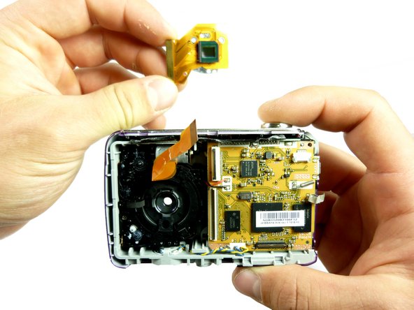

    • Once the tabs have been flipped, pull the orange tab out.
    • Next, use the #00 Philips head screwdriver to remove the five 4.5 mm screws to the left of the motherboard.
    • Remove the three Philips #00 3 mm screws on the silver metal plate directly behind the lens.
  11. Kodak EasyShare C195 Lens Replacement: crwdns2935265:011crwdnd2935265:01crwdnd2935265:02crwdne2935265:0 Kodak EasyShare C195 Lens Replacement: crwdns2935265:011crwdnd2935265:02crwdnd2935265:02crwdne2935265:0
    • Remove the internal lens from the camera.
    • The second picture shows what the camera should look like with out the internal lens attached.
