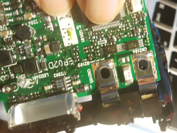

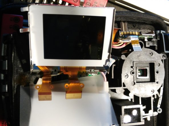

  4. Kodak DX3500 Digital Camera  Teardown, The Motherboard: crwdns2935265:04crwdnd2935265:01crwdnd2935265:03crwdne2935265:0 Kodak DX3500 Digital Camera  Teardown, The Motherboard: crwdns2935265:04crwdnd2935265:02crwdnd2935265:03crwdne2935265:0 Kodak DX3500 Digital Camera  Teardown, The Motherboard: crwdns2935265:04crwdnd2935265:03crwdnd2935265:03crwdne2935265:0
    • Well, here's the mainboard. Time to remove screws. There's lots of them, but first, remove the one holding the display in.
    • Flip the display up and pry the two connectors away from the mainboard.
    • Then finally pry the power connector away.

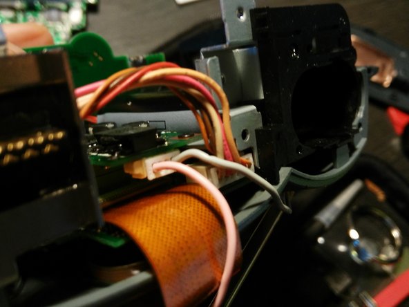

  5. Kodak DX3500 Digital Camera  Teardown, Disconnecting the rest of the mainboard: crwdns2935265:05crwdnd2935265:01crwdnd2935265:03crwdne2935265:0 Kodak DX3500 Digital Camera  Teardown, Disconnecting the rest of the mainboard: crwdns2935265:05crwdnd2935265:02crwdnd2935265:03crwdne2935265:0 Kodak DX3500 Digital Camera  Teardown, Disconnecting the rest of the mainboard: crwdns2935265:05crwdnd2935265:03crwdnd2935265:03crwdne2935265:0
    • Well, now go haywire and remove every screw you see in the mainboard.
    • Then flip the board up and remove the data ribbon cable. (The Orange one). You have to flip up the small brown tab and slide the cable out.
    • Remove another power cable
    • Flipping open the battery cover reveals one of the many hidden screws in this assembly!

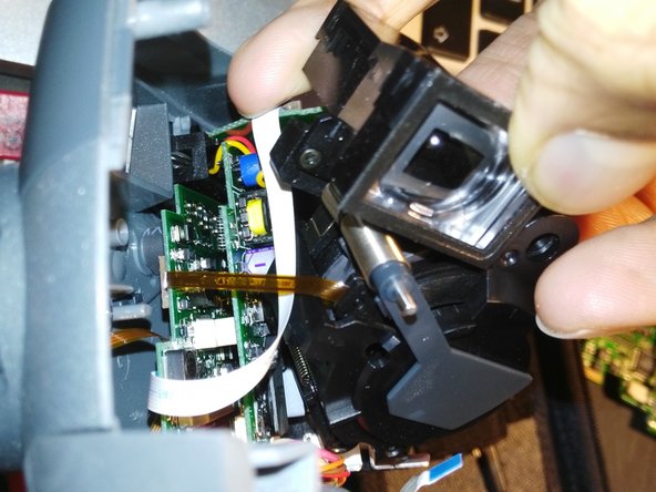

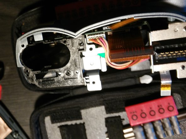

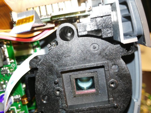

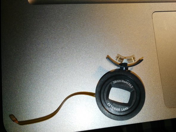

  6. Kodak DX3500 Digital Camera  Teardown, Lens + Peephole unit: crwdns2935265:06crwdnd2935265:01crwdnd2935265:03crwdne2935265:0 Kodak DX3500 Digital Camera  Teardown, Lens + Peephole unit: crwdns2935265:06crwdnd2935265:02crwdnd2935265:03crwdne2935265:0 Kodak DX3500 Digital Camera  Teardown, Lens + Peephole unit: crwdns2935265:06crwdnd2935265:03crwdnd2935265:03crwdne2935265:0
    • Time to remove all the screws again!
    • A couple of hidden ones, but once you get through them, you can pry the lens unit off of the camera, and take care with the ribbon cable here, it seems a bit delicate.

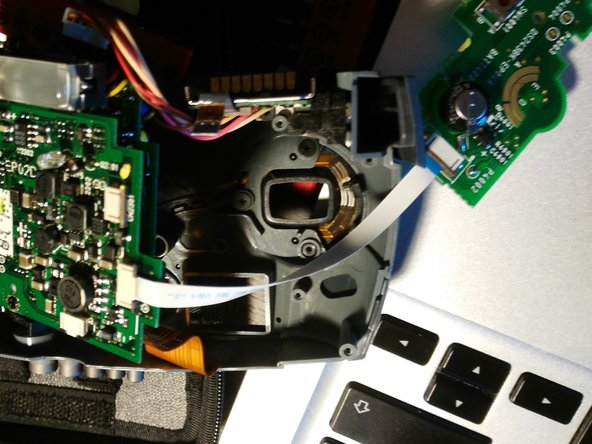

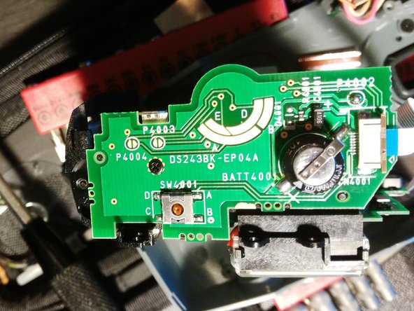

  7. Kodak DX3500 Digital Camera  Teardown, Secondary Board: crwdns2935265:07crwdnd2935265:01crwdnd2935265:03crwdne2935265:0 Kodak DX3500 Digital Camera  Teardown, Secondary Board: crwdns2935265:07crwdnd2935265:02crwdnd2935265:03crwdne2935265:0 Kodak DX3500 Digital Camera  Teardown, Secondary Board: crwdns2935265:07crwdnd2935265:03crwdnd2935265:03crwdne2935265:0
    • Easy peasy now, remove another power cable from the bottom.
    • Get to the next few screws as well.

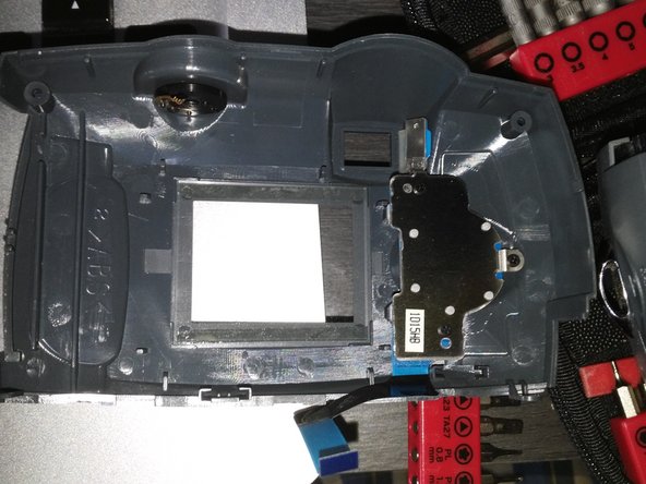

  8. Kodak DX3500 Digital Camera  Teardown, Rear Case: crwdns2935265:08crwdnd2935265:01crwdnd2935265:03crwdne2935265:0 Kodak DX3500 Digital Camera  Teardown, Rear Case: crwdns2935265:08crwdnd2935265:02crwdnd2935265:03crwdne2935265:0 Kodak DX3500 Digital Camera  Teardown, Rear Case: crwdns2935265:08crwdnd2935265:03crwdnd2935265:03crwdne2935265:0
    • By this point enough screws should've come out and you can pry the front case away and take care with the ribbon again.
    • Flip up to the top and unscrew the board connected to the power button. Should be just one screw.

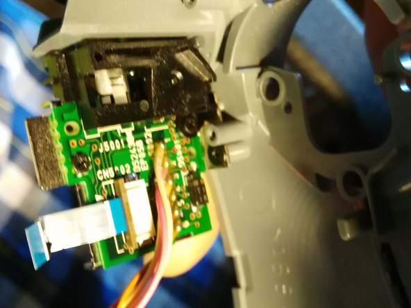

  9. Kodak DX3500 Digital Camera  Teardown, Front zoom unit: crwdns2935265:09crwdnd2935265:01crwdnd2935265:02crwdne2935265:0 Kodak DX3500 Digital Camera  Teardown, Front zoom unit: crwdns2935265:09crwdnd2935265:02crwdnd2935265:02crwdne2935265:0
    • Just disconnect the cable and then remove the 3 screws
    • It will come out in two parts.

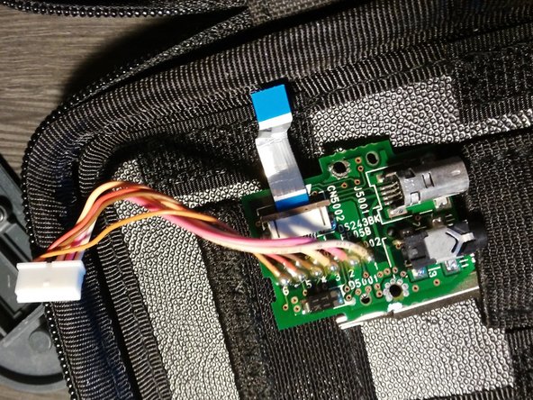

  10. Kodak DX3500 Digital Camera  Teardown, I/O: crwdns2935265:010crwdnd2935265:01crwdnd2935265:03crwdne2935265:0 Kodak DX3500 Digital Camera  Teardown, I/O: crwdns2935265:010crwdnd2935265:02crwdnd2935265:03crwdne2935265:0 Kodak DX3500 Digital Camera  Teardown, I/O: crwdns2935265:010crwdnd2935265:03crwdnd2935265:03crwdne2935265:0
    • Flip over to the video out/mini USB port
    • Once again unscrew a 3 more screws and voila! We have an I/O board!

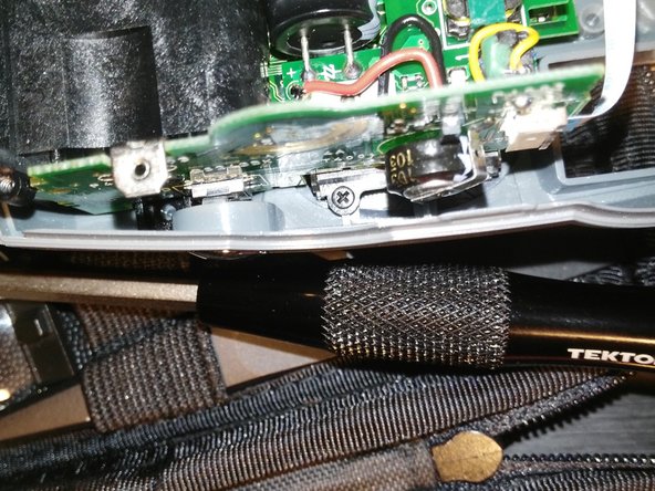

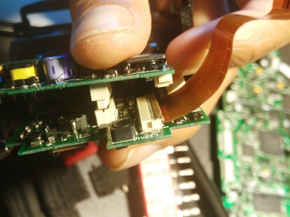

  11. Kodak DX3500 Digital Camera  Teardown, Disconnecting the last two boards: crwdns2935265:011crwdnd2935265:01crwdnd2935265:03crwdne2935265:0 Kodak DX3500 Digital Camera  Teardown, Disconnecting the last two boards: crwdns2935265:011crwdnd2935265:02crwdnd2935265:03crwdne2935265:0 Kodak DX3500 Digital Camera  Teardown, Disconnecting the last two boards: crwdns2935265:011crwdnd2935265:03crwdnd2935265:03crwdne2935265:0
    • Tired yet? You should be. So fiddly!
    • The boards are connected by 1 screw and a male/female connector between the two boards. Be careful here.
    • Unfortunately those hooks aren't just screwed in they're soldered on. You have to very carefully remove them from the battery unit.

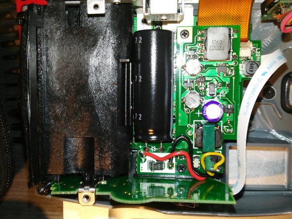

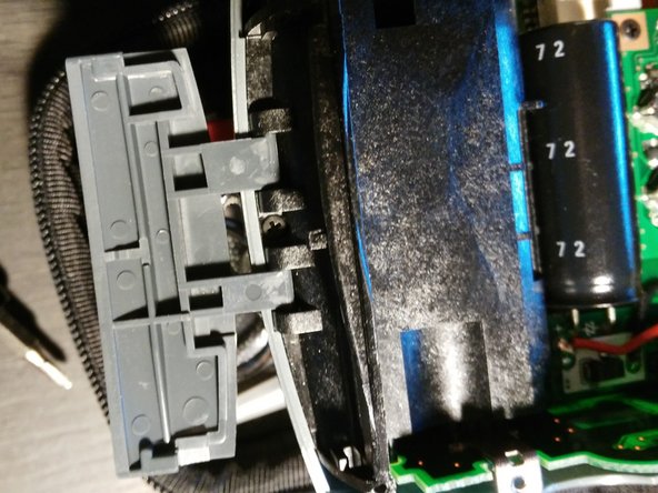

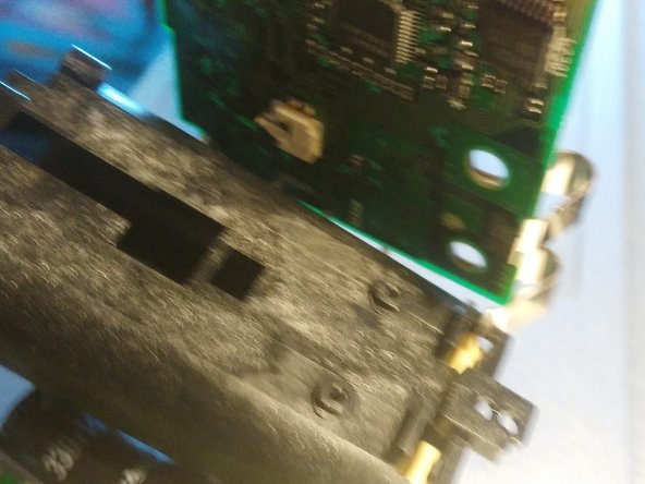

  12. Kodak DX3500 Digital Camera  Teardown, And we're done!: crwdns2935265:012crwdnd2935265:01crwdnd2935265:02crwdne2935265:0 Kodak DX3500 Digital Camera  Teardown, And we're done!: crwdns2935265:012crwdnd2935265:02crwdnd2935265:02crwdne2935265:0
    • All is done. You can disconnect other sub-units down a bit more, but it's pretty straightforward. If you have a faulty flash you probably need to replace this entire board unit.
    • Note the large capacitor connected to the flash. Be VERY careful around this, it can hold a large amount of charge which could discharge into you, if you touch the ends, or into other electronics it comes in touch with.
    • Thanks for reading. This is my very first teardown, and I admit not all the images are great, need to get used to one handed photo taking. Hope this helps someone. I'm guessing most digital camera's of this type will have similar components!

Congratulations on your first teardown. I hope you took care not to poke around the capacitor without first discharging it. It can hold a charge for a long time without a power source, and touching the terminals with your finger is not a pleasant experience (yes, it happened to me).
Kar Wong - crwdns2934203:0crwdne2934203:0
Thanks very much! I did make sure not to mess with the capacitor. I did remember enough about electronics to recognise it and immediately placed it away from anything sensitive! I think I'll update the teardown with that!
