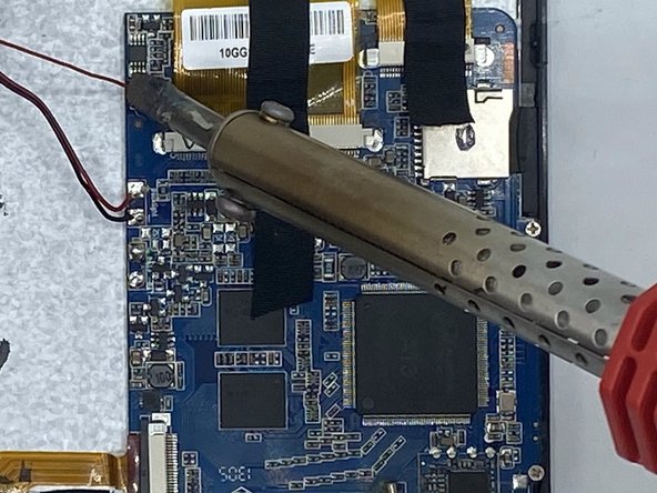

  3. Kocaso M750B Speaker Replacement: crwdns2935265:03crwdnd2935265:01crwdnd2935265:02crwdne2935265:0 Kocaso M750B Speaker Replacement: crwdns2935265:03crwdnd2935265:02crwdnd2935265:02crwdne2935265:0
    • Desolder the solder joints that connect the motherboard to the speaker.
    • The solder joints are connected to one red and one black cable.
    • When using the soldering iron, make sure to review the safety guidelines provided in the introduction. Work carefully and precisely to avoid any electrical discharge, puncture of the battery, or heating of the motherboard.
