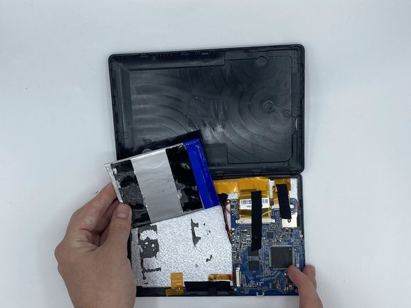

  1. Kocaso M750B Battery Replacement, Backplate: crwdns2935265:01crwdnd2935265:01crwdnd2935265:03crwdne2935265:0 Kocaso M750B Battery Replacement, Backplate: crwdns2935265:01crwdnd2935265:02crwdnd2935265:03crwdne2935265:0 Kocaso M750B Battery Replacement, Backplate: crwdns2935265:01crwdnd2935265:03crwdnd2935265:03crwdne2935265:0
    • Pry the edges of the tablet apart using an iFixit opening tool.
  2. Kocaso M750B Battery Replacement, Battery: crwdns2935265:02crwdnd2935265:01crwdnd2935265:01crwdne2935265:0
    • Desolder the solder joints that connect the motherboard to the battery.
    • The solder joints are connected to one red and one black cable.
    • When using the soldering iron, make sure to review the safety guidelines provided in the introduction. Work carefully and precisely to avoid any electrical discharge, puncture of the battery, or heating of the motherboard.
  3. Kocaso M750B Battery Replacement: crwdns2935265:03crwdnd2935265:01crwdnd2935265:02crwdne2935265:0 Kocaso M750B Battery Replacement: crwdns2935265:03crwdnd2935265:02crwdnd2935265:02crwdne2935265:0
    • Pry the battery up using the flat end of a spudger.
    • Remove the adhesive under the battery and carefully lift it up to replace it.
To reassemble your device, follow these instructions in reverse order, also to be very careful while removing the battery and use the safety tools.
