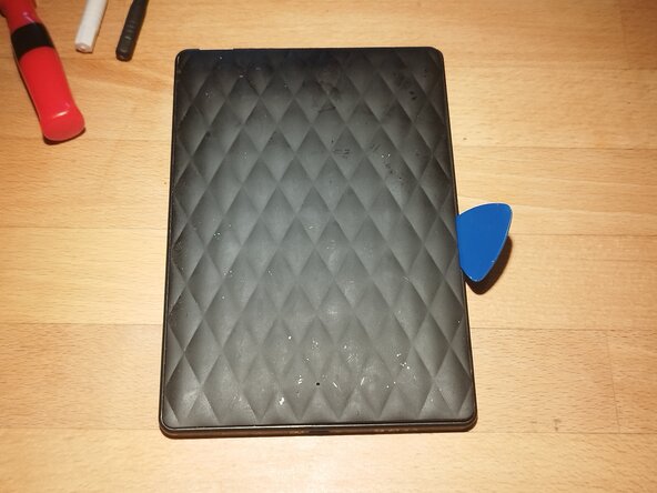

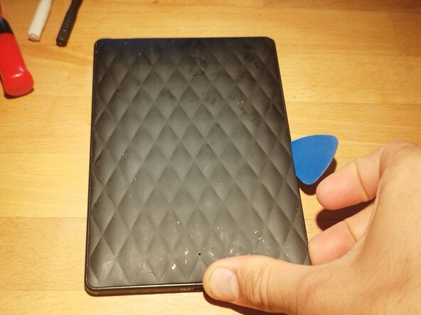

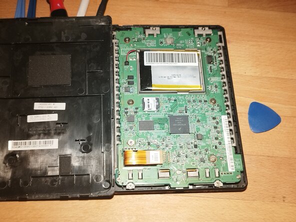

  1. Kobo Touch (N905B) E-Reader Screen Replacement, Pry open the Back cover: crwdns2935265:01crwdnd2935265:01crwdnd2935265:03crwdne2935265:0 Kobo Touch (N905B) E-Reader Screen Replacement, Pry open the Back cover: crwdns2935265:01crwdnd2935265:02crwdnd2935265:03crwdne2935265:0 Kobo Touch (N905B) E-Reader Screen Replacement, Pry open the Back cover: crwdns2935265:01crwdnd2935265:03crwdnd2935265:03crwdne2935265:0
    • Back cover is removed easily with a plastic pick or other instrument.

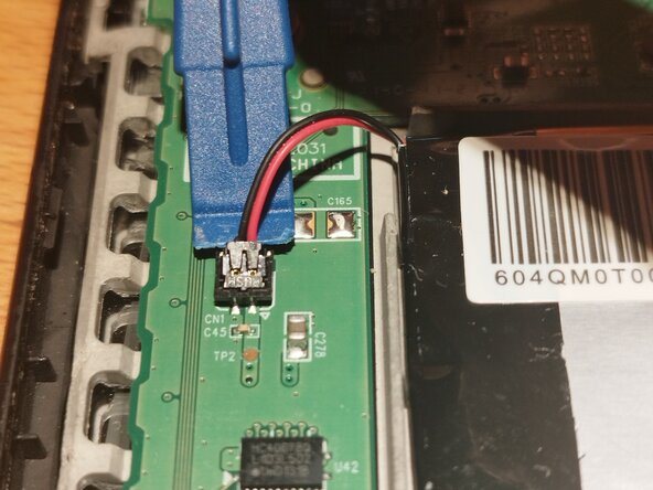

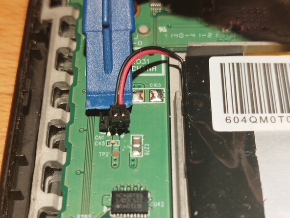

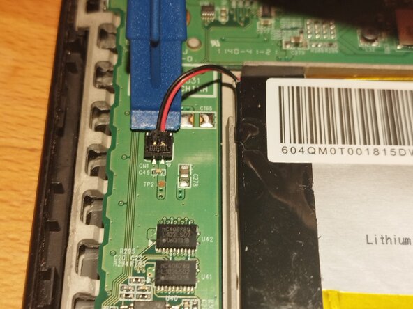

  2. Kobo Touch (N905B) E-Reader Screen Replacement, Remove Battery cable: crwdns2935265:02crwdnd2935265:01crwdnd2935265:03crwdne2935265:0 Kobo Touch (N905B) E-Reader Screen Replacement, Remove Battery cable: crwdns2935265:02crwdnd2935265:02crwdnd2935265:03crwdne2935265:0 Kobo Touch (N905B) E-Reader Screen Replacement, Remove Battery cable: crwdns2935265:02crwdnd2935265:03crwdnd2935265:03crwdne2935265:0
    • Use little force to lift up the battery cable from above.

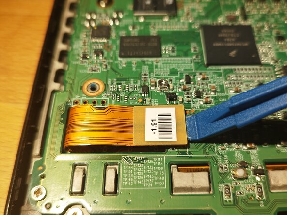

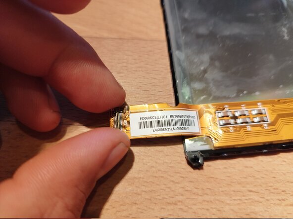

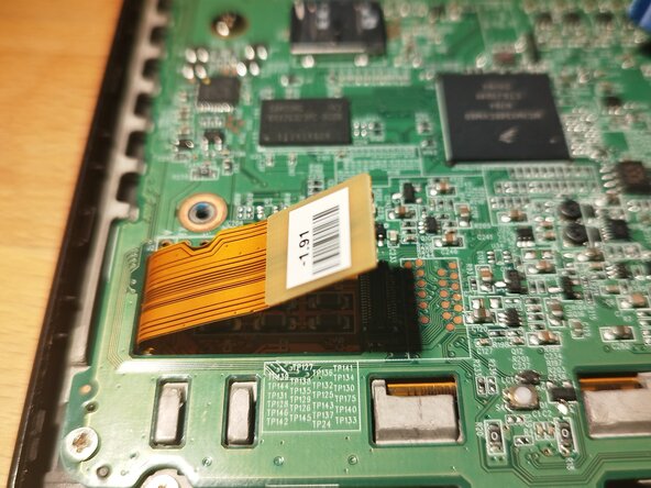

  3. Kobo Touch (N905B) E-Reader Screen Replacement, Disconnect screen: crwdns2935265:03crwdnd2935265:01crwdnd2935265:02crwdne2935265:0 Kobo Touch (N905B) E-Reader Screen Replacement, Disconnect screen: crwdns2935265:03crwdnd2935265:02crwdnd2935265:02crwdne2935265:0
    • Gently lift the flexcable.

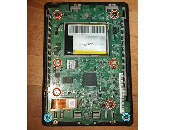

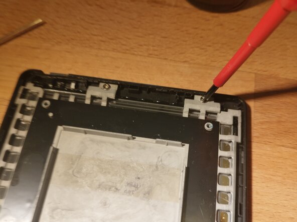

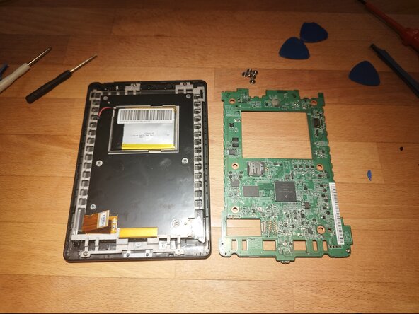

  4. Kobo Touch (N905B) E-Reader Screen Replacement, Unscrew the Board: crwdns2935265:04crwdnd2935265:01crwdnd2935265:01crwdne2935265:0
    • Unscrew the displayed srews.

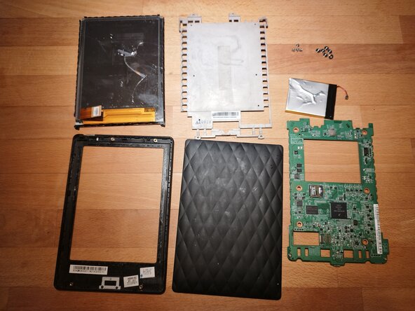

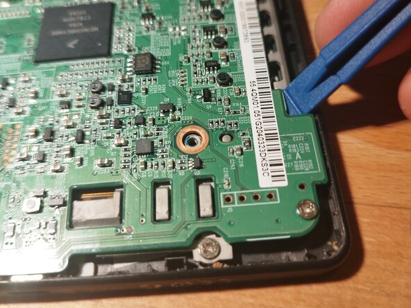

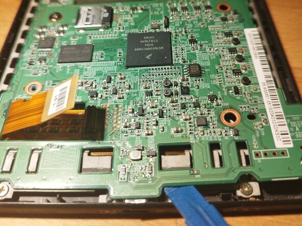

  5. Kobo Touch (N905B) E-Reader Screen Replacement, Lift up the Board: crwdns2935265:05crwdnd2935265:01crwdnd2935265:03crwdne2935265:0 Kobo Touch (N905B) E-Reader Screen Replacement, Lift up the Board: crwdns2935265:05crwdnd2935265:02crwdnd2935265:03crwdne2935265:0 Kobo Touch (N905B) E-Reader Screen Replacement, Lift up the Board: crwdns2935265:05crwdnd2935265:03crwdnd2935265:03crwdne2935265:0
    • Best to start on the top and then pull it out so that the USB plug does not block the way (not the way shown in the picture)

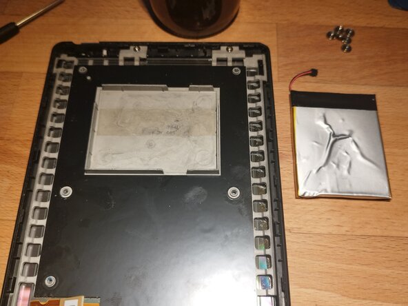

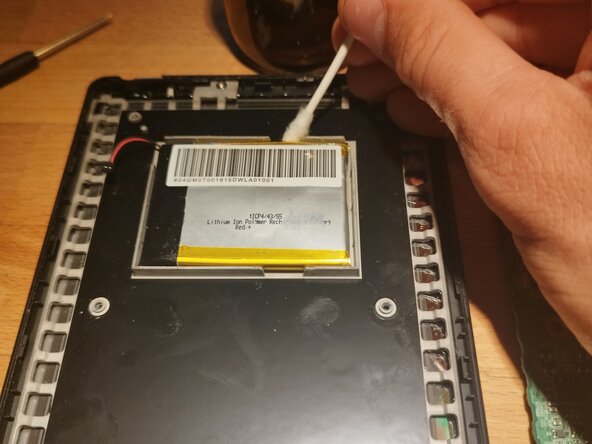

  6. Kobo Touch (N905B) E-Reader Screen Replacement, (Optional) Remove the Battery: crwdns2935265:06crwdnd2935265:01crwdnd2935265:02crwdne2935265:0 Kobo Touch (N905B) E-Reader Screen Replacement, (Optional) Remove the Battery: crwdns2935265:06crwdnd2935265:02crwdnd2935265:02crwdne2935265:0
    • Use Isopropyl alcoholo to loosen the glue.

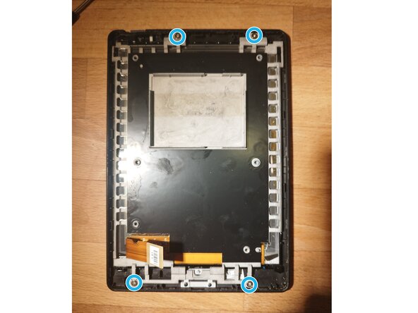

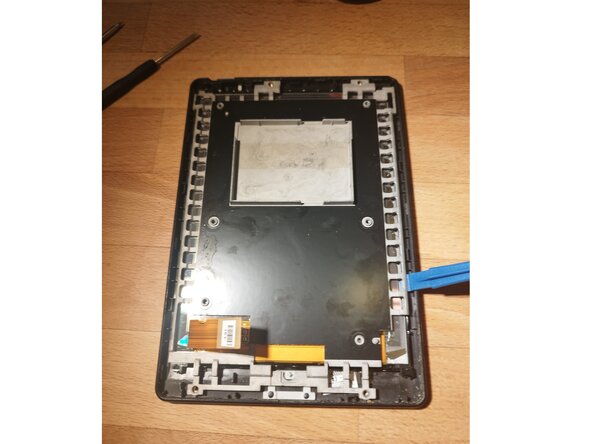

  7. Kobo Touch (N905B) E-Reader Screen Replacement, Unscrew back plate: crwdns2935265:07crwdnd2935265:01crwdnd2935265:02crwdne2935265:0 Kobo Touch (N905B) E-Reader Screen Replacement, Unscrew back plate: crwdns2935265:07crwdnd2935265:02crwdnd2935265:02crwdne2935265:0
    • Unscrew

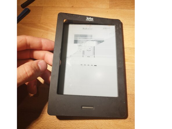

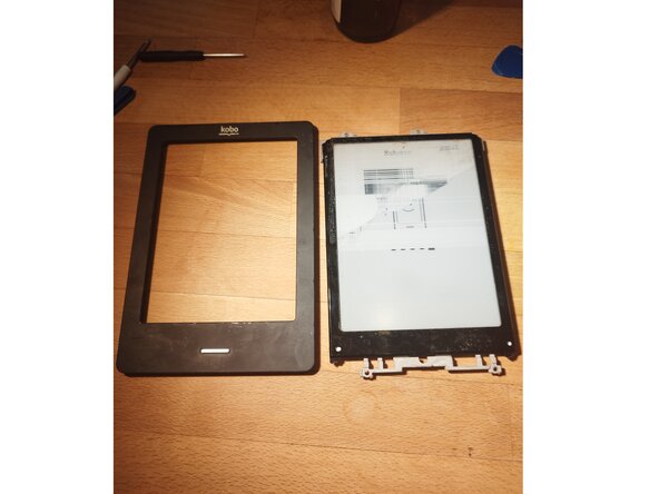

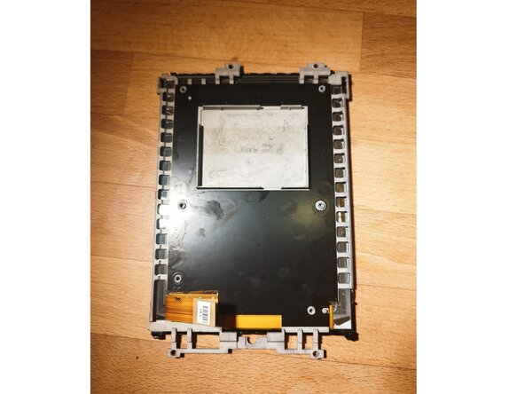

  8. Kobo Touch (N905B) E-Reader Screen Replacement, Remove plastic frame: crwdns2935265:08crwdnd2935265:01crwdnd2935265:03crwdne2935265:0 Kobo Touch (N905B) E-Reader Screen Replacement, Remove plastic frame: crwdns2935265:08crwdnd2935265:02crwdnd2935265:03crwdne2935265:0 Kobo Touch (N905B) E-Reader Screen Replacement, Remove plastic frame: crwdns2935265:08crwdnd2935265:03crwdnd2935265:03crwdne2935265:0
    • Use isoprop and push from the front to remove the frame.

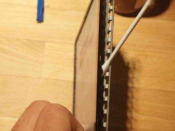

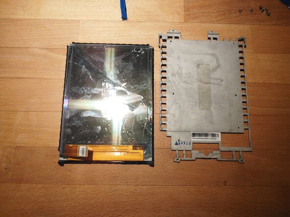

  9. Kobo Touch (N905B) E-Reader Screen Replacement, Remove screen from back panel: crwdns2935265:09crwdnd2935265:01crwdnd2935265:03crwdne2935265:0 Kobo Touch (N905B) E-Reader Screen Replacement, Remove screen from back panel: crwdns2935265:09crwdnd2935265:02crwdnd2935265:03crwdne2935265:0 Kobo Touch (N905B) E-Reader Screen Replacement, Remove screen from back panel: crwdns2935265:09crwdnd2935265:03crwdnd2935265:03crwdne2935265:0
    • Use a lot of isoprop. The glue strip is right in the middle .
    • If the screen is broken, remove all parts.
    • Here you can use force, as you will not damage anything any further as it already is.
