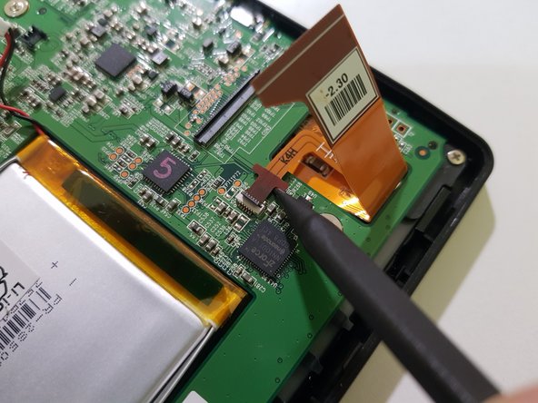

  5. Kobo Glo HD Display Replacement, Disconnect the display: crwdns2935265:05crwdnd2935265:01crwdnd2935265:02crwdne2935265:0 Kobo Glo HD Display Replacement, Disconnect the display: crwdns2935265:05crwdnd2935265:02crwdnd2935265:02crwdne2935265:0
    • Using the flat end of your spudger and a pair of flat-bladed tweezers, disconnect the display.

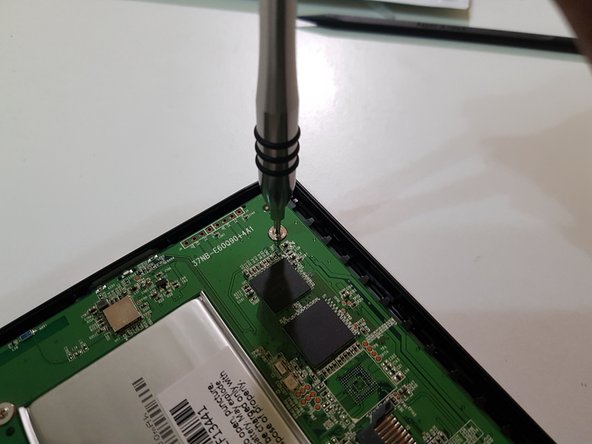

  7. Kobo Glo HD Display Replacement, Remove the mainboard: crwdns2935265:07crwdnd2935265:01crwdnd2935265:02crwdne2935265:0 Kobo Glo HD Display Replacement, Remove the mainboard: crwdns2935265:07crwdnd2935265:02crwdnd2935265:02crwdne2935265:0
    • Using your screwdriver with a PH00 tip, remove these screws and set them aside.

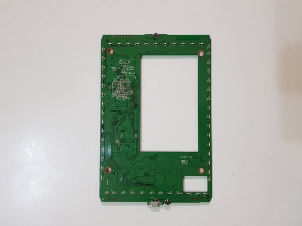

    • The mainboard has been removed.

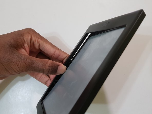

    • Now comes the start of the hard part.
    • Press down on the display to slowly free the display assembly from the bezel.
    • Don't press down too hard, as doing so may result in damage to the bezel.
    • This may take 5-15 minutes.

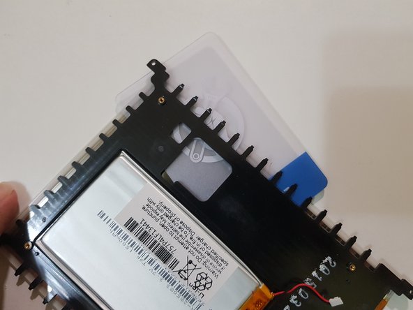

    • Use your thumb and finger on the rear-facing side of the mid-frame to pry apart part of the mid-frame, enough for you to slip your plastic card into.
    • Don't press on the battery, as doing so can puncture it, resulting in damage and serious injury.
    • Slip the card in between the EPD panel and mid-frame, and pull it around the perimeter and push it in and out, in order to break adhesive holding the former in place.
    • You may need to use your thumb and finger to bend the mid-frame and break some of the adhesive.

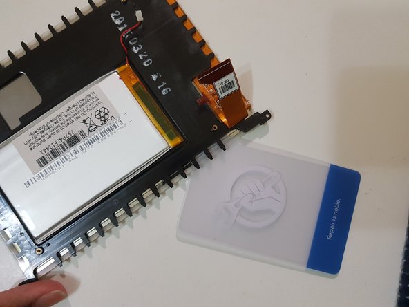

  15. Kobo Glo HD Display Replacement: crwdns2935265:015crwdnd2935265:01crwdnd2935265:01crwdne2935265:0
    • The EPD panel has been removed from the mid-frame.
