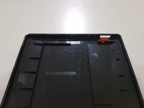

Kobo Aura Rear Cover Replacement
  1. Kobo Aura Rear Cover Replacement, Rear Cover: crwdns2935265:01crwdnd2935265:01crwdnd2935265:01crwdne2935265:0
    • If you haven't done so already, power off your eReader by sliding and holding the power switch for 3 seconds until the display refreshes to indicate that it has powered off.
    • When inserting your opening tools/picks at this step, do not insert it in the gap on the front, as this is where the front panel attaches.
    • Insert it on the side.
  2. Kobo Aura Rear Cover Replacement: crwdns2935265:02crwdnd2935265:01crwdnd2935265:03crwdne2935265:0 Kobo Aura Rear Cover Replacement: crwdns2935265:02crwdnd2935265:02crwdnd2935265:03crwdne2935265:0 Kobo Aura Rear Cover Replacement: crwdns2935265:02crwdnd2935265:03crwdnd2935265:03crwdne2935265:0
    • Insert your opening tool in the seam, starting at the top.
    • You could start at the side or the bottom, but you may find that the shell may be harder to pry apart.
    • If you're only using an opening tool:
    • Use the tool to undo clips located in these areas.
    • If you're using both an opening tool and pick:
    • Use the tool to open a gap small enough that you can slide a pick into
    • and slide it around the side to undo clips located in these areas.
    • You may have to switch between the opening tools and picks.
  3. Kobo Aura Rear Cover Replacement: crwdns2935265:03crwdnd2935265:01crwdnd2935265:03crwdne2935265:0 Kobo Aura Rear Cover Replacement: crwdns2935265:03crwdnd2935265:02crwdnd2935265:03crwdne2935265:0 Kobo Aura Rear Cover Replacement: crwdns2935265:03crwdnd2935265:03crwdnd2935265:03crwdne2935265:0
    • The rear cover can now come off.
    • The plastic cover for the power switch will usually fall inside or fall out. Don't lose this!
    • However, the plastic cover for the front light toggle is usually attached to the rear cover, unless it has broken off.

so i did successfully fix the device ( n514) , however, since the power button fell out ( the plastic cover) , it just does not go as smooth anymore, it works fine, but now i have to slide it to the right to power up/power down, but it doesn't automatically switch back, you have to manually switch it back to the left position.
anyone any idea what could have happened ? / or why i can't get it sorted out, i guess i probably missed something
peter huiskens - crwdns2934203:0crwdne2934203:0
En suivant cette méthode, j'ai cassé la petite pièce plastique de l'interrupteur.
Seule possibilité de la mettre hors veille est maintenant de faire un reset à chaque fois
Il faut commencer par le bas et non pas coté interrupteur pour l'ouvrir
