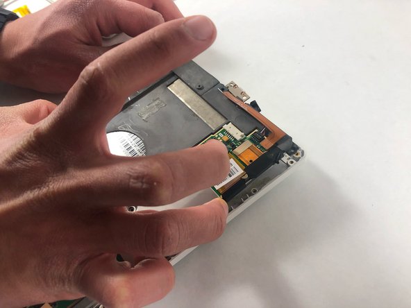

  5. Kobo Arc K107 Screen Replacement, Speaker: crwdns2935265:05crwdnd2935265:01crwdnd2935265:02crwdne2935265:0 Kobo Arc K107 Screen Replacement, Speaker: crwdns2935265:05crwdnd2935265:02crwdnd2935265:02crwdne2935265:0
    • Remove the screws that are attached to the grey plastic layer.
    • Remove the gray plastic layer.
  6. Kobo Arc K107 Screen Replacement: crwdns2935265:06crwdnd2935265:01crwdnd2935265:01crwdne2935265:0
    • Disconnect the speakers from the tablet.

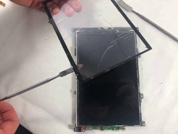

  7. Kobo Arc K107 Screen Replacement, Screen: crwdns2935265:07crwdnd2935265:01crwdnd2935265:02crwdne2935265:0 Kobo Arc K107 Screen Replacement, Screen: crwdns2935265:07crwdnd2935265:02crwdnd2935265:02crwdne2935265:0
    • Wedge a nylon spudger between the screen and the tablet.
    • Slide the spudger around the edges of the screen and remove it from the device.
