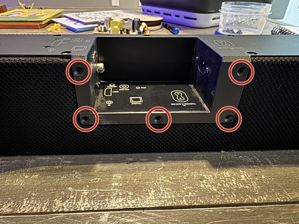

    • Remove 19 TR15 Torx screws from the rear of the unit and
    • Remove 5 TR15 Torx screws from the bottom.

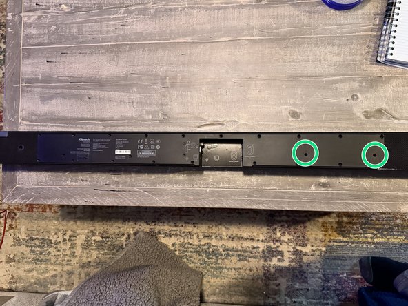

    • Remove 2 2.5" Allen Screws

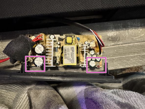

    • Using Pry Bar, Separate the rear panel from the main housing.
  3. Klipsch Cinema 600 Power Supply Replacement: crwdns2935265:03crwdnd2935265:01crwdnd2935265:02crwdne2935265:0 Klipsch Cinema 600 Power Supply Replacement: crwdns2935265:03crwdnd2935265:02crwdnd2935265:02crwdne2935265:0
    • Remove the Yellow Glue from the underside to remove the power supply from the right side of the rear panel.
    • From Here you can either Replace the Power Supply, using compatible components from amazon, or you can try and replace capacitors and see if that fixes the issue.
