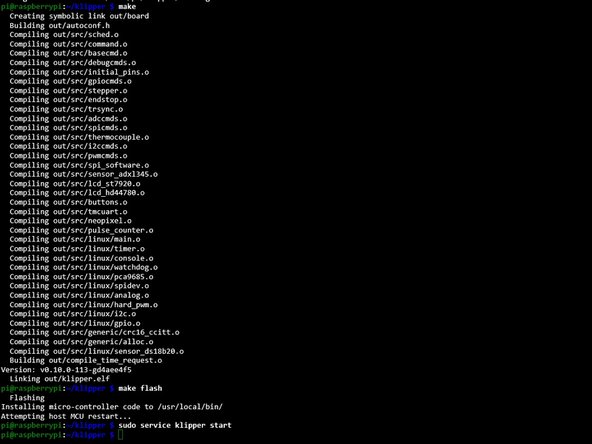

    • Enter make
    • Stop the Klipper service.
    • sudo service klipper stop

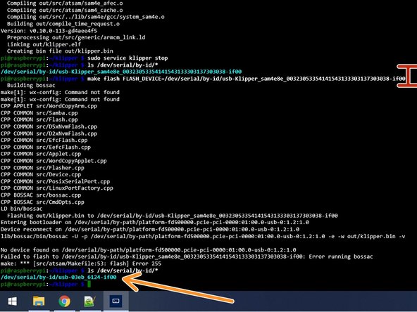

    • Get the Duet's serial ID # and copy it down.
    • ls /dev/serial/by-id/*
    • Enter "make flash FLASH_DEVICE=" and paste your serial after the =
    • If the flash fails usually this will place the board into a bootloader mode like original install does when you hit the erase pins. If this occurs please rerun ls /dev/serial/by-id/* so that you can get the correct serial
    • Enter make "flash FLASH_DEVICE=" and paste your serial your new serial after the =

    • Micro-Controller Architecture > Linux Process. Press esc than Y
    • make
    • make flash
    • sudo service klipper start
    • Verify klipper_host_mcu is in the tmp directory with ls /tmp/*

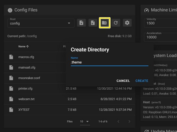

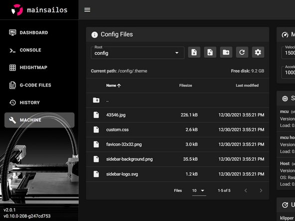

  14. Klipper+Mainsail Install, BLV Mainsail Theme: crwdns2935265:014crwdnd2935265:01crwdnd2935265:03crwdne2935265:0 Klipper+Mainsail Install, BLV Mainsail Theme: crwdns2935265:014crwdnd2935265:02crwdnd2935265:03crwdne2935265:0 Klipper+Mainsail Install, BLV Mainsail Theme: crwdns2935265:014crwdnd2935265:03crwdnd2935265:03crwdne2935265:0
    • Download the file and extract.
    • Under "machine" menu, click on the Gear icon and select the checkbox for "show hidden files".
    • Select "Create Directory".
    • In the name field enter “.theme” and select CREATE.
    • it has to be named as seen in the screenshot.
    • Select the newly created ".theme" folder. Upload all the files from the zip archive into .theme folder.
    • hit Ctrl+F5 and Enjoy.
