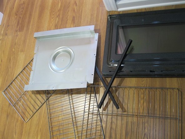

  1. KitchenAid electric oven thermal fuse Replacement, remove oven doors: crwdns2935265:01crwdnd2935265:01crwdnd2935265:02crwdne2935265:0 KitchenAid electric oven thermal fuse Replacement, remove oven doors: crwdns2935265:01crwdnd2935265:02crwdnd2935265:02crwdne2935265:0
    • Consult documentation (Use & Care Guide, Installation Instructions) for proper instruction. Follow this step only if you lack official documentation.
    • Insert door removal pins into each door hinge. If you lack paper documentation, then probably you lack door removal pins, so you can use nails.
    • Nails can scratch porcelain finish.
    • Close door, hinges will jam, continue closing until hinges tilt upward. Lift and remove door.
  2. KitchenAid electric oven thermal fuse Replacement, remove side trim: crwdns2935265:02crwdnd2935265:01crwdnd2935265:03crwdne2935265:0 KitchenAid electric oven thermal fuse Replacement, remove side trim: crwdns2935265:02crwdnd2935265:02crwdnd2935265:03crwdne2935265:0 KitchenAid electric oven thermal fuse Replacement, remove side trim: crwdns2935265:02crwdnd2935265:03crwdnd2935265:03crwdne2935265:0
    • Consult documentation (Installation Instructions) for proper instruction. Follow this step only if you lack official documentation.
    • Each side trim is fastened with one screw. Remove screws, pull bottom end of trim away from oven, slide trim downward, pull it off.
    • optional: Remove bottom trim, two screws, pull it off.

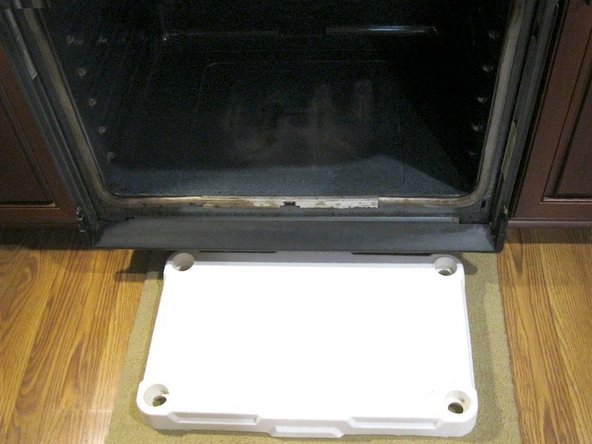

  3. KitchenAid electric oven thermal fuse Replacement, remove oven: crwdns2935265:03crwdnd2935265:01crwdnd2935265:03crwdne2935265:0 KitchenAid electric oven thermal fuse Replacement, remove oven: crwdns2935265:03crwdnd2935265:02crwdnd2935265:03crwdne2935265:0 KitchenAid electric oven thermal fuse Replacement, remove oven: crwdns2935265:03crwdnd2935265:03crwdnd2935265:03crwdne2935265:0
    • Each oven is secured to wall by two screws, one through each side mounting flange. Remove.
    • Set aside racks and pans and other weight.
    • Find something to use as a stand/pedestal/base for your oven. Use original shipping base and shipping feet if you have them. If you lack original documentation, then probably you lack shipping material, so you can use dimensional lumber or a shelf plank.
    • Pull out oven, set it on a temporary stand, orient it so you have full access to its rear.
