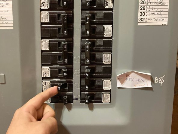

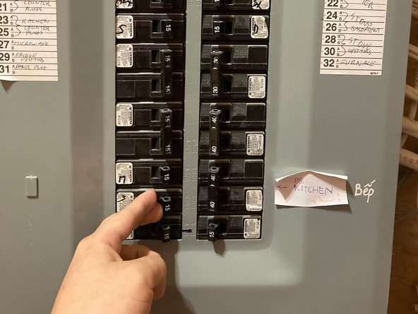

    • Unplug the dishwasher or shut off the house circuit breaker for the dishwasher.
    • To verify that power is disconnected, make sure that the control panel doesn’t light up when you press a control button or the power button.
  2. KitchenAid KUDS01DJSS0 Electronic Control Board Replacement: crwdns2935265:02crwdnd2935265:01crwdnd2935265:03crwdne2935265:0 KitchenAid KUDS01DJSS0 Electronic Control Board Replacement: crwdns2935265:02crwdnd2935265:02crwdnd2935265:03crwdne2935265:0 KitchenAid KUDS01DJSS0 Electronic Control Board Replacement: crwdns2935265:02crwdnd2935265:03crwdnd2935265:03crwdne2935265:0

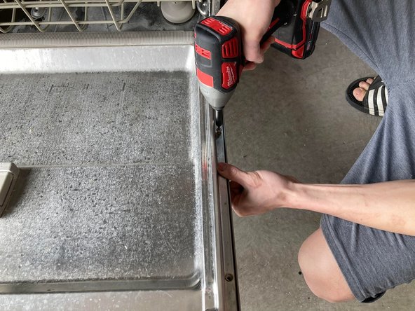

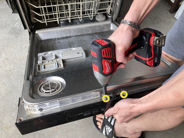

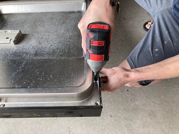

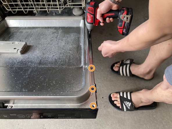

  3. KitchenAid KUDS01DJSS0 Electronic Control Board Replacement: crwdns2935265:03crwdnd2935265:01crwdnd2935265:03crwdne2935265:0 KitchenAid KUDS01DJSS0 Electronic Control Board Replacement: crwdns2935265:03crwdnd2935265:02crwdnd2935265:03crwdne2935265:0 KitchenAid KUDS01DJSS0 Electronic Control Board Replacement: crwdns2935265:03crwdnd2935265:03crwdnd2935265:03crwdne2935265:0
    • Remove the four screws from each side of the dishwasher door (eight screws total).
    • Removing the three screws from each side of the dishwasher (six screws total).
    • Support the outer door panel with one hand as you remove the final two screws at the top of the dishwasher door.
    • There are total of sixteen (16) screws.

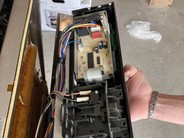

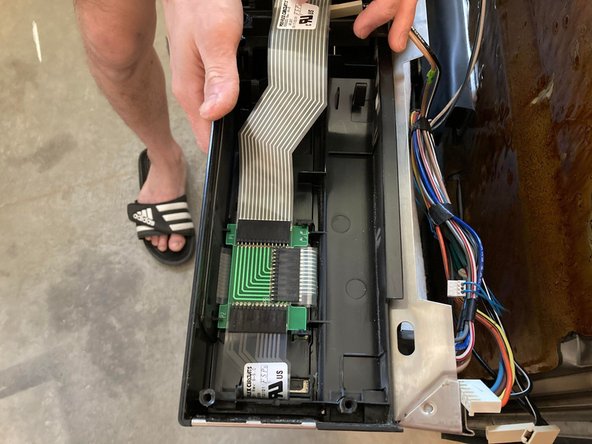

  4. KitchenAid KUDS01DJSS0 Electronic Control Board Replacement: crwdns2935265:04crwdnd2935265:01crwdnd2935265:02crwdne2935265:0 KitchenAid KUDS01DJSS0 Electronic Control Board Replacement: crwdns2935265:04crwdnd2935265:02crwdnd2935265:02crwdne2935265:0
    • Use your hands to pull off the outer door panel with the control panel.
  5. KitchenAid KUDS01DJSS0 Electronic Control Board Replacement: crwdns2935265:05crwdnd2935265:01crwdnd2935265:02crwdne2935265:0 KitchenAid KUDS01DJSS0 Electronic Control Board Replacement: crwdns2935265:05crwdnd2935265:02crwdnd2935265:02crwdne2935265:0

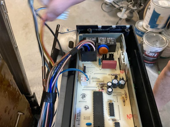

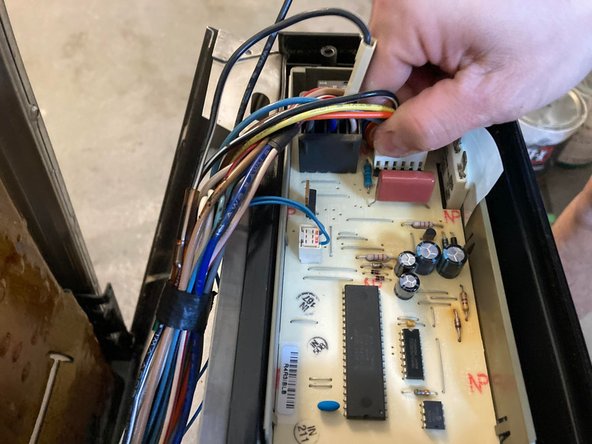

    • Disconnect the two white outer wires by pulling them out.
    • The two white connectors have the same size and are close together.
    • Use one hand to hold the control panel while disconnecting the electrical connections from the old board.

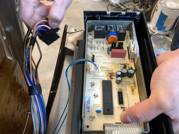

  6. KitchenAid KUDS01DJSS0 Electronic Control Board Replacement: crwdns2935265:06crwdnd2935265:01crwdnd2935265:03crwdne2935265:0 KitchenAid KUDS01DJSS0 Electronic Control Board Replacement: crwdns2935265:06crwdnd2935265:02crwdnd2935265:03crwdne2935265:0 KitchenAid KUDS01DJSS0 Electronic Control Board Replacement: crwdns2935265:06crwdnd2935265:03crwdnd2935265:03crwdne2935265:0

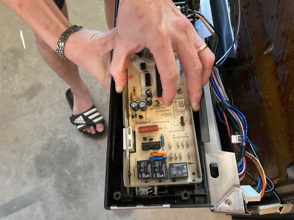

    • Remove the white rectangular connector that has six colored wires connected to it.
  7. KitchenAid KUDS01DJSS0 Electronic Control Board Replacement: crwdns2935265:07crwdnd2935265:01crwdnd2935265:02crwdne2935265:0 KitchenAid KUDS01DJSS0 Electronic Control Board Replacement: crwdns2935265:07crwdnd2935265:02crwdnd2935265:02crwdne2935265:0

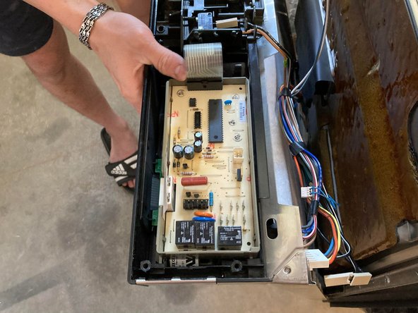

    • Use one hand to hold the control panel while detaching the black connector.
    • The black connector is the main connector to the control board.
  8. KitchenAid KUDS01DJSS0 Electronic Control Board Replacement: crwdns2935265:08crwdnd2935265:01crwdnd2935265:03crwdne2935265:0 KitchenAid KUDS01DJSS0 Electronic Control Board Replacement: crwdns2935265:08crwdnd2935265:02crwdnd2935265:03crwdne2935265:0 KitchenAid KUDS01DJSS0 Electronic Control Board Replacement: crwdns2935265:08crwdnd2935265:03crwdnd2935265:03crwdne2935265:0

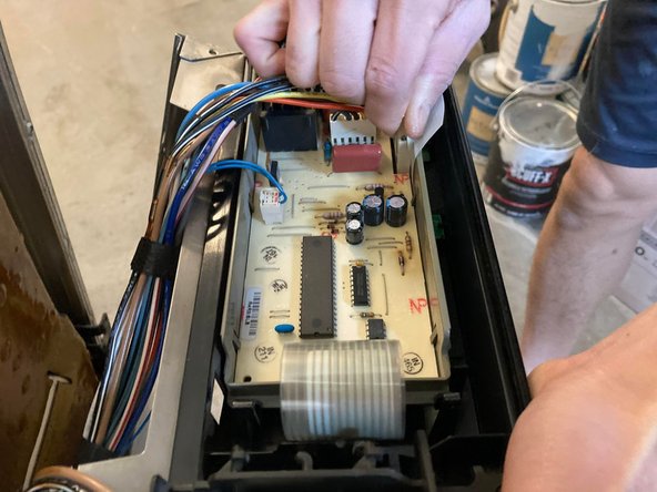

    • Detach the white and gray ribbon cable attached to the black connector.
  9. KitchenAid KUDS01DJSS0 Electronic Control Board Replacement: crwdns2935265:09crwdnd2935265:01crwdnd2935265:02crwdne2935265:0 KitchenAid KUDS01DJSS0 Electronic Control Board Replacement: crwdns2935265:09crwdnd2935265:02crwdnd2935265:02crwdne2935265:0

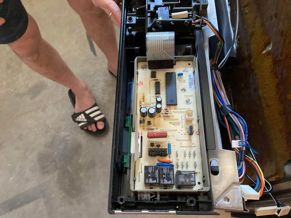

    • Use your hands to pull the electronic control board out the mounting slots.

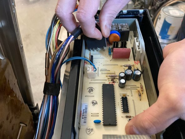

  10. KitchenAid KUDS01DJSS0 Electronic Control Board Replacement: crwdns2935265:010crwdnd2935265:01crwdnd2935265:02crwdne2935265:0 KitchenAid KUDS01DJSS0 Electronic Control Board Replacement: crwdns2935265:010crwdnd2935265:02crwdnd2935265:02crwdne2935265:0
    • Push the new electronic control board into the mounting slots.
    • Slide it to the right to engage the locking tab until you hear a click.
  11. KitchenAid KUDS01DJSS0 Electronic Control Board Replacement: crwdns2935265:011crwdnd2935265:01crwdnd2935265:02crwdne2935265:0 KitchenAid KUDS01DJSS0 Electronic Control Board Replacement: crwdns2935265:011crwdnd2935265:02crwdnd2935265:02crwdne2935265:0
    • Reconnect the black connector wires to the new electronic control board.
  12. KitchenAid KUDS01DJSS0 Electronic Control Board Replacement: crwdns2935265:012crwdnd2935265:01crwdnd2935265:03crwdne2935265:0 KitchenAid KUDS01DJSS0 Electronic Control Board Replacement: crwdns2935265:012crwdnd2935265:02crwdnd2935265:03crwdne2935265:0 KitchenAid KUDS01DJSS0 Electronic Control Board Replacement: crwdns2935265:012crwdnd2935265:03crwdnd2935265:03crwdne2935265:0

  15. KitchenAid KUDS01DJSS0 Electronic Control Board Replacement: crwdns2935265:015crwdnd2935265:01crwdnd2935265:03crwdne2935265:0 KitchenAid KUDS01DJSS0 Electronic Control Board Replacement: crwdns2935265:015crwdnd2935265:02crwdnd2935265:03crwdne2935265:0 KitchenAid KUDS01DJSS0 Electronic Control Board Replacement: crwdns2935265:015crwdnd2935265:03crwdnd2935265:03crwdne2935265:0
    • Connect the dishwasher and reset the circuit breaker for your house to restore electricity.
    • To verify that power is connected, make sure that the control panel does light up when you press a control button or the power button.
