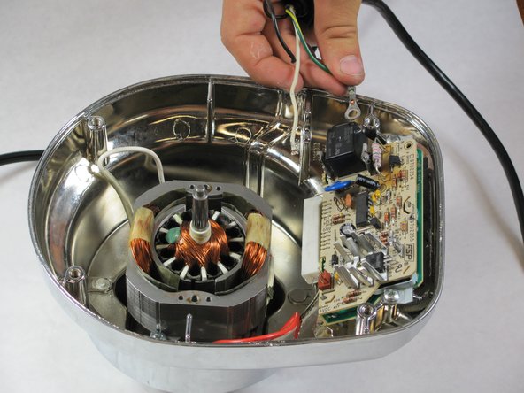

  4. KitchenAid KSB5CR Power Cable Replacement, Detaching the White and Black Wires: crwdns2935265:04crwdnd2935265:01crwdnd2935265:02crwdne2935265:0 KitchenAid KSB5CR Power Cable Replacement, Detaching the White and Black Wires: crwdns2935265:04crwdnd2935265:02crwdnd2935265:02crwdne2935265:0
    • Be gentle with the knife or you will break the circuit board.
    • Slide the knife into the metal loop holding the insulation before the white copper wire, and wiggle it back and forth until it loosens.
    • Pull the wire out from the metal loop that you loosened.
    • Repeat this process with the black copper wire.
  5. KitchenAid KSB5CR Power Cable Replacement, Detatching the Green Wire: crwdns2935265:05crwdnd2935265:01crwdnd2935265:02crwdne2935265:0 KitchenAid KSB5CR Power Cable Replacement, Detatching the Green Wire: crwdns2935265:05crwdnd2935265:02crwdnd2935265:02crwdne2935265:0
    • Using the Phillips #2 screwdriver, remove the #8 Phillips 6mm screw to which the green wire is attached.
