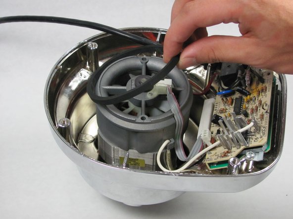

  3. KitchenAid KSB5CR Motor Replacement, Removing the Fan Chassis Part 1: crwdns2935265:03crwdnd2935265:01crwdnd2935265:03crwdne2935265:0 KitchenAid KSB5CR Motor Replacement, Removing the Fan Chassis Part 1: crwdns2935265:03crwdnd2935265:02crwdnd2935265:03crwdne2935265:0 KitchenAid KSB5CR Motor Replacement, Removing the Fan Chassis Part 1: crwdns2935265:03crwdnd2935265:03crwdnd2935265:03crwdne2935265:0
    • Remove the two #5 Phillips 95 mm machine screws using the Phillips #2 screwdriver.
    • Remove the rubber O-ring by lifting it up.
    • Remove the ribbon cable from the chassis by lifting it up.

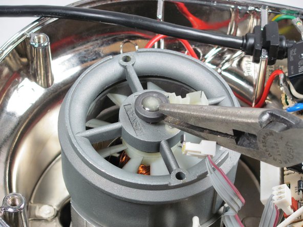

  6. KitchenAid KSB5CR Motor Replacement, Removing the Metal Cap: crwdns2935265:06crwdnd2935265:01crwdnd2935265:01crwdne2935265:0
    • Use the needle nose pliers to turn the coupling clockwise to loosen it.
