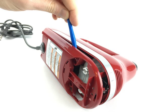

      • Insert the back of a plastic opening tool into one of the beater holes
      • Apply force to pull the circular plastic part off.
      • If necessary, use the other side of the plastic opening tool to pry the circular plastic part off.

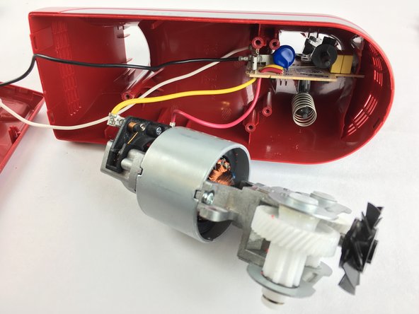

      • Using a Phillips 2 screwdriver, remove the three 20.0mm screws holding the motor assembly in place.
      • Use your hands to remove the motor assembly and circuit board.
    5. KitchenAid KHM512ER Power Cord Replacement: crwdns2935265:05crwdnd2935265:01crwdnd2935265:03crwdne2935265:0 KitchenAid KHM512ER Power Cord Replacement: crwdns2935265:05crwdnd2935265:02crwdnd2935265:03crwdne2935265:0 KitchenAid KHM512ER Power Cord Replacement: crwdns2935265:05crwdnd2935265:03crwdnd2935265:03crwdne2935265:0
      • Firmly grip the circuit board, and using pliers, remove the black and white power cord connectors from the circuit board.
      • Some force may be required. Be careful not to cut yourself on any electrical components.
    6. KitchenAid KHM512ER Power Cord Replacement: crwdns2935265:06crwdnd2935265:01crwdnd2935265:03crwdne2935265:0 KitchenAid KHM512ER Power Cord Replacement: crwdns2935265:06crwdnd2935265:02crwdnd2935265:03crwdne2935265:0 KitchenAid KHM512ER Power Cord Replacement: crwdns2935265:06crwdnd2935265:03crwdnd2935265:03crwdne2935265:0
      • Using a plastic opening tool, remove the white plastic clip on the inside of the bottom plastic piece.
      • Once it's loose, remove it with your fingers.
      • Pull the power cord through the hole.
