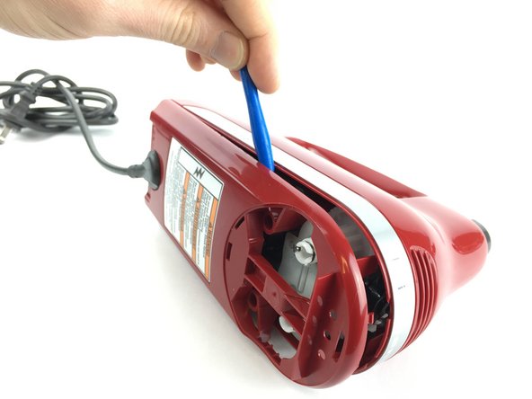

      • Insert the back of a plastic opening tool into one of the beater holes.
      • Apply force to pull the circular plastic part off.
      • If necessary, use the other side of the plastic opening tool to pry the circular plastic part off.

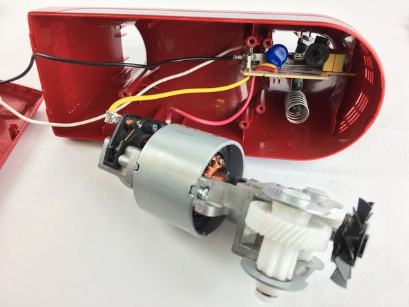

      • Using a Phillips 2 screwdriver, remove the three 20.0mm screws holding the motor assembly in place.
      • Use your hands to remove the motor assembly.

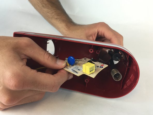

      • Use your hands to hold the eject button from one side while using the other hand to remove the circuit board.
    5. KitchenAid KHM512ER Eject Button Spring Replacement: crwdns2935265:05crwdnd2935265:01crwdnd2935265:02crwdne2935265:0 KitchenAid KHM512ER Eject Button Spring Replacement: crwdns2935265:05crwdnd2935265:02crwdnd2935265:02crwdne2935265:0
      • Remove the eject button by pulling it from the inside of the mixer.
      • Hold the eject button firmly while pulling out the spring.
