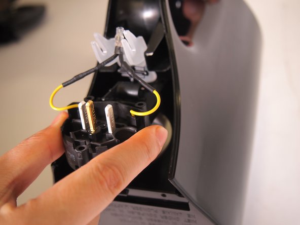

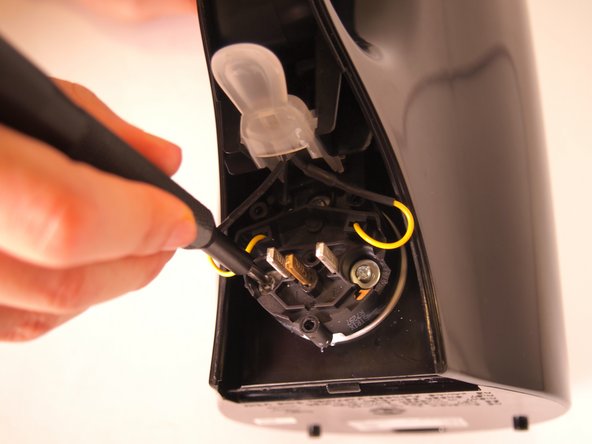

    • Turn the kettle over to the back of the handle.
    • Remove three 10 mm screws connecting the switch circuit to the heating element with a Phillips #2 screwdriver.
    • The heating element should disconnect, allowing you to remove it.

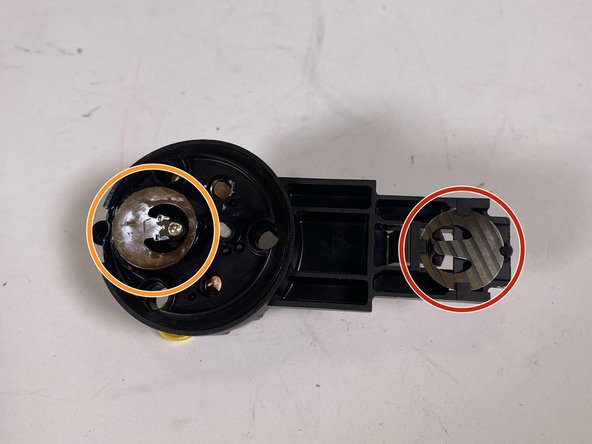

  5. Kitchen Smith 1.7L Electric Kettle KE01102-UL Disassembly: crwdns2935265:05crwdnd2935265:01crwdnd2935265:02crwdne2935265:0 Kitchen Smith 1.7L Electric Kettle KE01102-UL Disassembly: crwdns2935265:05crwdnd2935265:02crwdnd2935265:02crwdne2935265:0
    • The pronged power element, removed in Step 4, will have a dry-heating safety feature on the opposite side.
    • This switch turns off the kettle once steam is detected, indicating the water is boiling.
    • This is the boil dry protection switch.

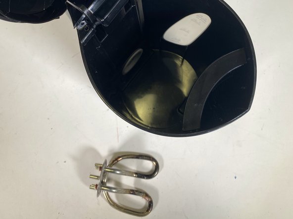

  6. Kitchen Smith 1.7L Electric Kettle KE01102-UL Disassembly: crwdns2935265:06crwdnd2935265:01crwdnd2935265:02crwdne2935265:0 Kitchen Smith 1.7L Electric Kettle KE01102-UL Disassembly: crwdns2935265:06crwdnd2935265:02crwdnd2935265:02crwdne2935265:0
    • The inner heating element can now be removed after the completion of Step 4.

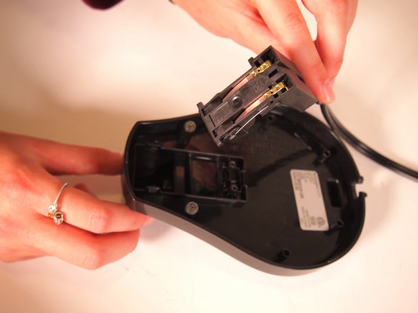

    • Looking at the bottom of the base, remove two 12 mm screws from the base with a Triangle #2 screwdriver.
    • You are now able to take the black plastic cover off and remove the cord.
