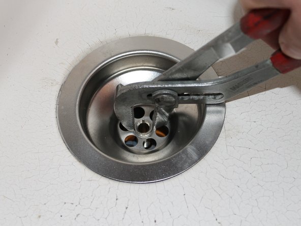

    • Loosen the nut of the basket strainer.
    • Use the pliers and turn counterclockwise to loosen the nut.

    • Align the upper strainer to the basket under the sink and tighten it with the nut supplied.
    • Use the pliers and turn clockwise to tighten the nut.
