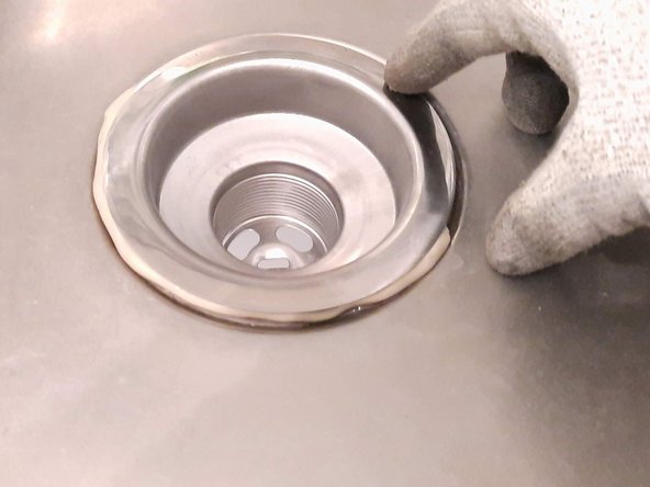

  8. Kitchen Sink Basket Strainer Assembly Replacement: crwdns2935265:08crwdnd2935265:01crwdnd2935265:03crwdne2935265:0 Kitchen Sink Basket Strainer Assembly Replacement: crwdns2935265:08crwdnd2935265:02crwdnd2935265:03crwdne2935265:0 Kitchen Sink Basket Strainer Assembly Replacement: crwdns2935265:08crwdnd2935265:03crwdnd2935265:03crwdne2935265:0
    • When placing the putty, follow the trace of the indent for the strainer outlined in the sink.
    • Slightly press down, but not completely so that the putty sticks. Prepare to place the new top strainer.

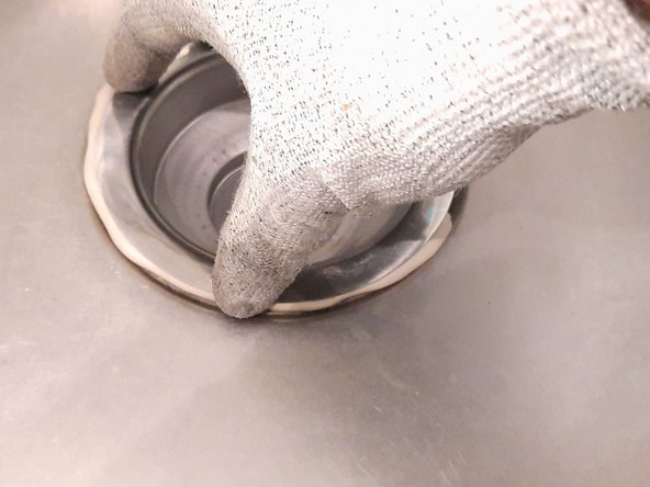

  9. Kitchen Sink Basket Strainer Assembly Replacement: crwdns2935265:09crwdnd2935265:01crwdnd2935265:03crwdne2935265:0 Kitchen Sink Basket Strainer Assembly Replacement: crwdns2935265:09crwdnd2935265:02crwdnd2935265:03crwdne2935265:0 Kitchen Sink Basket Strainer Assembly Replacement: crwdns2935265:09crwdnd2935265:03crwdnd2935265:03crwdne2935265:0
    • Place the new top strainer on to the grave of the putty.
    • Slightly press with your finger so that the putty sticks to the top strainer.
  10. Kitchen Sink Basket Strainer Assembly Replacement: crwdns2935265:010crwdnd2935265:01crwdnd2935265:03crwdne2935265:0 Kitchen Sink Basket Strainer Assembly Replacement: crwdns2935265:010crwdnd2935265:02crwdnd2935265:03crwdne2935265:0 Kitchen Sink Basket Strainer Assembly Replacement: crwdns2935265:010crwdnd2935265:03crwdnd2935265:03crwdne2935265:0
    • Press down the top strainer until the putty squeezes out from the sides.
    • Clean the excess putty with your hands and paper towels.

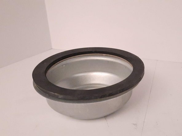

  11. Kitchen Sink Basket Strainer Assembly Replacement: crwdns2935265:011crwdnd2935265:01crwdnd2935265:03crwdne2935265:0 Kitchen Sink Basket Strainer Assembly Replacement: crwdns2935265:011crwdnd2935265:02crwdnd2935265:03crwdne2935265:0 Kitchen Sink Basket Strainer Assembly Replacement: crwdns2935265:011crwdnd2935265:03crwdnd2935265:03crwdne2935265:0
    • The placement of the washers on the bottom strainer is as follows from bottom to top: (1) paper gasket, (2) rough washer, (3) soft washer.
    • Place the washers and the new strainer in the order shown.
    • Place the strainer with the washers before putting the top lock nut.
