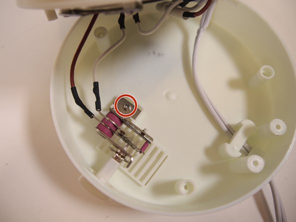

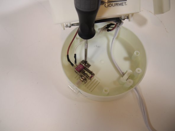

  10. Kitchen Gourmet WM-6105 Disassembly: crwdns2935265:010crwdnd2935265:01crwdnd2935265:02crwdne2935265:0 Kitchen Gourmet WM-6105 Disassembly: crwdns2935265:010crwdnd2935265:02crwdnd2935265:02crwdne2935265:0
    • Unscrew the single screw holding down the clamp that connects the thermal switch (black cylinder) and the white wire to the body of the hot pot.
  11. Kitchen Gourmet WM-6105 Disassembly: crwdns2935265:011crwdnd2935265:01crwdnd2935265:03crwdne2935265:0 Kitchen Gourmet WM-6105 Disassembly: crwdns2935265:011crwdnd2935265:02crwdnd2935265:03crwdne2935265:0 Kitchen Gourmet WM-6105 Disassembly: crwdns2935265:011crwdnd2935265:03crwdnd2935265:03crwdne2935265:0
    • Remove the clamp holding down the thermal switch and white wire.
    • There is thermal grease between the thermal switch and the metal base of the hot pot. Once the bracket comes off, and the switch comes unattached, you may need to reapply it if you plan to reattach the switch.
