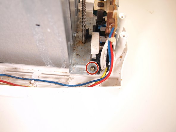

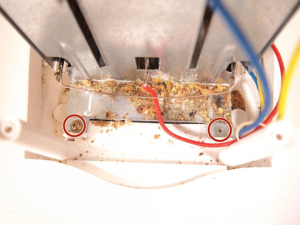

  5. Kitchen Gourmet 2-Slice Cool Touch W14A4694: crwdns2935265:05crwdnd2935265:01crwdnd2935265:03crwdne2935265:0 Kitchen Gourmet 2-Slice Cool Touch W14A4694: crwdns2935265:05crwdnd2935265:02crwdnd2935265:03crwdne2935265:0 Kitchen Gourmet 2-Slice Cool Touch W14A4694: crwdns2935265:05crwdnd2935265:03crwdnd2935265:03crwdne2935265:0
    • Remove the two 8 mm Philips #2 front screws and the two 12mm rear screws that attach the heating system to the base and lift straight up.
    • Watch for the wires that are zip-tied to the nearby post at the rear of the toaster.

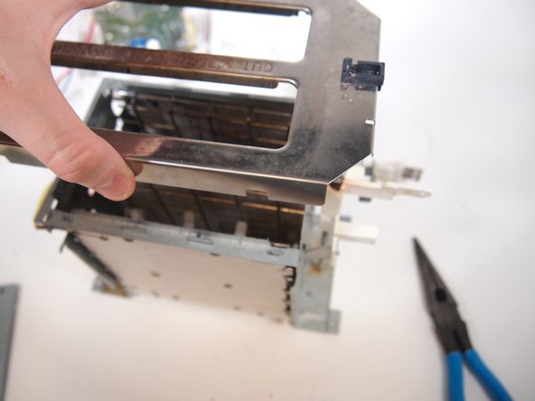

  7. Kitchen Gourmet 2-Slice Cool Touch W14A4694: crwdns2935265:07crwdnd2935265:01crwdnd2935265:02crwdne2935265:0 Kitchen Gourmet 2-Slice Cool Touch W14A4694: crwdns2935265:07crwdnd2935265:02crwdnd2935265:02crwdne2935265:0
    • Unfold the four metal tabs on each side of the heating system but don’t remove the panels yet.
    • Don't forget to unfold the four tabs on BOTH sides of the toaster.
  8. Kitchen Gourmet 2-Slice Cool Touch W14A4694: crwdns2935265:08crwdnd2935265:01crwdnd2935265:02crwdne2935265:0 Kitchen Gourmet 2-Slice Cool Touch W14A4694: crwdns2935265:08crwdnd2935265:02crwdnd2935265:02crwdne2935265:0
    • The panels will still be attached at the top, so pull the bottom out and unfold the two tabs shown below.
    • Once the panels come loose, remove them.
  9. Kitchen Gourmet 2-Slice Cool Touch W14A4694: crwdns2935265:09crwdnd2935265:01crwdnd2935265:02crwdne2935265:0 Kitchen Gourmet 2-Slice Cool Touch W14A4694: crwdns2935265:09crwdnd2935265:02crwdnd2935265:02crwdne2935265:0
    • Upon completing the previous two steps for each side of the toaster, the top should come loose as well. Remove this by pulling straight up.
  10. Kitchen Gourmet 2-Slice Cool Touch W14A4694: crwdns2935265:010crwdnd2935265:01crwdnd2935265:02crwdne2935265:0 Kitchen Gourmet 2-Slice Cool Touch W14A4694: crwdns2935265:010crwdnd2935265:02crwdnd2935265:02crwdne2935265:0
    • You now have access to the insides of the heating element. To remove the springs or grates that hold the food item, unfold the metal tabs.
    • To fully remove these pieces from the toaster, cut the three heating wires. To regain the function of the toaster after snipping the wires, reattach them back in place.
