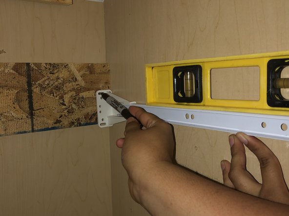

    • After the track has one screw drilled, use a level to make sure your track is straight.
    • Depending on your new mounts, you may or may not need to drill new holes for the screws. If you do need to drill new holes mark the holes on the mount with a pencil or marker.
  6. Kitchen Drawer Rear Mounts Replacement: crwdns2935265:06crwdnd2935265:01crwdnd2935265:01crwdne2935265:0
    • Drill the screws in either the existing holes or marked spots to hold the mount in place.
