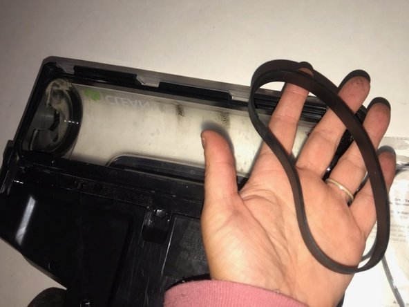

    • Place the vacuum at an angle most comfortable and easy to access with the bottom facing upwards.

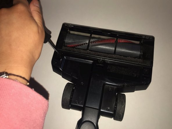

    • Remove the three screws holding the base plate to the body of the vacuum using a flat head screwdriver.
    • Place the plate to the side.

    • Insert your new belt and pop the roller back into place.
